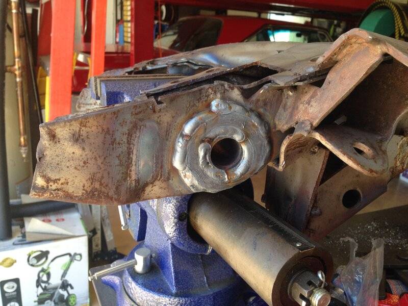

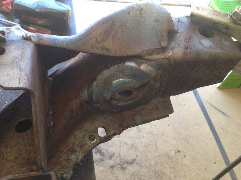

I had a few A body cars over the years that ovalled out the LCA hole in the K member. There are a few fixes...there is a tube that passes through the k member that has a perimeter weld at each end. Often times the weld breaks and the hole elongates. I have personally moved the tube back into position and then welded a large flat washer around it to ensure that it doesn’t happen again. I have pictures on my home computer that I can post later.
You can try what I did on the video I made Mopar torsion bar removal
And here are some shots of reinforcing around the sleeve in the k-frame.
