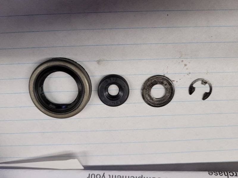

Google the part number. 8609 national is the seal number, they also used to sell a taller seal for worn shift levers.
I've used that tool, have one in my box.... But honestly, I would drop the pan & the valve body... Punch the seal out from the bottom, draw in the new seal with a bolt & washers through the center of the seal... While the VB is out you also have easy access to service the rear band anchor pin....
There are TWO seals, shift and throttle..
Suncoast also sells a washer that goes in the case to save the seal if the valve body is worn. Suncoast K0-71, shaft seal saver kit. He may not know these things, time to talk to him before he starts.
