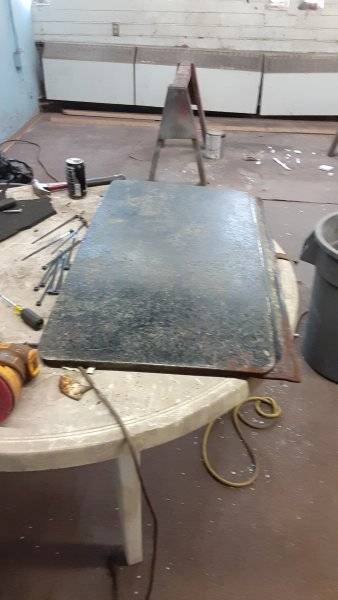

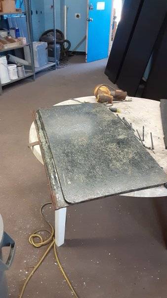

I stripped the vynal top material from the sunroof door, to reveal an absolutely pristine sunroof door. Both of the other 69/70 sunroof doors I have have a rot hole in them. One has a rust hole the size of a quarter, the other one has about a two inch by two inch diameter hole in it. This was caused by water getting under the vynal top and rusting the the sunroof door. This one is absolutely amazing! They only had one very light coat of matte black paint over the bare metal when they were installed by American Sunroof Corporation.

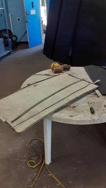

Both the door seal.and the weather strip had to be removed very carefully as they are made of unobtainium. The weather strip was in bad shape, all twisted and crushed. I was able to carefully straighten it out and it appears that it will be able to get reused.
The forward interior edge of the headliner was in perfect shape, but it was blue and the interior of my car is black,so I cleaned it up and painted it with some SEM interior black dye. I figured that it would be extremely difficult to rewrap it in the headliner material the way American Sunroof Corporation did,so a coat of black and it's a done deal.

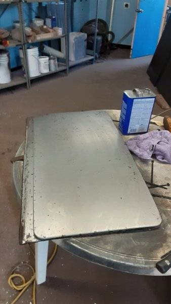

It appears that I was completely incorrect about the sunroof door panel having a coat of matte black paint on it when they were installed by American Sunroof Corporation. The black on the door panel is actually the glue for the vynal top material, it was sprayed on right over the bare metal door panel then the vynal top material was installed over it. After using some lacquer thinner to try to remove the glue, it revealed a perfect metal sunroof door panel. But knowing now that they were never painted with anything that would protect them from the elements, it is no wonder that the other two sunroof doors I have are rusted through.
It is nearly perfect. Supposedly the sunroof assembly was removed from a 69 b5 blue 383 Charger SE with a white vynal top and a blue interior in 1976 and has been stored inside of his barn ever since. The piece was an amazing find,from a conversation here on FBBO! I was putting off doing this project because the sunroof assembly that I had was from a car that spent 30 years out in a New England junkyard and was in pretty rough shape. I was planning to repair it and use it,but I was hoping that one in better condition would surface for sale. Fortunately this setup did.
