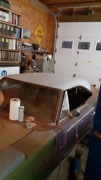

Guy who painted my 72 didn't like how the primer was on the roof of mine (previous owner primed it), removed primer, RUST: he had a heeluva time removing the rust: 1st thing I did was sand & "convert" the inside roof, "c" pillar was a mess with rust, TRIED hand sanding, not much room, then used TONS of rust converter; primed it all then painted it. Came out pretty damn good imo. I KNOW YOUR PAIN PETE!!

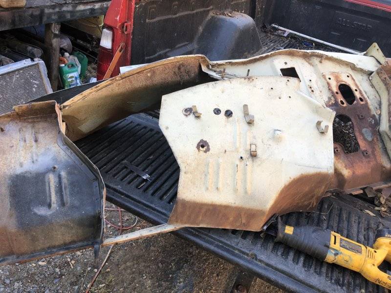

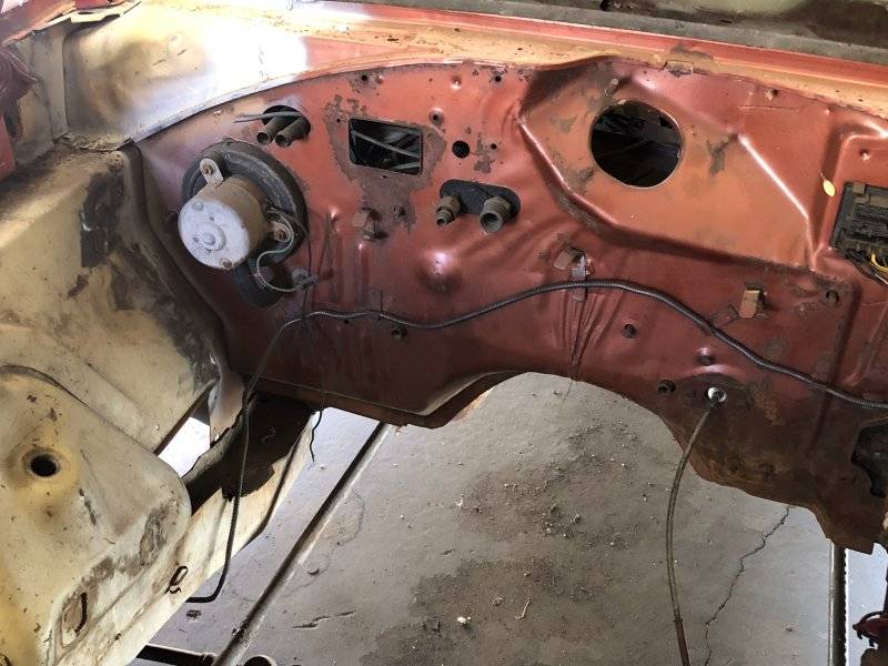

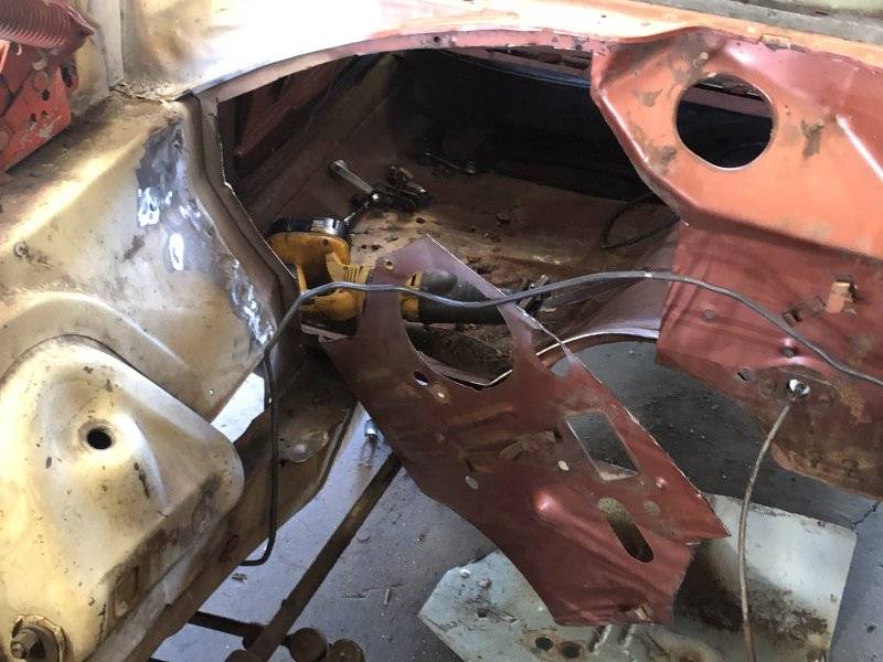

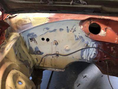

I did this in my Jigsaw Charger.I got the hood off the car an I am getting ready to venture into the engine compartment and firewall graft to convert the engine bay to a non air conditioned car. I have a complete firewall section from a 4 speed air grabber hood car, as noted by the hole for the vacuum lines above the heater core holes. I am only going to section in the right side from the middle over. No need to change the whole thing when the one in the car has no rust.
That is the exact plan KD!I did this in my Jigsaw Charger.
