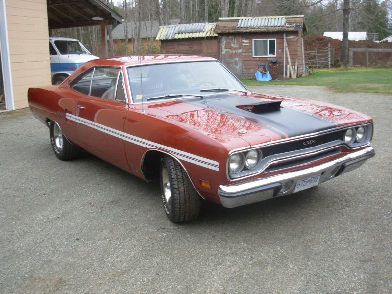

I'd like to improve the handling on my '70 GTX, 440 4bbl, 727, 8 3/4 3.55 rear axle, stock rear springs. Nothing too drastic. This is strictly a street car, but I like to to some "spirited driving" from time to time, so some decent handling would be nice.
I'm thinking of a firm feel stage II power steering box, stiffeng plates on the lower control arms, and new .960 torsion bars. Any worn parts will be replaced and all new bushings etc. So for the suspension Gurus out there, any other suggestions for me? Bigger sway bar? Shocks? This is a numbers car so i want to maintain a stock appearance. Thanks in advance guys. DSCN3636.jpg

So the work has begun and laying on cold concrete for a couple of days makes me long for a hoist. I need to win the lottery so bad. The front end has been torn down and the parts are ordered. I already installed MP bolt on sub frame connectors, and road tested the car and the difference was amazing. I plan to have them welded in when the car goes in for alignment and is on the 4 post Got over $550.00 in parts coming from our friends at PST. Poly strut rod bushings and end links, new lower control arm shafts, ball joints upper and lower, 11/16" inner and outer tie rod ends and solid sleeves. I'm going with rubber lower control arm bushings and rubber offset upper control arm bushings. Having my LCA stiffened with PST's stiffening plates. Also new upper and lower bump stops. Think that's it for now. New torsion bars after Christmas. I'm planning on .960 torsion bars unless any one has a better idea. Time for a rum and coke, cheers.
Well she's done.
Firm feel stage II power steering box stock pitman and idler arms
New upper and lower ball joints from PST
New 11/16' inner and outer tie rod ends with solid sleeves from PST
LCAs stiffened by PST and my welder
New HD steel strut rods from Mancini Racing
MP .960 torsion bars from Summit Racing
All bushings replaced with moog rubber, including offsets in upper arms, LCA, strut rod, sway bar and end links
MP sub frame connectors
.75* neg. camber, 3.5* pos. caster, 1/8" toe in
What a difference. The ride is tight and stiff up front, less sway all around, car goes around corners like it's on rails. Really nice at highway speeds. The firm feel box is the biggest plus.
I'm not a mechanic, just a car guy who wanted to do this myself. I did with help from this forum, Mancini Racing's suspension tools, Firm Feel, PST, CBSA and some pain from lying on concrete all winter in Canada. Time to drive. see ya.
