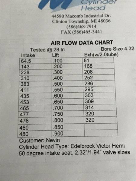

Great port work there. Did Bob tell you what the port volume was on the intake? I didn’t want to increase the port size any as that just moves peak numbers up in the rpm range.Pretty good!!
For comparison my modern ported Vic jr’s
I think these were a 1020 bench also. I know those are usually softer numbers compared to a 600.
