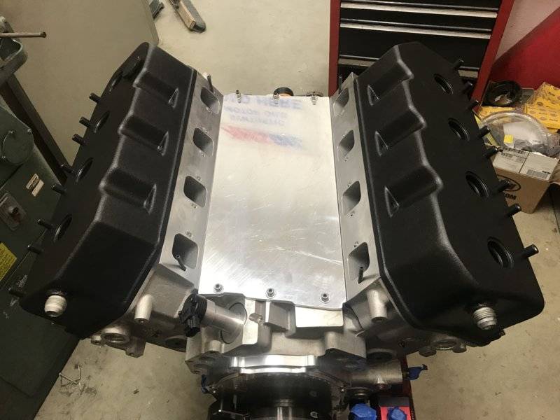

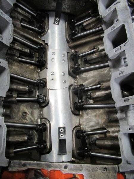

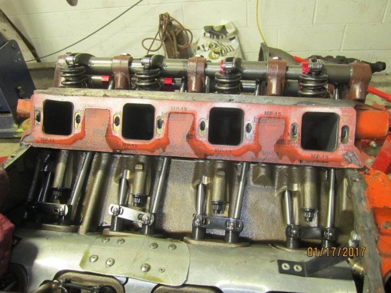

It's good to keep the hot oil off the bottom of the intake:thumbsup:

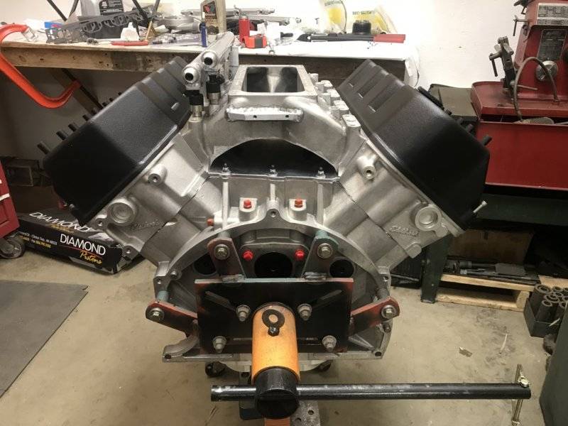

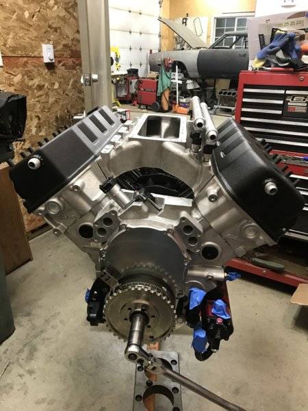

That engine is disgusting, best to let me take that off your hands once your finished with building it.
Looking like a BEAST!!!

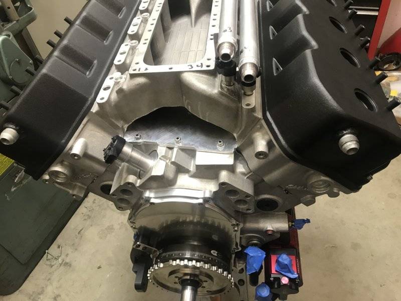

Will the intake have a nice air gap??
Yes, it’ll have a flat valley cover that’s .250” thick and a big air gap underneath. I’ll run the throttle body wiring underneath.

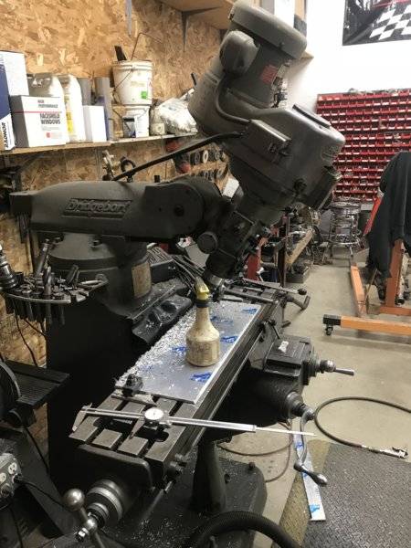

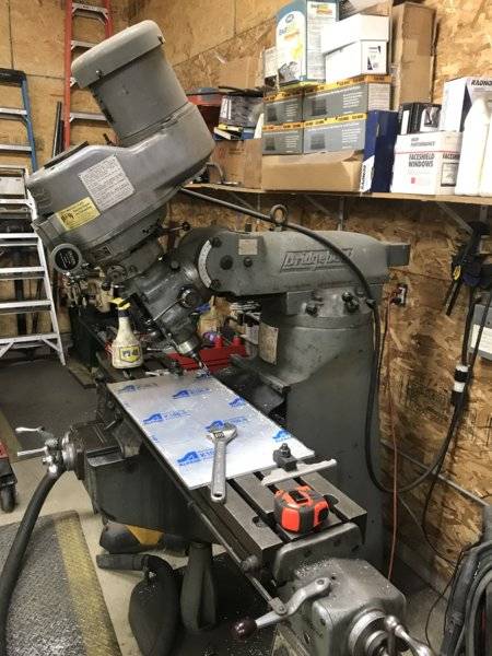

Moving the head to 45 degrees isn't as big a pain as getting it back to zero !
So true! And it was trammed in perfectly. I used 32 degrees for this plate as it seals against the intake face which has a -13 degree angle on a hemi.
