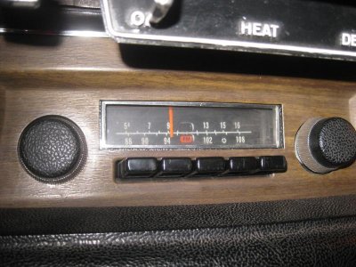

This is the one in my 70 GTX, I noticed the one pictured above reads "Chrysler solid state" and mine just has a Pentastar.
Anyone know why? it's the radio that was in the car when I bought it in 1979

The radio you show is a Valiant/Dart,71 and up,it bolts right in,those are also Valiant/Dart knobs. This one is on Ebay.

Thanks, you learn something new every day, Kinda bummed out now though.
Makes you wonder when and why the switch took place.
After seeing the cost of a correct one I think this will stay put for now, it works fine.
