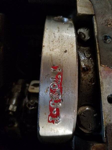

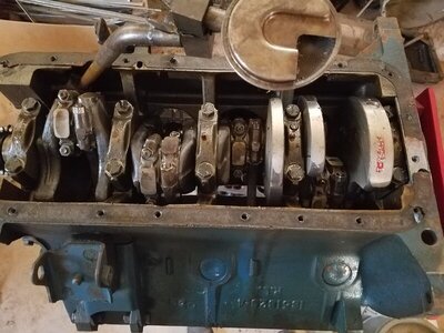

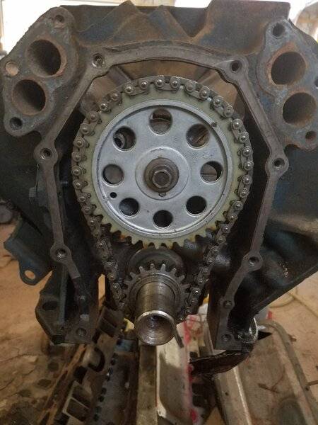

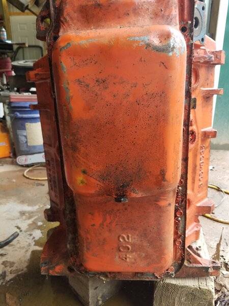

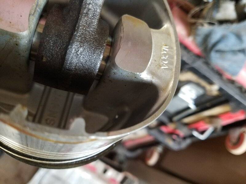

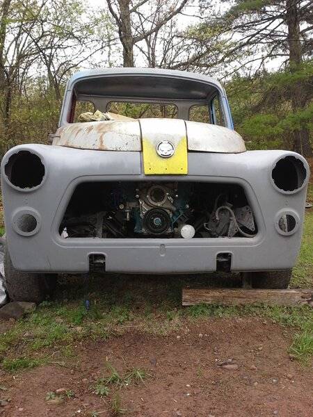

Ok the 413 I was going to put in my 55 d 100 after tearing it down looks like a little to wild for the truck, but since the RR is tubbed and stiffened I thought put it in it.The sump has been extended and the oil pan deepened 3 "the heads have been ported, don't know if I should use them they're 509 casting, I have a set of 906.Crank had a number on rear throw and connecting rod bearings .10 cut of crank.Pistons are Alcoa stamped on edge and inside stamping Jahns?
20150501_165531.jpg 20200430_141314.jpg 20200430_141324.jpg 20200430_141251.jpg 20200430_163855.jpg

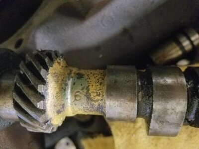

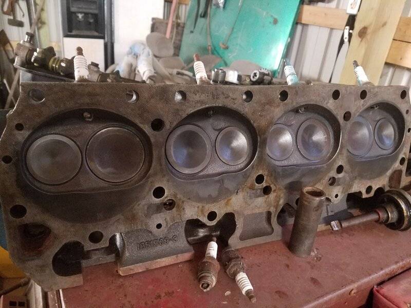

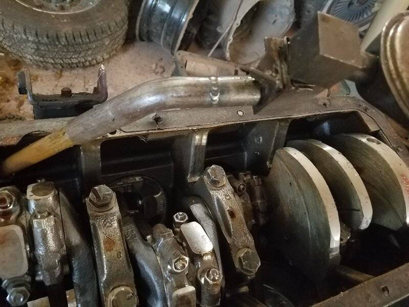

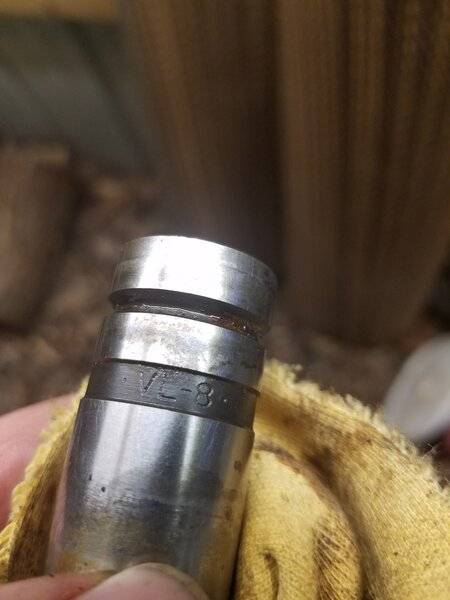

As you can see adjustable rockers and porting on the 413. will that be of much benefit if I use my edelbrock 6bbl. Intake because I'm not going to port it out and the lifters are hydraulic. Would it be better to use my 906 heads? The cam in the 413 just has a 29 casting have no idea what grind it is. The timing gear gotta go mopar plastic. The engine was packed with grease doesn't show wear maybe run a pass or two bearings, lifters, I can still see honing marks in cylinders.Lifter has vl-8 on it. I'm going to give you low down on 440 looking for input on which one would be the right fit for this car .Thanks

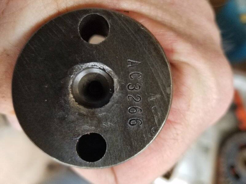

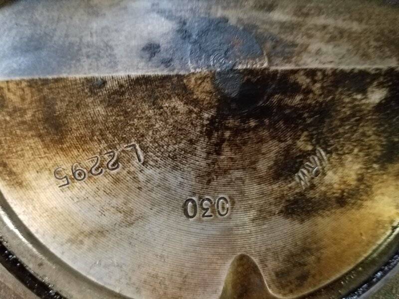

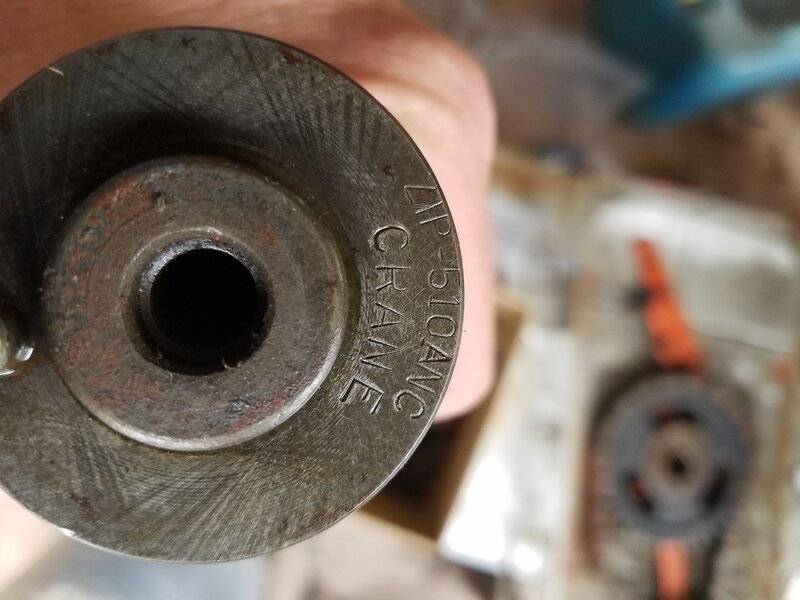

Ok here's the D 440 hp block bore .30 trw pistons, needs more work and money to get it back together no lifters, lifter bores need cleaning up, had a crane cam zip-510-anc on one end on the other end ac3266 anyone run one of these cans good grind ,how did it idle ?Pistons trw L2295. .30 over with 906 heads wonder what comp. Ratio?

Do the 440 and use the better heads, wedge guys will which heads are best. Compression 10 to 1 a hair more?
The TRW 2295 pistons are listed ~10.3 compression with an 88cc head. Granted a lot of other factors (head gasket thickness, actual head cc, etc) dictate actual compression but that's a good baseline.
Crane cam ZIP-510A-C --- 254 / 254, 112* LSA, .510" gross lift.
Not sure if that's the same as your ZIP-510-ANC or not

The 509s are heavily ported and have the adjustable rockers if you scroll back you can see the ports but I'm using unported 6bbl intake
Ok so do you know what kinda idle it would be most of my experience is factory cams

I lied the 413 according to motors manual stock bore is 4.1875x3.75 stroke ,the bore measured 4.230 what cubic in. Would that make it
Wow, great score, those parts are gonna come in handy!! Is the cage staying in the car?
Sorry didn't see your last question just the back half of the cage the rest had to go not flexible enough for that

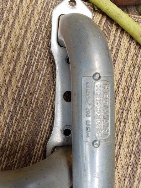

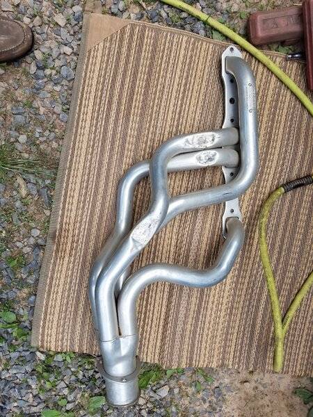

Ok thanks for your input for my 70rr I'm going with the 440 it's bored. 030 has trw 2295 pistons I'll use the 906 heads maybe bigger valves after I have them checked. I talked to Dave at Hughes ordered hot street cam#seh 2832bl-10 lift 530-536 110deg. Sep.1106 springs 5003 lifters & timing chain about $520 to me. 6bbl edelbrock, hedman headers, just hanging around, found them locally $150 2 yrs ago ,1 3/4 tubes .Hope they fit!
