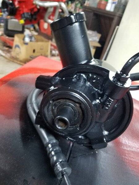

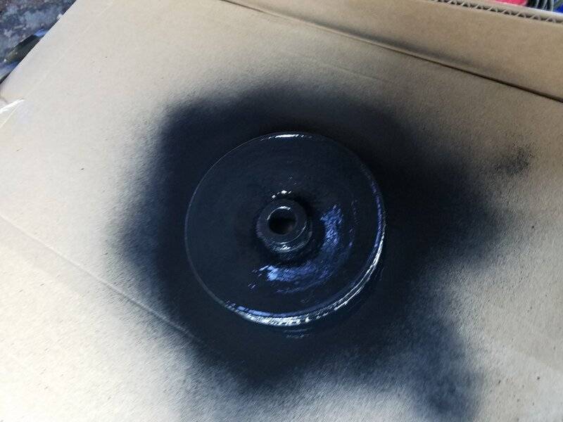

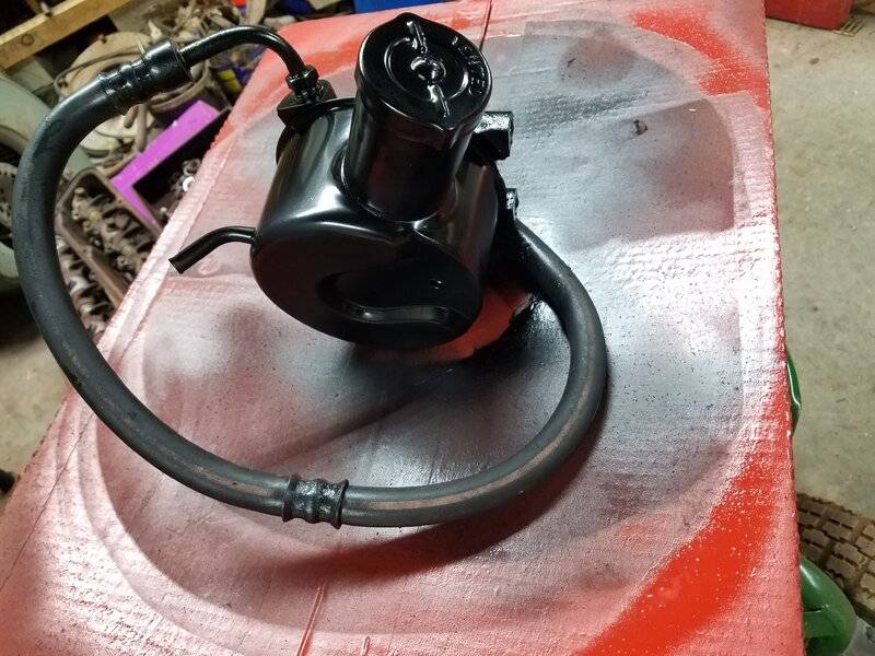

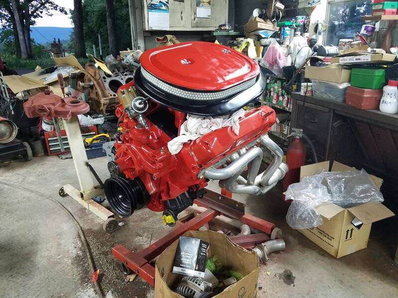

finally tore into my carbs rebuilding them ,sanded down power steering pump and removed the pulley and painted it. installed the carbs and air cleaner just can't get the lid paint to come out even .The pump is a trw pump I think it is for older models but doesn't bother me it fits .

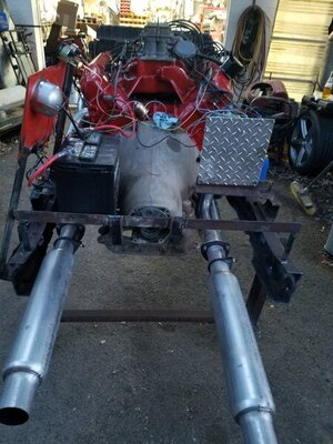

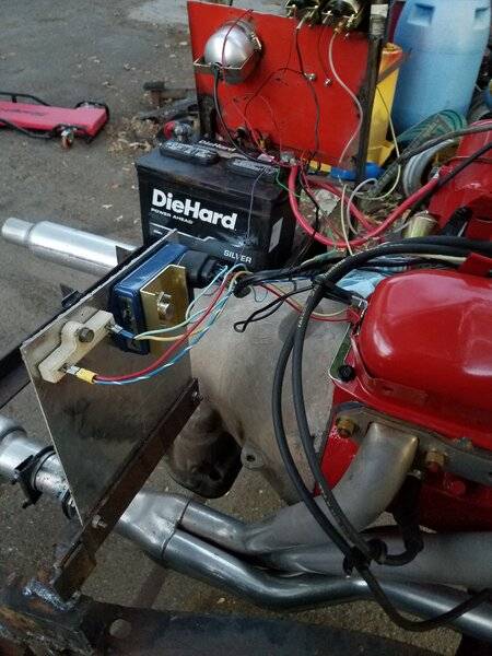

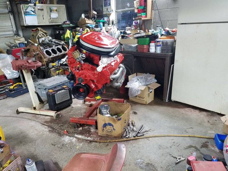

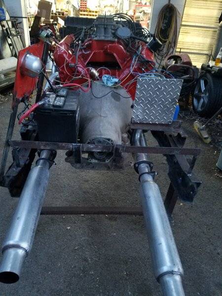

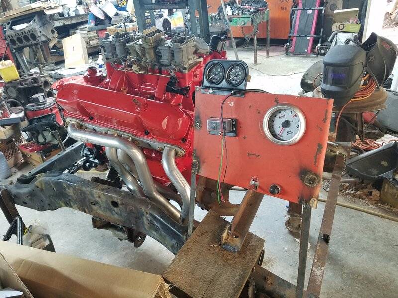

I started up my 440-6 and broke it in,but I had to remove the cast iron bell housing because it was to wide and starter wouldn't engage, so I took a 727 with out a tail shaft or any guts and left the flywheel on engine and reworked the rear brackets on my run stand working great! Some reason I can't get video to play, I will try it live tomorrow

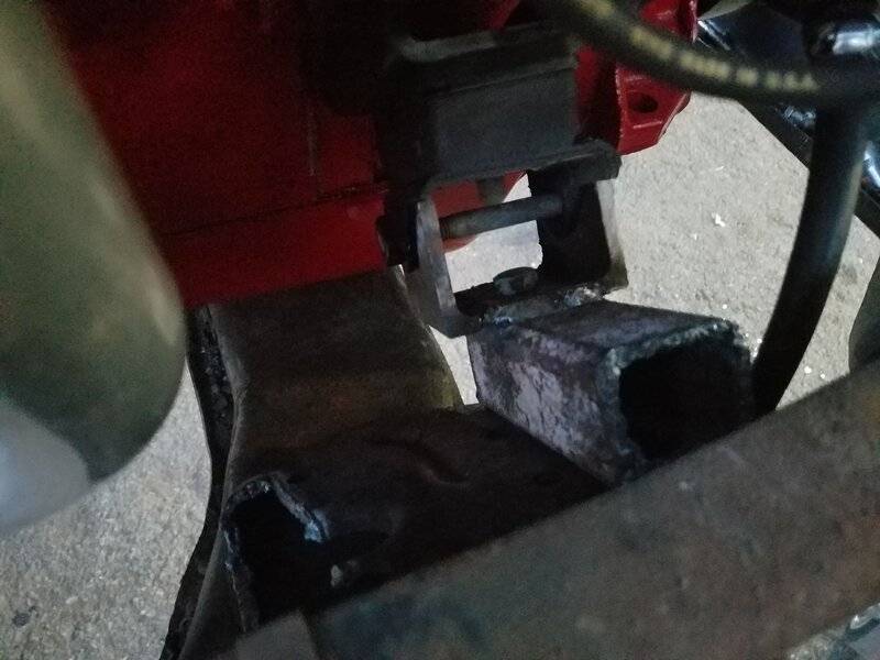

since I can't get a video to load, here's some pictures of my test stand using a gutted 727 with a manual flywheel and tail shaft removed . I used a piece of square tube and a piece of angle to get the car pan to clear k member, but if you can get a set of truck mounts you won't need to build it up as much

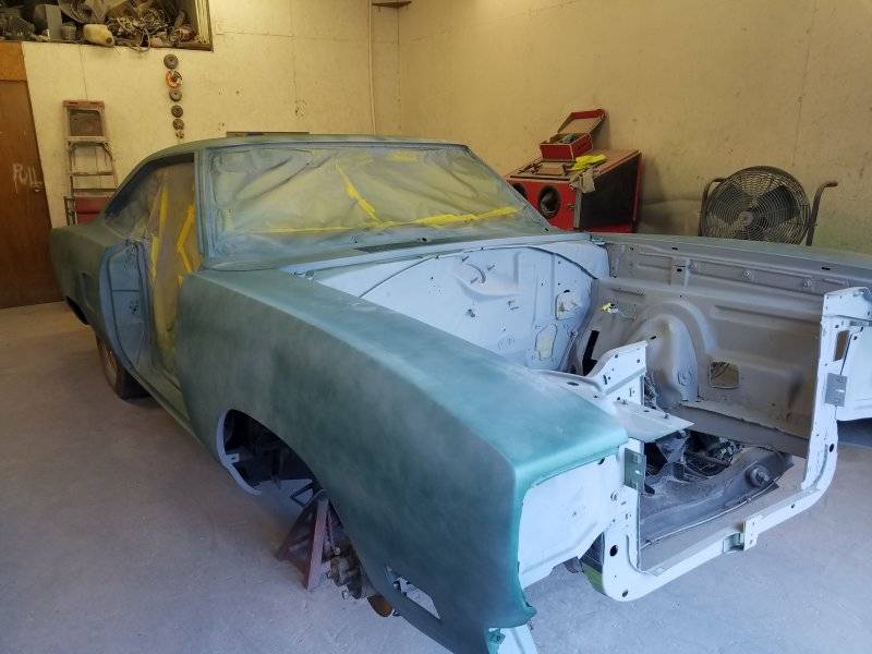

finally got to see my car since the painter got it almost 3 years ago , gave him an ultimatum and said I was going to come and take the car and he has until June 30 to have it painted, it worked and I finally got to see the car and he had me bring some of the parts to get painted. hopefully he meets the deadline and I can assemble it.

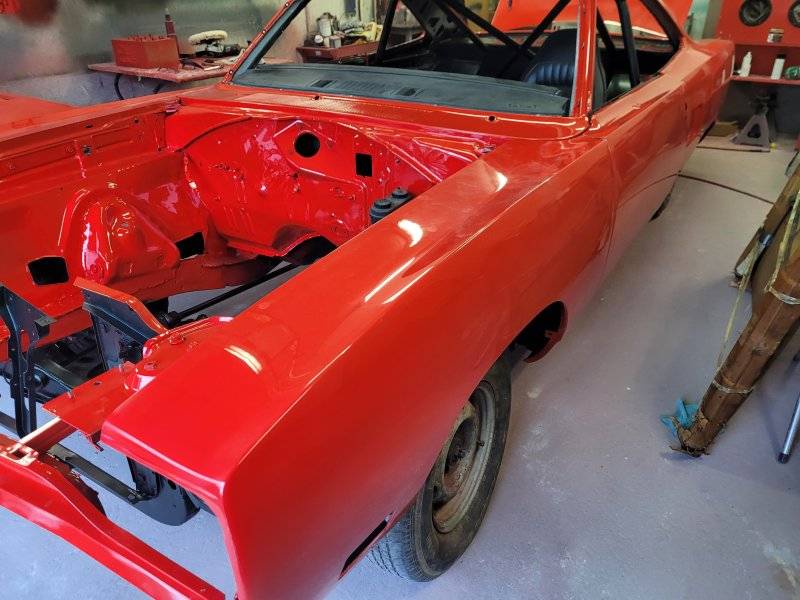

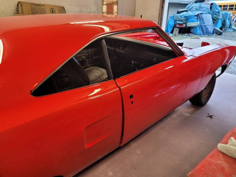

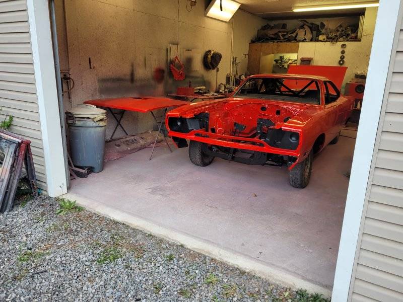

Painted! Hood stripe and side scoops which he forgot and final sanding and buff,supposed to be able to pick up end of the week! IT looks orange pictures but it is red in person, which is what I wanted, a little deeper red would have been better but finally out of paint jail. 3 1/2 years. Reassemble and drive.
Congratulations on your parole from paint jail!
It's obvious to anyone who has known me or read my posts that yellow and black are my favorite color combos, but I'll NEVER forget the time, before I had my Lemon Twist and Black 70 Roadrunner, I spotted a RED and Black 70 GTX, and I was beyond words stunned!! By RED, I mean real red, NO orange at all, no maroon, just REAL RED.
I believe the designation is E5 Rally RED.
IF I were to ever choose a red paint job, that would be my biggest concern: it may come out too bright or dark, when E5 is the goal.
Once you get your car dressed out, that may help "tone down" the perceived brightness, but I think it's going to look GREAT!
