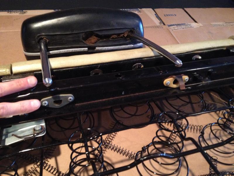

OK,,,Lil dilemma here. I have a set of new headrests for my bench seat roadrunner. Both have unequal length rods......This is right. BUT Both have a long rod on the right side looking from the rear and a short one on the left, From everything I have looked at. I have 2 right side headrests. The pass side fits well and goes all the way down. When I insert it into the drivers side it wont, It sits 1 1/2 off of the seat.....Any info appreciated .

The picture below is from my 1970 Road Runner with a bench seat (and the headrest is NOT a correct 1970 headrest). It shows the way that the headrest hardware is positioned within the seat. This requires the 1970 headrests to have one of the rods to be a semi circle. As you can see on the picture, that guide is only on one side. A standard headrest like the one pictured, or one that is mirror image from the way it should be, won't get past this point at all.
I am almost positive that the headrest hardware in my seat backs was configured so that the headrests are not side specific. Unfortunately, I don't have a picture of both sides to 100% verify. I would guess there is something else keeping your one headrest from going all the way down...
I hope this helps.
Hawk

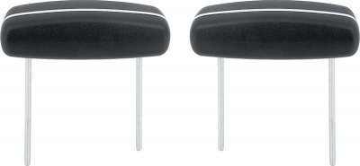

I have a pair of repop headrests from Classic Industries, description below (tried to copy images, but couldn't). It would appear that the right and left are mirror images of each other.
1968-70 MOPAR A & B-BODY WITH BENCH SEAT BLACK MOLDED HEADREST SET
MD2015100 - 1968-70 MOPAR A & B-BODY WITH BENCH SEAT BLACK MOLDED HEADREST SET
Sold as a pair for models with a bench seat.

I ordered and recieved the Classic industries MD2015100 head rest, just opened the box and they are not equal length, so I can confirm the 2 different lengths are correct.

Are the two exactly the same or are the long rods on the left side on one and right side on other ?
