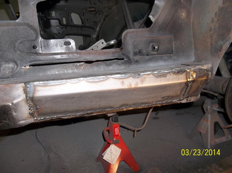

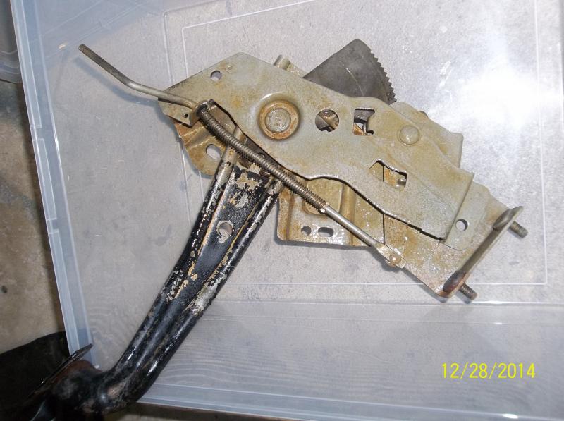

Here is another one to cross off the list...
Great job dog, looks pretty solid now.

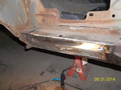

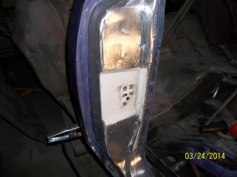

Started fixing this door jamb last night, and finish welding tonight..... wouldn't you know it.... ran out of MIG wire....lol
That is some good work Dawg! That is always fun, get started and then run out of wire... or gas! :) You'll get it!

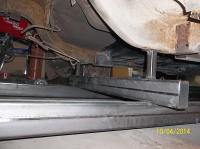

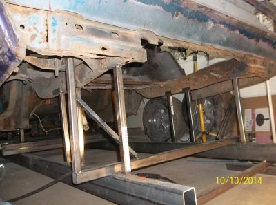

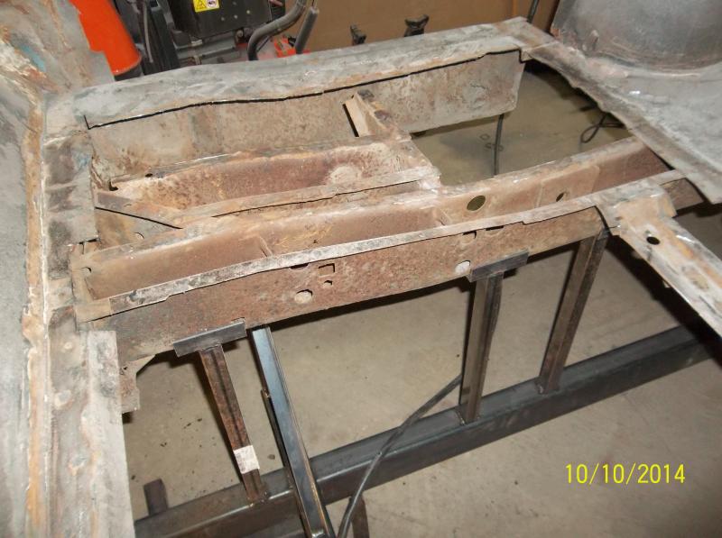

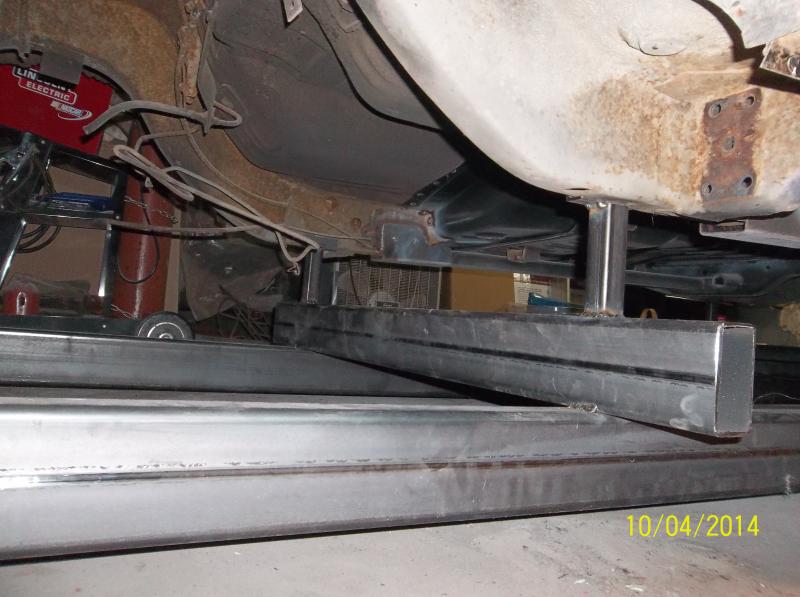

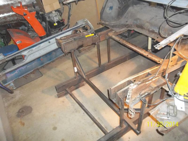

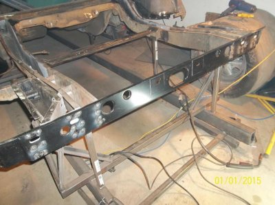

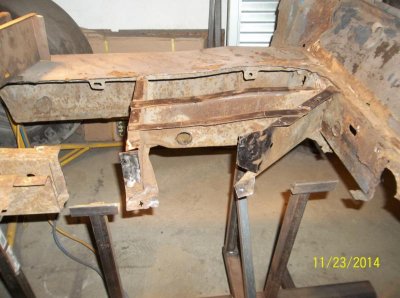

Wow. Significant work and progress on the rear - it looks great and I also give a big thumbs up on the frame table!
I bet if feels great to turn the corner and start welding on fresh new metal!

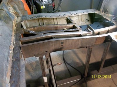

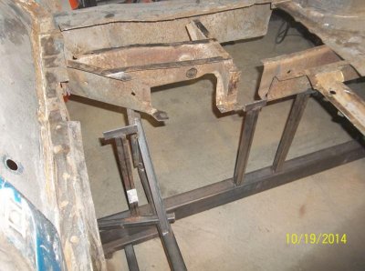

Thanks for the kind words, guys. The frame jig took a little while of head scratching to come up with... I just wanted something that I could level the car on and support for panel replacement. Oh, and frame rail replacement once I found rust holes in them ....:angryfire: Have I said I hate rust? lol

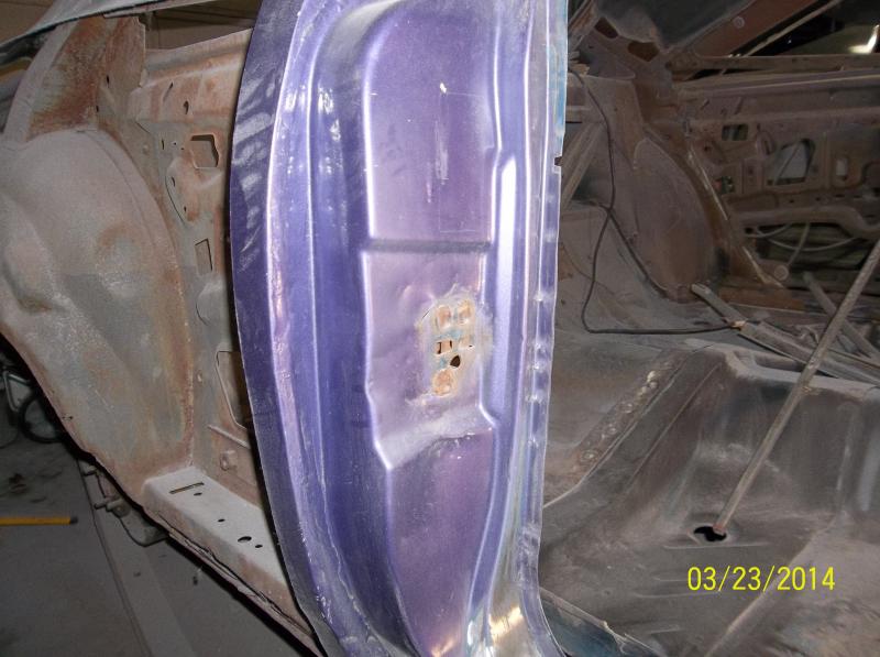

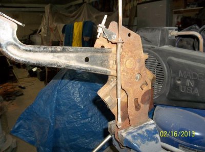

100_0418.jpg100_0710.jpgThis is what soaking in a Molasses/water mixture for about a month will do to rust.... it worked pretty good...

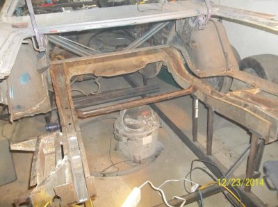

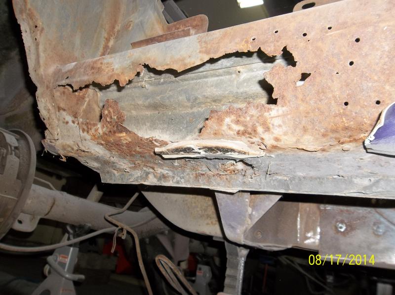

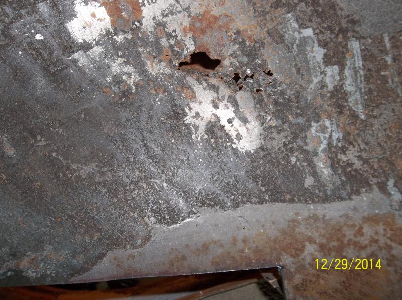

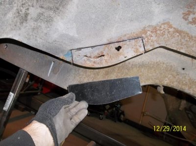

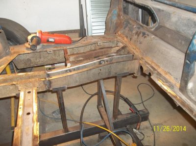

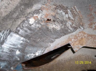

100_0713.jpg100_0714.jpg100_0715.jpg Yippee!!! More rust holes!!:BangHead: lol

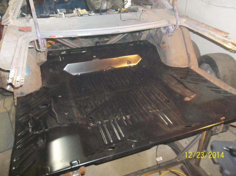

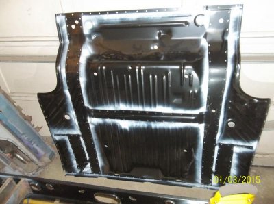

100_0718.jpg Rear crossmember is welded on

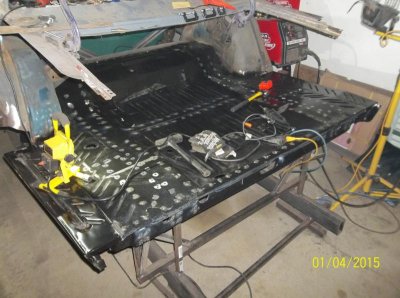

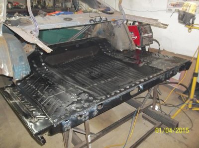

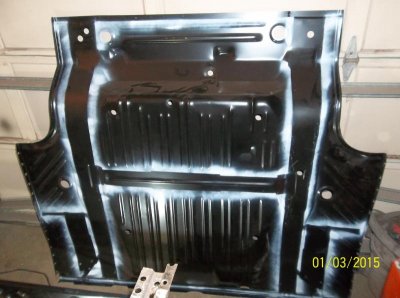

100_0719.jpg100_0720.jpg Trunk pan marked, and 230 holes drilled for spot welds..... guess what I'm doing tomorrow? lol
I can't remember where I saw that, but it works pretty good for marking!

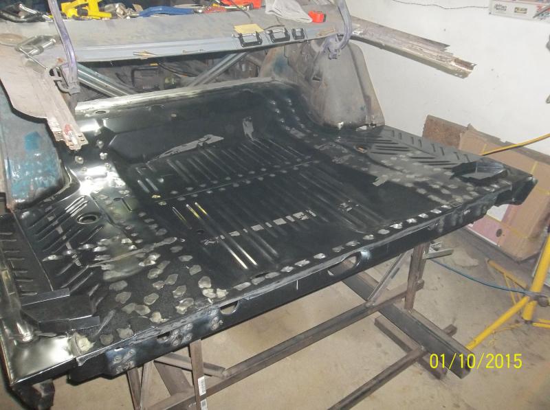

100_0721.jpg100_0722.jpgFinal fitting and welding in.... ran out of wire halfway through... seems I have done that before,lol...
Now that's some serious progress from my last visit which wasn't that long ago. Your doing one hell of a job on that Bird and your work is looking very professional as well, congrats on the serious *** hauling! Love the jig too
Thanks 747mopar. It took a while to figure out how to jig it so I could remove/replace the frame rail pieces without moving the jig. It seems like all the little things that you have to mess around with don't show much progress, and then you get to a point where you put a few parts on and BAM... well look at that... that looks much better!:D
Very nice. What size hole did you drill for the plug weld?
Did you have to do much work to get the quarter paned extensions to fit tight to the trunk pan? Mine are a mess with big gaps.
