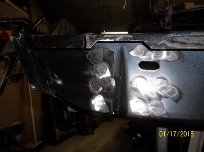

Thanks, Hemirunner. I drilled 5/16" holes for the plug welds. I did have to do a bit of work to get the trunk extensions to fit. The AMD panels didn't have a 90 degree bend in them, so I hammer and dollied them to 90 degrees, and then clamped the crap out of them.... they co-operated at that point, lol

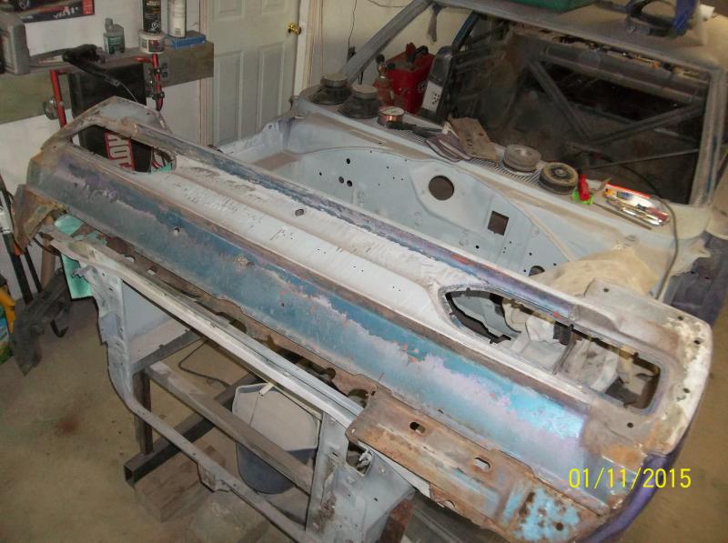

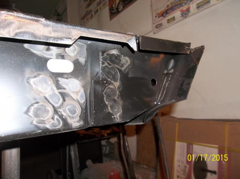

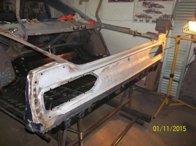

100_0724.jpg100_0725.jpgTrimmed the old crap off the tail panel and did a test fit..... it fell right back in to the exact spot...sweet!
Looking good. I don't know which is worse, cleaning up an old part or stripping the ecoat off the AMD panels!
I think I would rather strip the ecoat off the AMD panels, lol

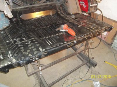

100_0726.jpg100_0727.jpg100_0728.jpgPlug welds ground smooth and crossmember extensions welded in :)
Buddy that looks terrific!!! I will be welding in my shock tower here soon and then i have to do the same as this and it's always cool to get a look from a fellow Mopar guy doing the same! Everything looks real good, even that welder that looks familiar :)

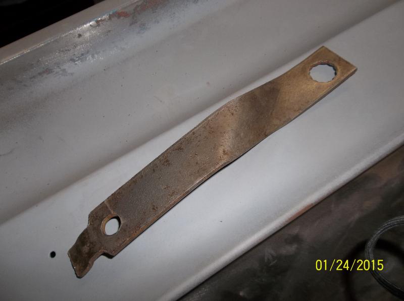

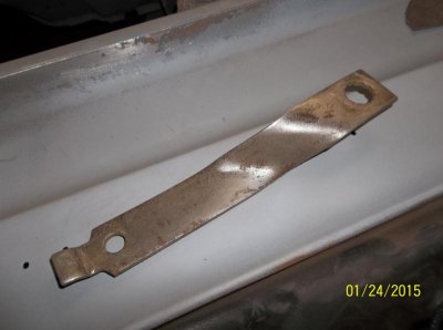

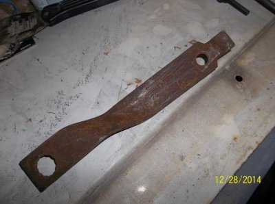

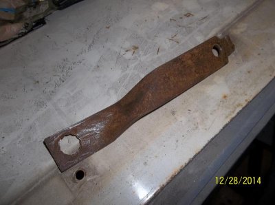

100_0711.jpg100_0712.jpg Before
100_0733.jpg100_0734.jpg After soaking in molasses

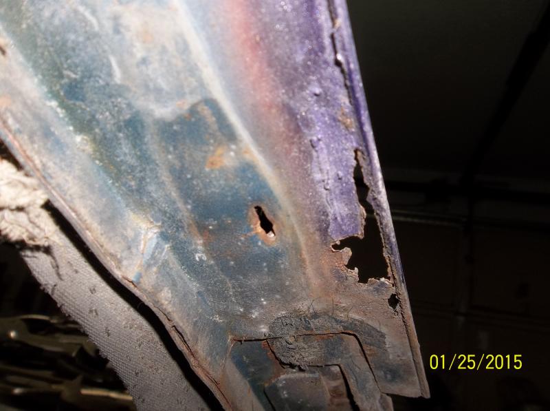

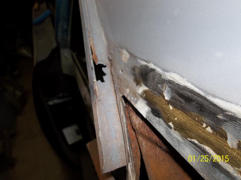

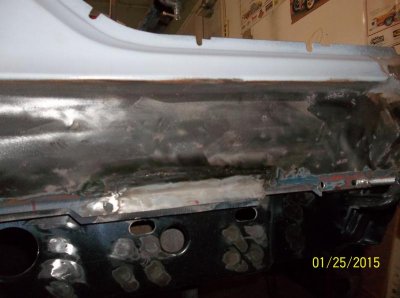

100_0737.jpg100_0740.jpg100_0741.jpg A small patch in the tail panel , and I'm not sure how I'm going to fix this other rust hole....:cussing:
