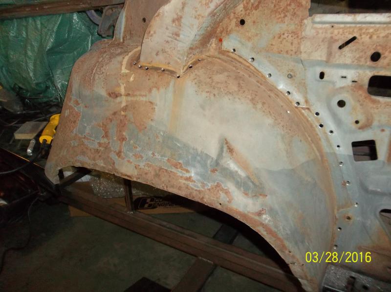

Thanks RM23U0A. It is going to get interesting, dad was diagnosed with Vascular Dementia about 6 months ago, but I have a bad feeling that it is Alzheimers. I have pretty much moved everything to the new place, so now the work can resume. I will update with the hood shenanigans when I work on it ( I was never taught to not work on a hood..... must've played hooky that day. hahahaha) right now I'm starting work on the rear outer wheelhouse R&R... 100_0835.jpg

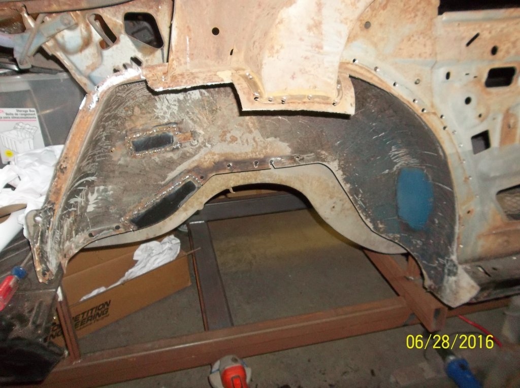

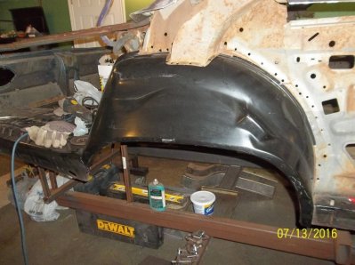

working at removing/replacing outer wheelhouse...

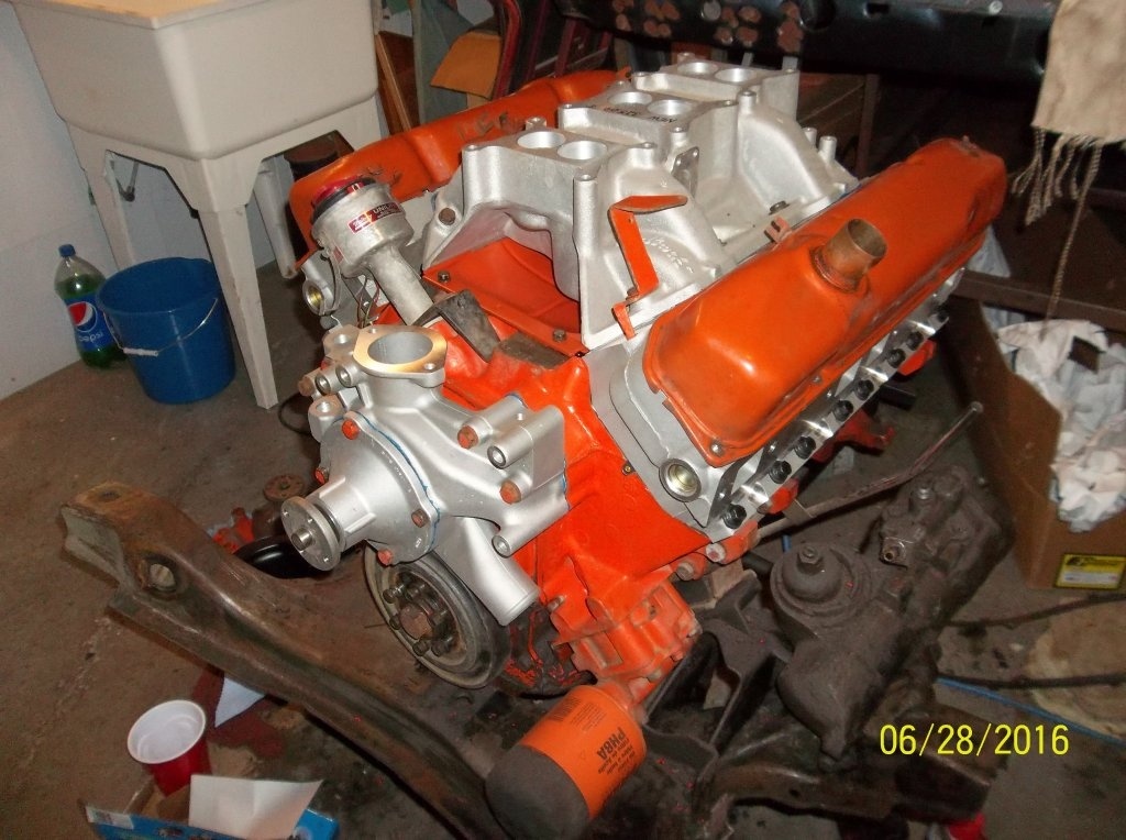

Did a once over on the motor... I think it has very little run time on it. No ridge in the cylinders, bearings look almost new, lifters and cam look brand new. Found a set of 440 source heads locally that were never used, so I picked them up. Just buttoning it back up.

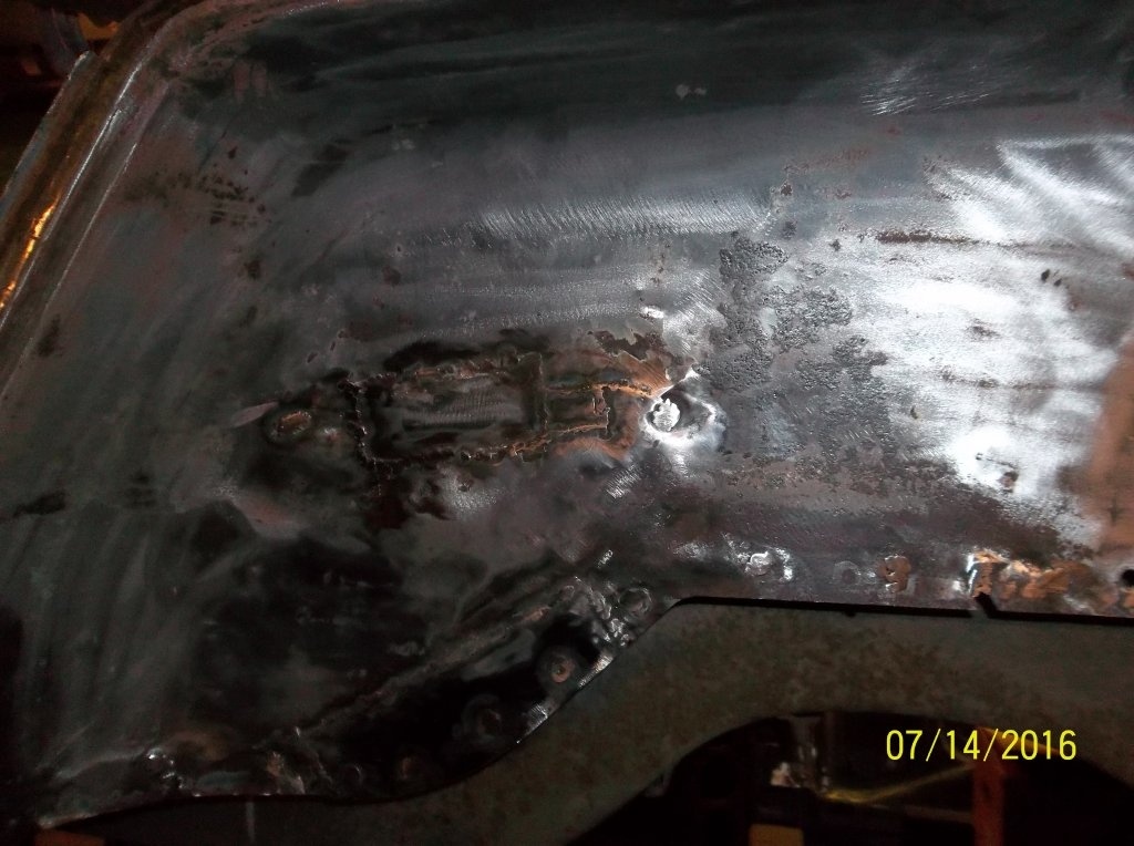

So I ran into a bit of a head scratcher. It appears that the wheelhouse halves weren't spot welded together, but rather a continuous fuse weld. Any ideas how to get it apart? I think I may need a plan B that I don't have right now, lol.
