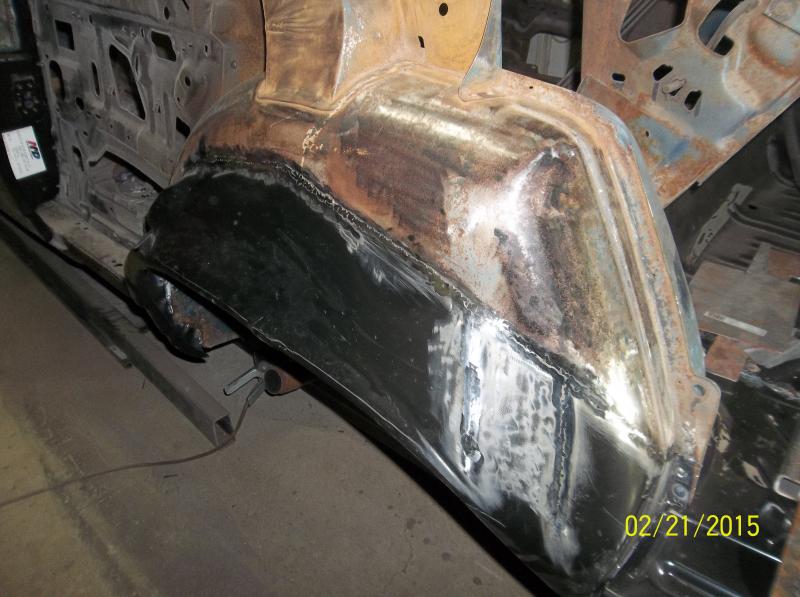

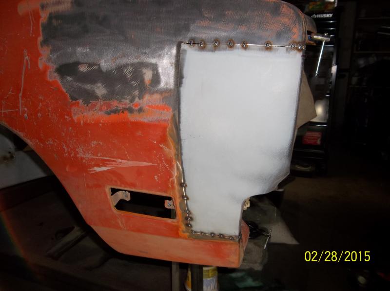

100_0772.jpgSo after a few hours of hundreds of tack welds, this is on the "done" list :)

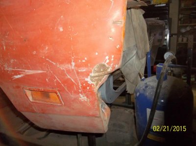

100_0770.jpg100_0771.jpg Thought I would change things up a bit and take a break from the rear end. Just need to take a few patches from the old fender and graft them onto this one, and it will be mint!
That looks really good Dawg. It is nice to change things up. Working on the fenders will be good. My son and I just sectioned a front on to his Barracuda passenger fender. Turned out good. Thank goodness the driver's is good though!
Man Dawg you are making some real head way on this old bird, I look forward to seeing your grafts, I think you will be having some fun in the sun with this soon, Great work...

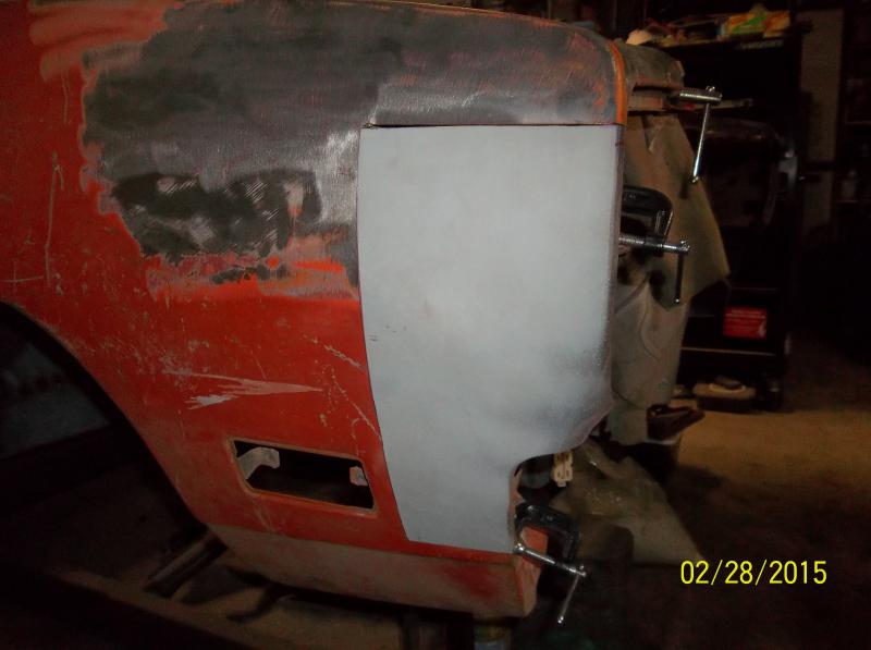

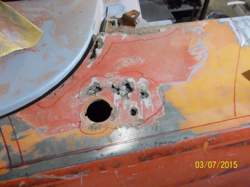

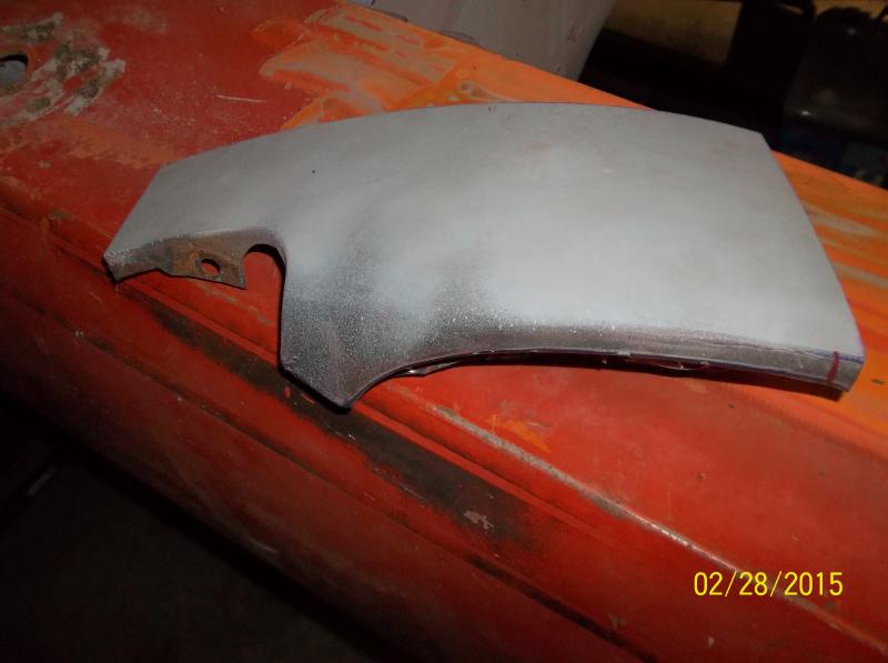

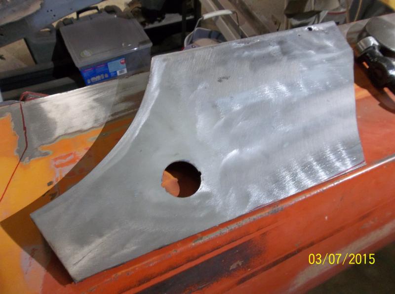

100_0776.jpg100_0778.jpgCut this piece out for the patch to go in....

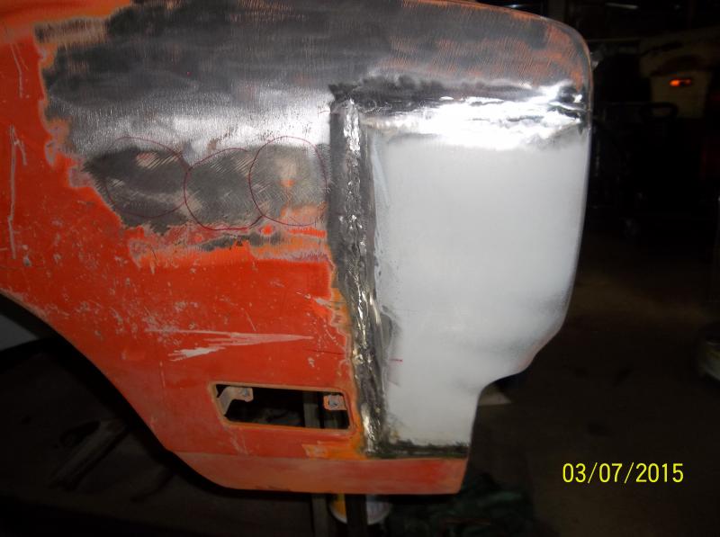

100_0775.jpg100_0779.jpgAnd now for lots of tack welds....
Man that's some good work you are doing, Im going to hire you when i run into some problems, you seem to have a good handle on this stuff!!! Looking REAL good there TD!
Thanks Ron! I don't know about hiring me though.... I may be a LITTLE too far away...lol!

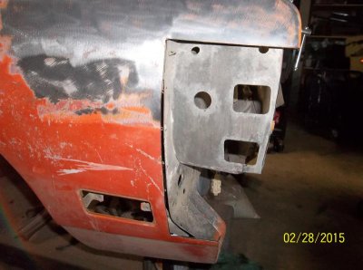

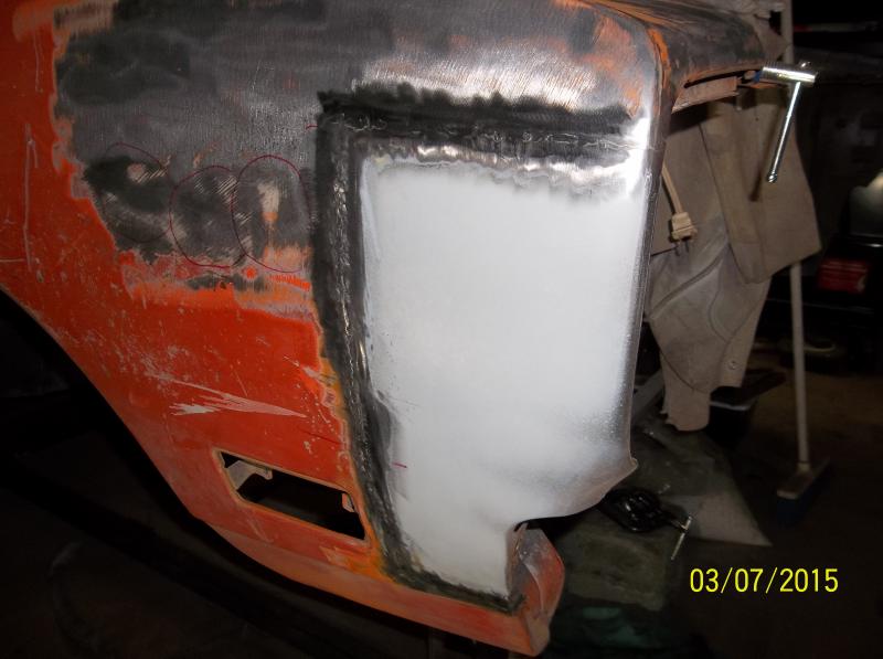

100_0788.jpg100_0789.jpg Welding done... Yay!!! On to the next...

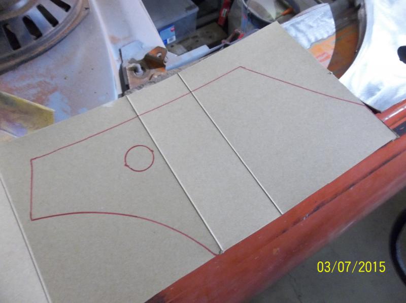

100_0790.jpg100_0791.jpg100_0792.jpgThe fender, the patch and the cardboard template, getting ready for cutting, tacking and grinding :)

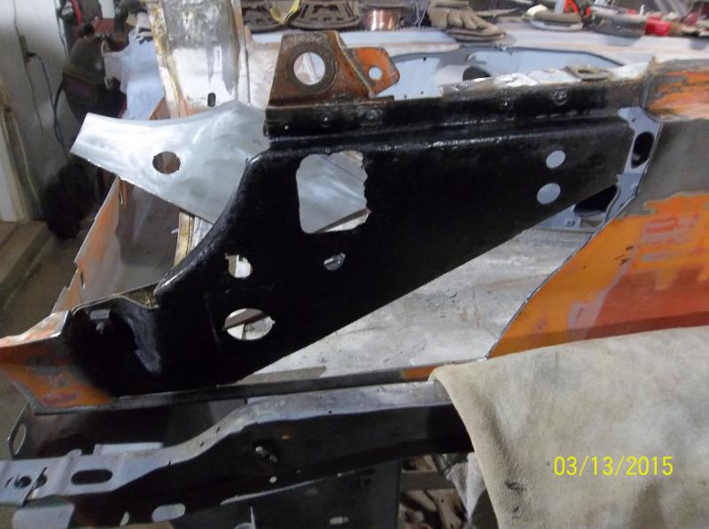

100_0793.jpg Cleaned and coated under the patch area to ( hopefully ) stop the rust....

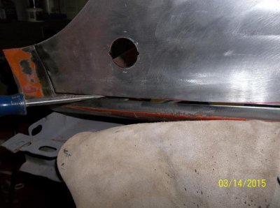

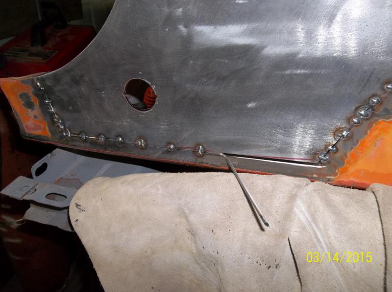

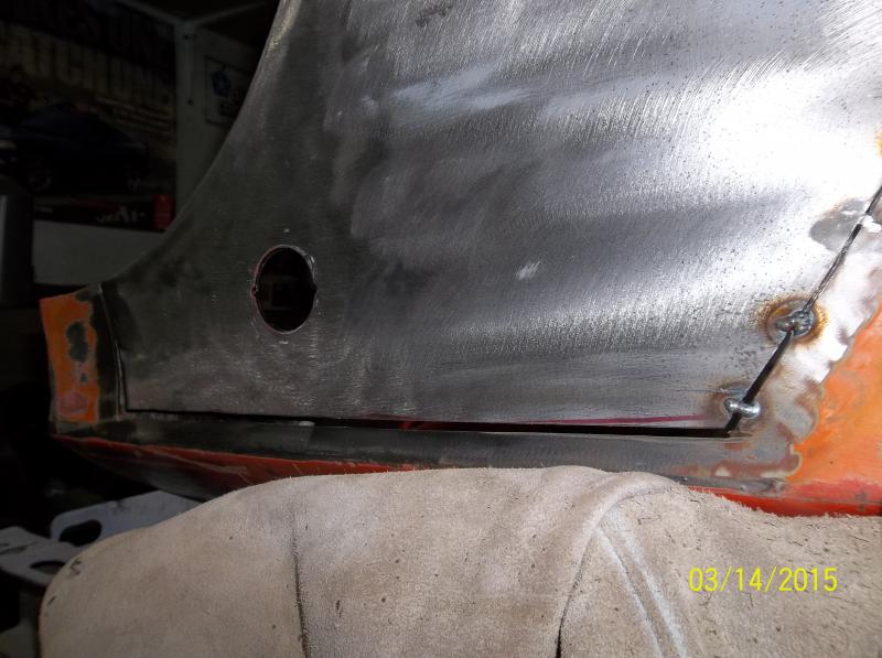

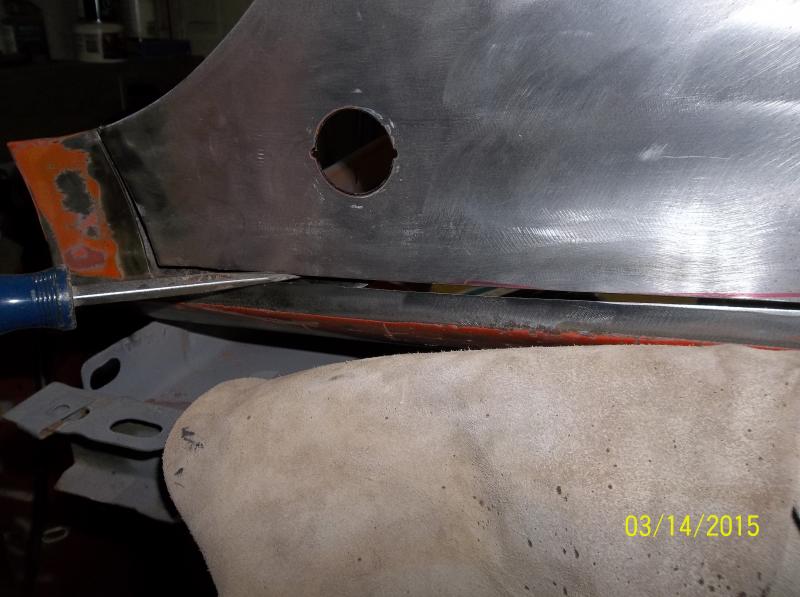

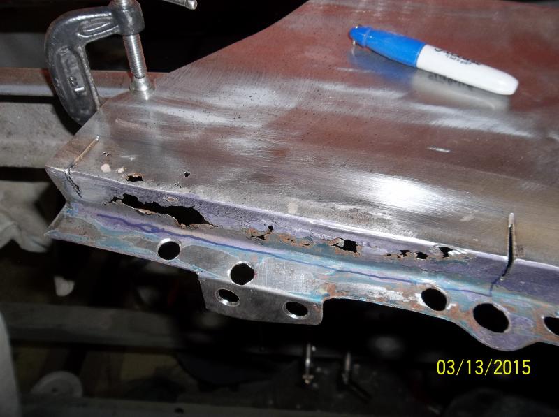

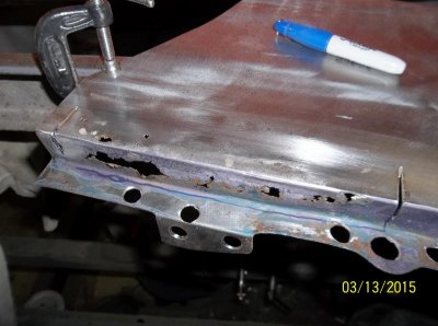

100_0796.jpg100_0797.jpg OOOOOPS.... after marking out the template, I do believe I cut on the wrong side of the line.... ROOKIE MISTAKE !! ( and I wasn't drinking, so I can't use that as an excuse, lol) So after some head scratching, I figured the steel wire could be used to take up the gap when welding.... hope this works....
Damn nice job you're doing. I've see folks use that wire trick on welding up high temp/pressure boiler tubes. Think you'll probably be ok with a little auto sheetmetal.
