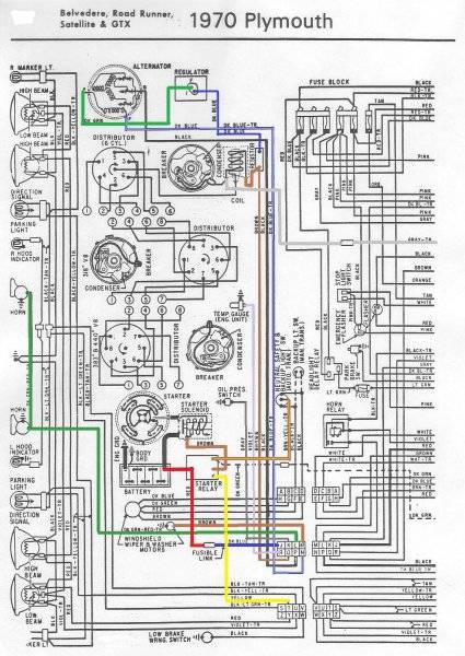

My issue is I have no clue which wires go to oil pressure, coolant, alternator also I want to eliminate the ballist resistor, the pro flow 4 has it's own harness that runs the distributor and all of it's sensors including the new fuel tank with internal fuel pump... I've looked at some schematics but can't make sense of blueprints lol

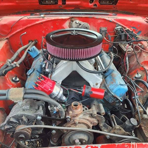

Srry here is a engine compartment pic. Before I added the Edelbrock ECU... still need a shorter belt this engine and trans came out of a 77 New Yorker and had ac which I removed and had to relocate the 100 amp alternator

I know nothing about fuel injection..... but.... I recommend you start with a factory wiring harness & a factory service manual & modify the wiring as needed for your fuel injection (assuming some wiring harness isn't available off the shelf????). As far as eliminating the ballast resistor, in general, you take the brown (start) hot wire and blue (run) hot wire coming out of the bulkhead harness connector/wiring that go to the ballast resistor, splice them together, and connect them to the blue (single ballast) or blue & brown? (dual ballast) wires that would normally come out of the ballast resistor....just splice past it like it was never there. A 1970 Satellite would have come single ballast...one blue in, one blue out. CORRECTION - brown&blue in, brown out. Splice those together.
You can start by downloading the wiring diagrams for your year model. This covers all 1970 Mopars, Dodge, Chrysler and Plymouth. You will have to open the zip file and sort it out and find the Satellite schematics A and B.
This is something I just did to help you. The colored wires are the ones you need for the engine harness side.

Awesome thanks Beep Beep this will help a lot, I'll post more pics later as I get further along
Out of curiosity....WHY are you using a GM alternator? Mopar had high amperage alternator, like a Leece-Neville unit. A FSM for your year model of vehicle will provide a wealth of information.

Well to be honest I don't have but a couple pics at the moment which are my profile pic. (On her way home from Idaho) and my engine pic I posted
BOB RENTON
Actually it is a Chrysler alternator it's the factory alt that came in the donor car (a 1977 Chrysler New Yorker) I just swapped the bracket from the stock with ac to non ac
