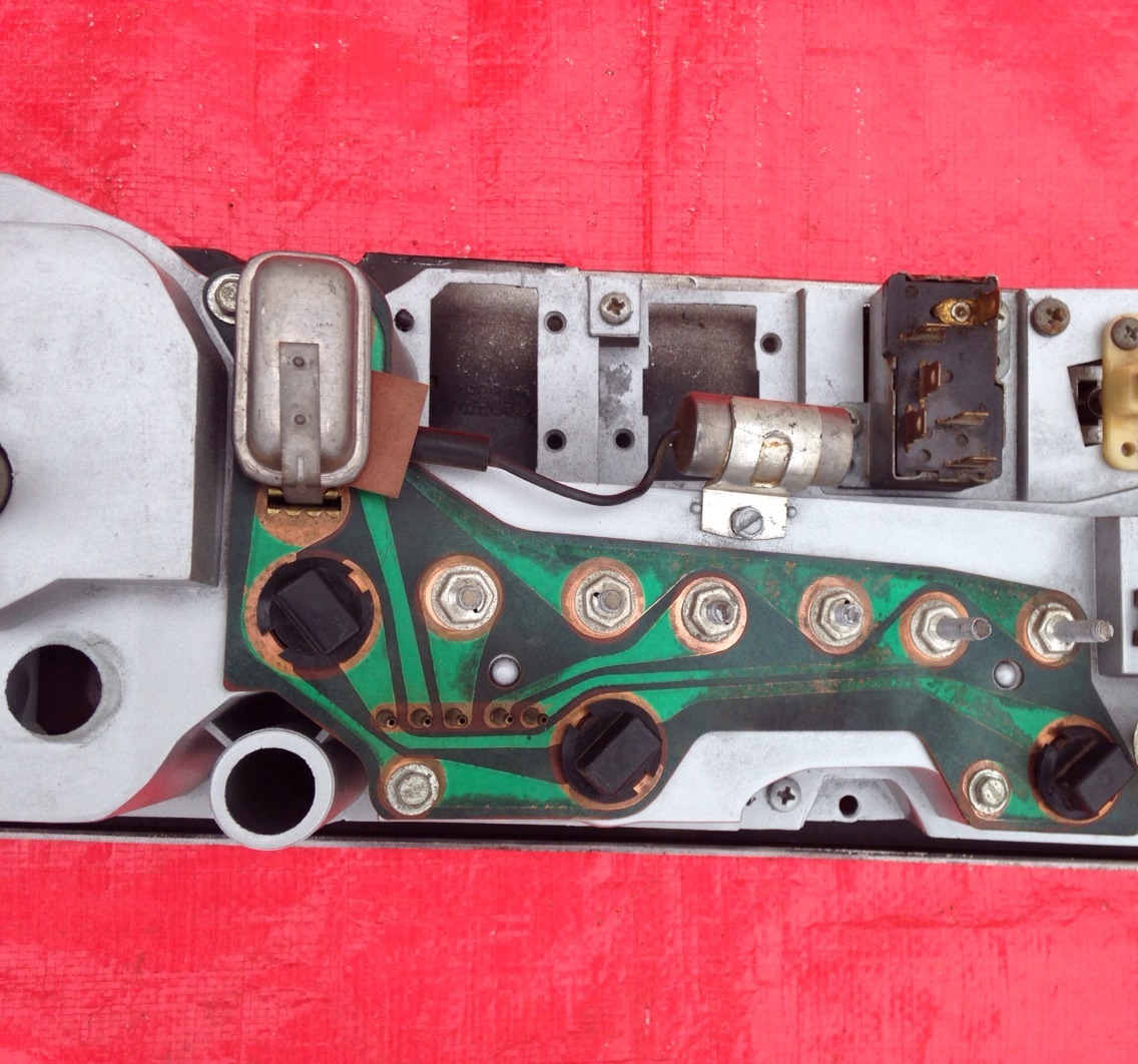

Hi. I have a 70 satellite with standard gauges. I want to convert just my gauge cluster to Rallye gauges without changing the wiring harness. I can modify my dash frame and retrofit plastic pieces. My light switch , dimmer, windshield wiper are independently operated so not a problem there. I do not have to have everything working in the Rallye cluster. More for looks than function as I can add gauges below my dash for necessity. I would like to know... can u leave the circle ⭕️ of dash wires not hooked up ? Is one a ground ? Can I use the blue wire and hook it directly to the fuel gauge and possibly a ground to make it work. Ohhh the ampmeter should direct fit also. Any help would be appreciated. Thanks
Yes. Only the amp meter wires HAVE to be hooked up (or connected together) for the car to run. The round connector is for all of the dash functionality (lights, turn signals, gauges).
Is one a ground ?
No, ground is through the chassis or sending units.
Yes. No.
The temp, oil, and fuel gauges use 5vdc from the voltage limiter (square metal can) on one side and the sending units on the other. The grounds go to the sending units.

The Ralley cluster has the turn signals, high beam, oil light wired directly. You'll also need a different sending unit for oil pressure.

You would need the Connector "Housing" for the Rally cluster. Using a terminal tool push the 5 needed pins out of the Non Rally circle connector and put in the Rally connector and then wire up the remaining and done!

Hey. I looked at the diagram, and shows the dark blue going to fuel gauge. I know that is the same color used on the standard gauges. I wonder if the other wire colors would be the same as well. Also. Does the rally cluster have to be grounded like the standard? Also. My Rallye cluster has just a clock ⏰ with one terminal. Do u know how I can check to see if it works. Thanks

Hey. I noticed the dark blue wire is for the fuel gauge on both standard and Rallye gauges. I wonder if the other colors are the same for both ? My Rallye cluster has a clock. Do u know how to rest it ? Do u know if the Rallye cluster has to be grounded like the standard. Thanks for you help
The colors should be very similar, I haven't done a B body is a long time but I have done lots of E bodies and I know that the wiring is very close (color wise). I am not 100% certain but I am pretty sure that the cluster is grounded and this is usually done via the screws that hold it into the frame.
cluster is grounded by chassis. Althought E bodies and 71 and lates B bodies got it wired too.
Becarefull with get good grounded the cluster. a failure on chassis ground will keep closed the VL points and this will make feed 12 volts straight to gauges as soon senders are conected and put the key in RUN or ACC, burning gauges
Oh! and colors codes are the same on most of all the functions since mids 60s up to mids 70s, rallye or standard cluster
