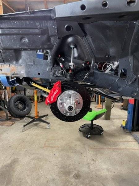

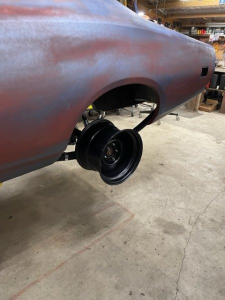

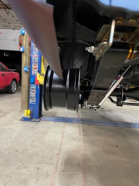

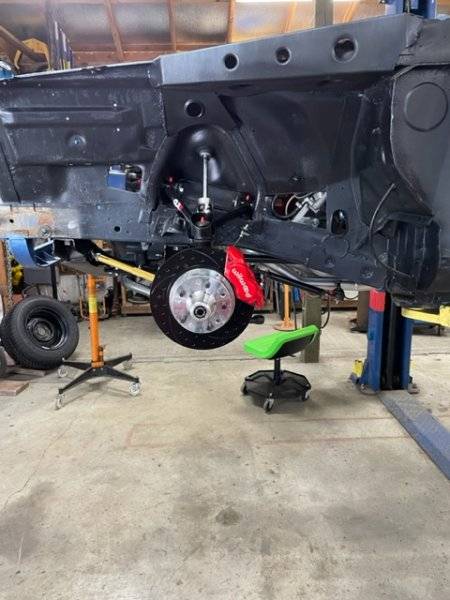

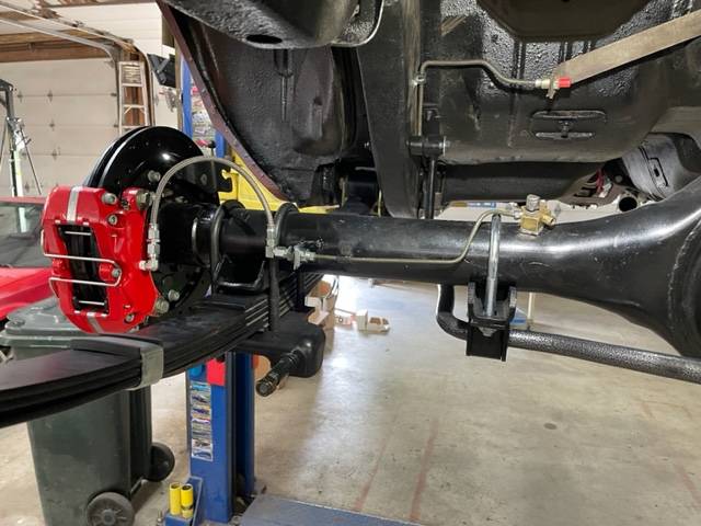

I then moved onto the front brakes/hub so I can make this a roller, turns out that I have newer spindles (1.375 bearing size...) so the 1.250 B body Disc hubs from Wilwood will not bolt up.., I ended up ordering new hubs with bearings to fit what I have.
