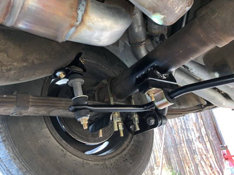

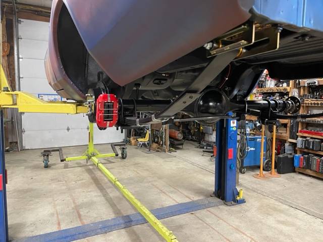

I did the same to the ADDCO on my Volare.On mine, once I had the mounting figured out with the angle of the dangle etc, I welded the bar mount brackets to the diff.

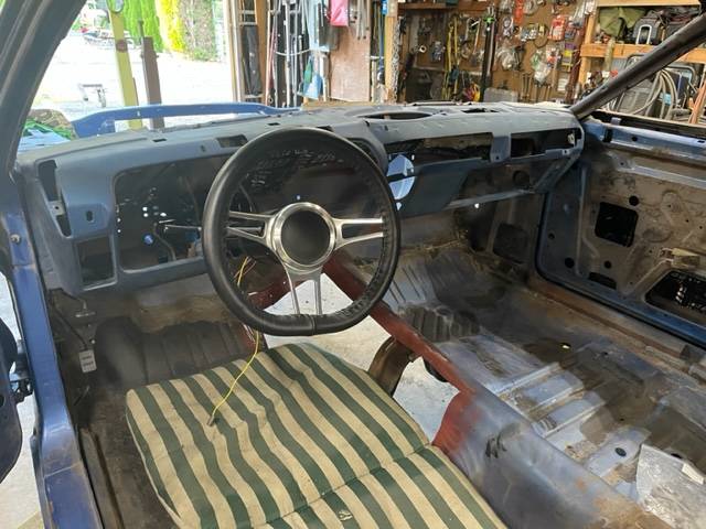

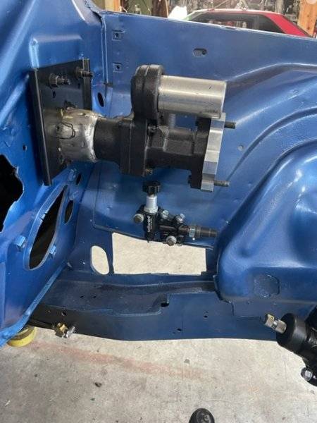

Ah, the dash bracket that almost killed me. Those hanging 1/4-20 studs will get you.So I have run into an obstacle where in I do not have the correct dash to firewall/cowl mounting bracket, so I am going to be sourcing one of those before I can proceed.

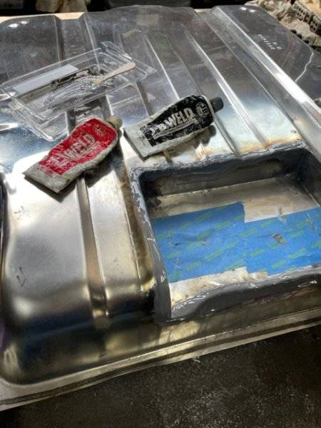

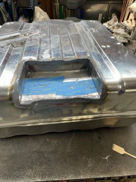

I just got mine this week. It had been on back order since March. If you do decide to get one, you may have to wait a while if they're out of stock again. It looks like a nice unit. for some reason I was expecting it to be stainless or plated steel, but it's either painted or powder coated.Ive been working on my gas tank some and am strongly considering buying an Aeromotive stealth tank. I am having an issue trying to get the sending unit to seal up, I need to try and make a closed cell foam gasket or maybe some RTV.
Good thinking. In my case I bought a SS stock tank and then cut into it making a shelf for a fuel pump and sending unit, the problem I have at them moment is that I got a little warpage from welding around the sending unit which has a relatively thin rubber gasket so it doesn't want to conform and seal. The tank doesn't hold pressure so I am not worried about that part but I don't want it to leak either.I can relate on the unnecessary spending. I'm going to use the universal 22 gal early Stang unit from Tanks inc. I borrowed a standard Stang tank from my old boss to use for mockup and see if my theory was correct. Since I moved the springs inboard, the oe unit would collide with the springs. The Stang one is narrower. I planned on cutting up the trunk floor anyway so its no big deal to configure it for the new.
