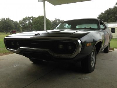

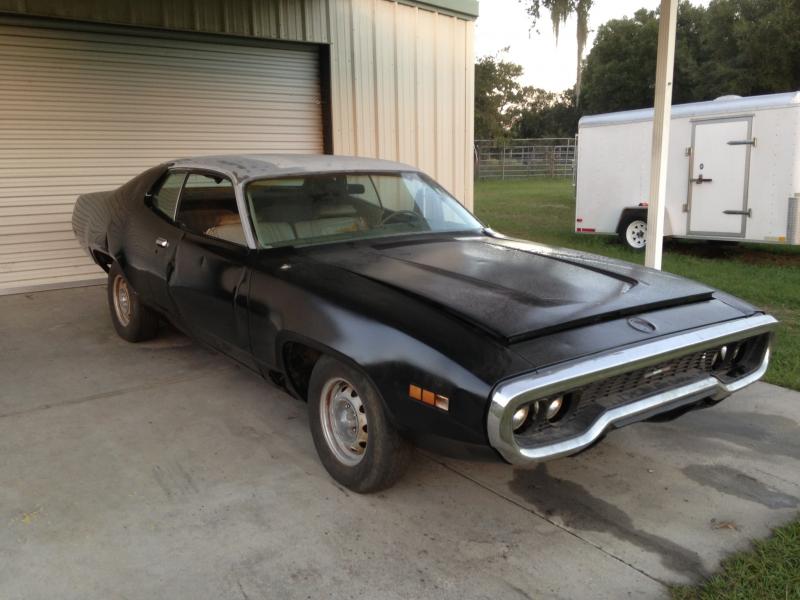

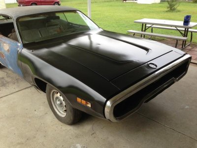

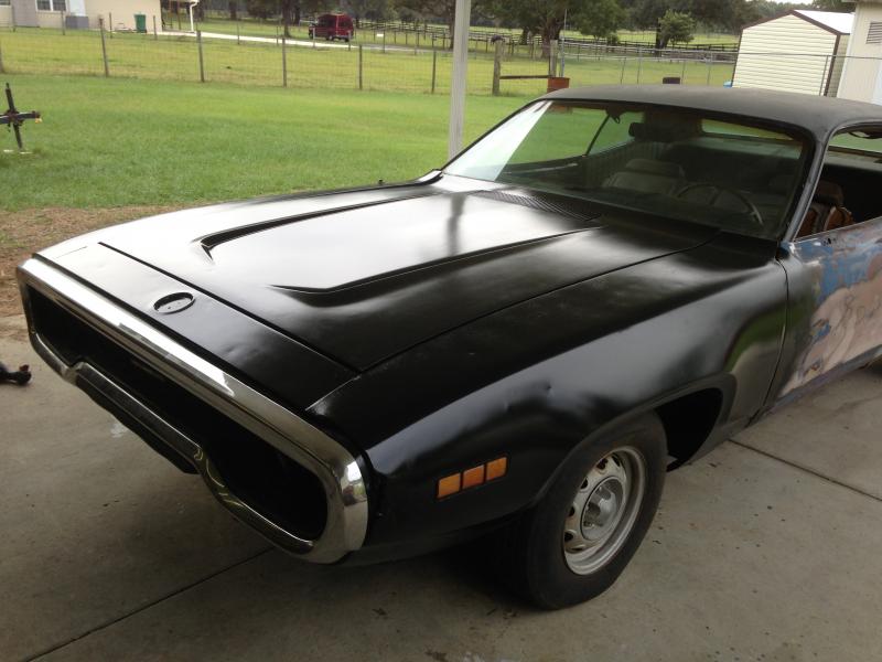

image.jpgimage.jpgimage.jpgHere are a few photos of the SSB with the nose clip in black epoxy primer. The sky is cloudy and gray this morning so the pictures didn't turn out as good as I hoped for.
You can see the improvement by just looking at the doors which still need sanding down to bare metal.
There is no comparison.

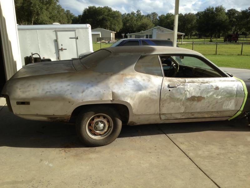

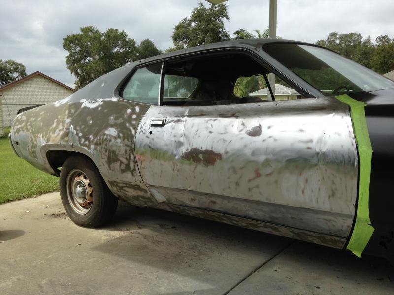

The passenger side door has been sanded down to bare metal. After these pictures were taken I wiped the bare metal down with Ospho.
On the rear quarter panel I sanded it down to the original paint. In some areas I took it all the way down to bare metal here too.
Hopefully tomorrow I can finish sanding everything down and spray the rest of the car with the black epoxy.

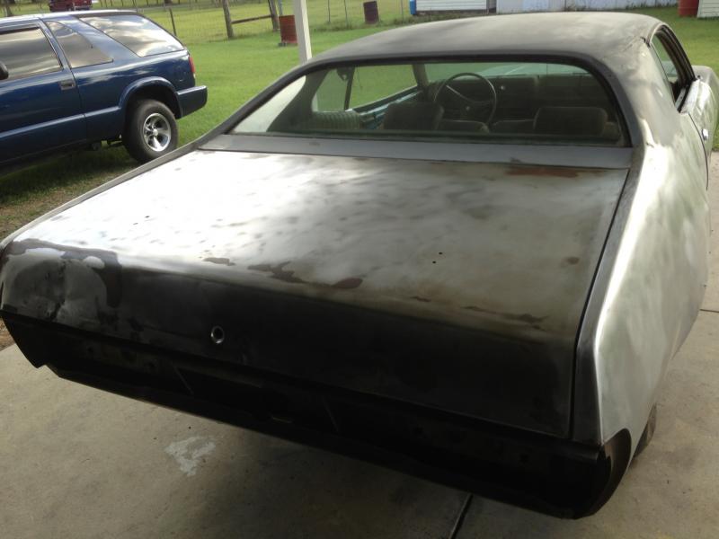

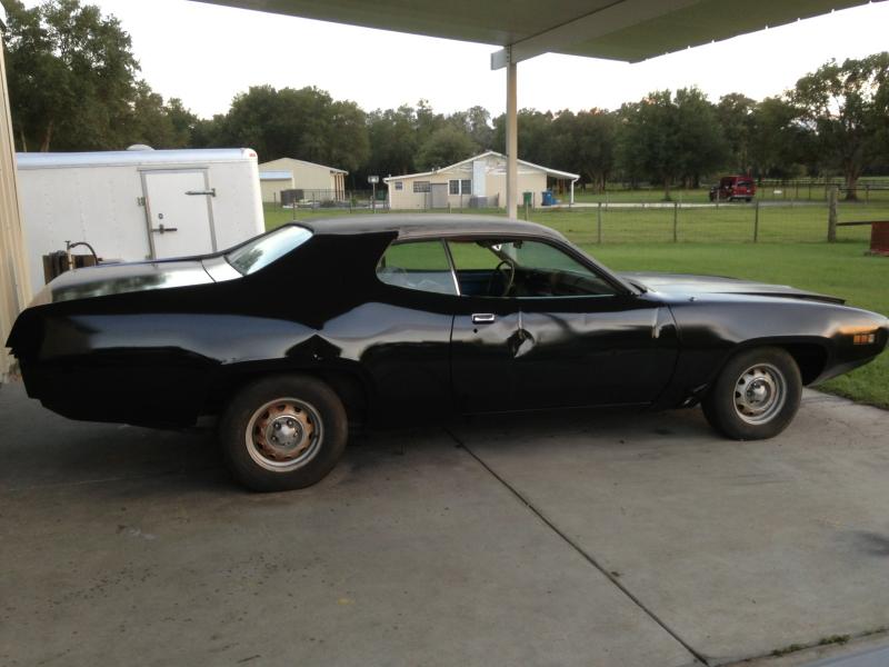

I just couldn't stand seeing the remaining original paint on the passenger side rear quarter panel. so I sanded all of it off.IMG_0230.jpgIMG_0944.jpgIMG_3036.jpg
Then I decided to grind out all of the body filler on the trunk lid too.
There was a pretty good sized dent that someone tried to pull out a little with a dent slide hammer. They didn't doo to good of a job. The dent is still about 1/2 inch deep.

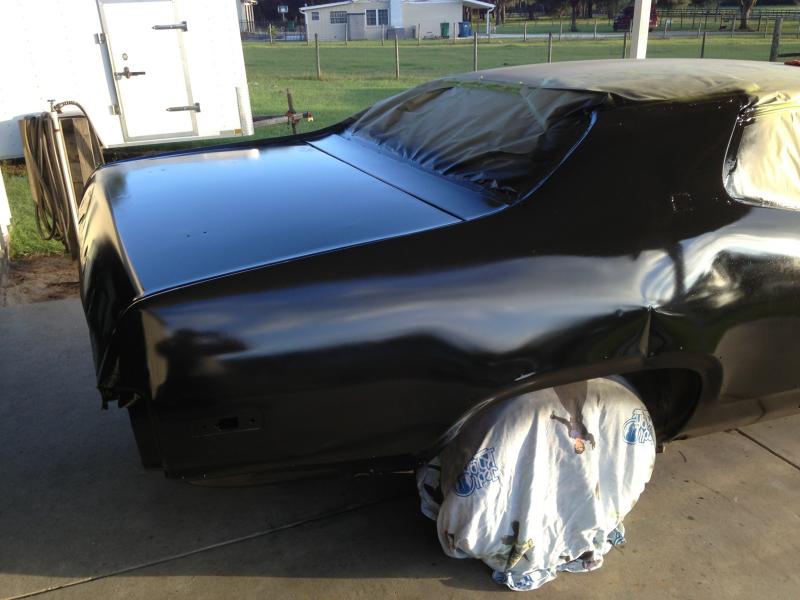

Then I sprayed it with Southern Poly Urethane black epoxy primer after the surface rust areas were treated with Ospho.
I still need to sand the driver side door, remaining portion of the roof, and driver side rear quarter panel.
The Driver side rear quarter was repaired from a minor collision at some point during the past. Who ever did the repair just took a chunk out of another car and welded it right over the existing quarter panel.
If I was going to keep the car I would be replacing the whole quarter panel with a complete one from AMD. Because of this I'm not sure exactly how much time I will be putting into cleaning the other side up. I'll probably grind all of the filler out so the prospective buyer can see exactly what the car needs.

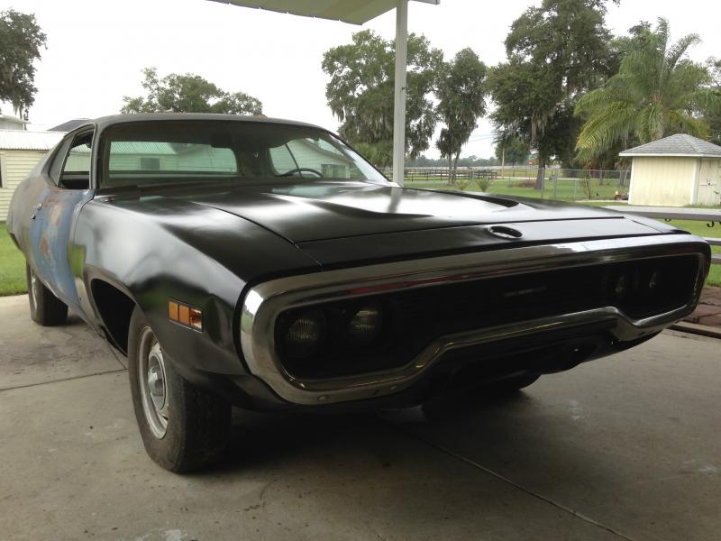

IMG_7299.jpgHere is a picture showing how the driver side looks now.
Hopefully tomorrow I can have the rest of the car black.
