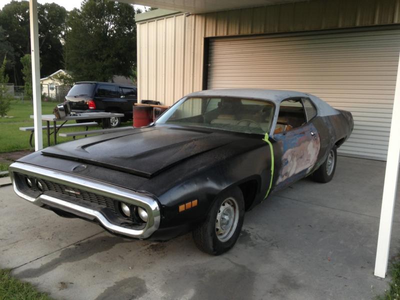

I know, that's what I've been telling myself too. Drove it around in the yard a little today. Then I turned it around in the driveway pad in front of the shop when I parked it so I could work on the rear of the car.:headbang:

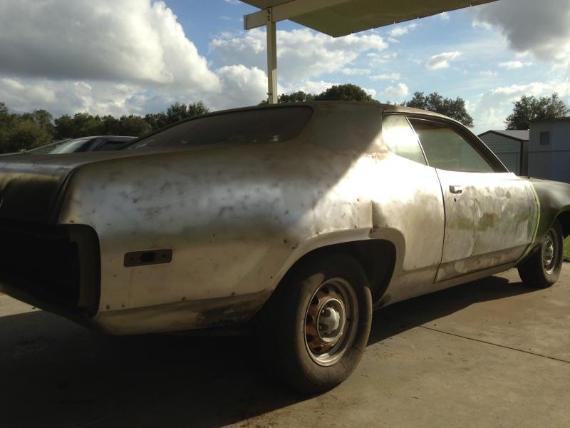

I just couldn't stand seeing the remaining original paint on the passenger side rear quarter panel. so I sanded all of it off.View attachment 146427View attachment 146428View attachment 146429
Then I decided to grind out all of the body filler on the trunk lid too.
There was a pretty good sized dent that someone tried to pull out a little with a dent slide hammer. They didn't doo to good of a job. The dent is still about 1/2 inch deep.

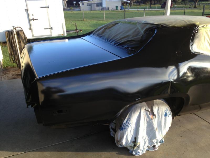

Then I sprayed it with Southern Poly Urethane black epoxy primer after the surface rust areas were treated with Ospho.
I still need to sand the driver side door, remaining portion of the roof, and driver side rear quarter panel.
The Driver side rear quarter was repaired from a minor collision at some point during the past. Who ever did the repair just took a chunk out of another car and welded it right over the existing quarter panel.
If I was going to keep the car I would be replacing the whole quarter panel with a complete one from AMD. Because of this I'm not sure exactly how much time I will be putting into cleaning the other side up. I'll probably grind all of the filler out so the prospective buyer can see exactly what the car needs.

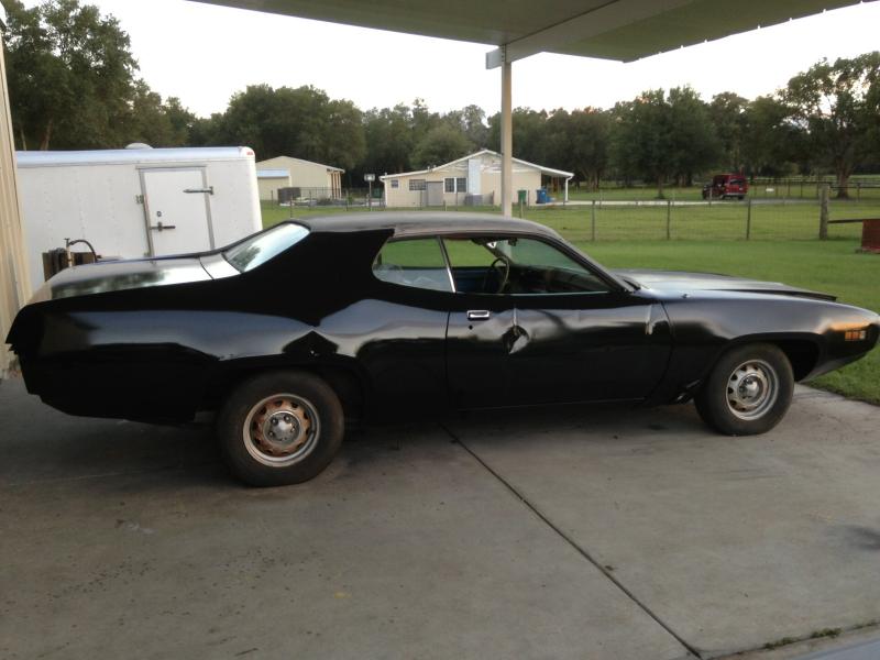

View attachment 146438Here is a picture showing how the driver side looks now.
Hopefully tomorrow I can have the rest of the car black.

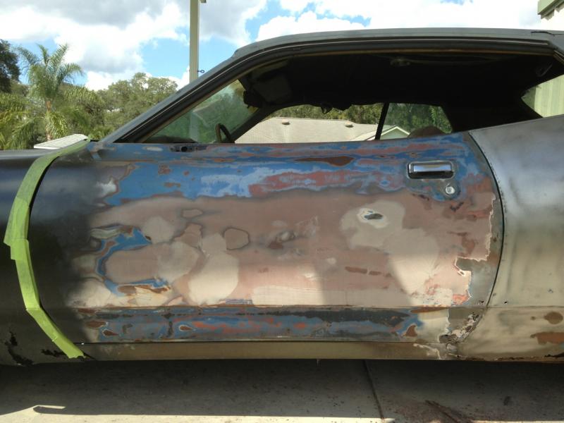

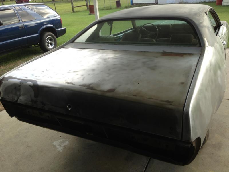

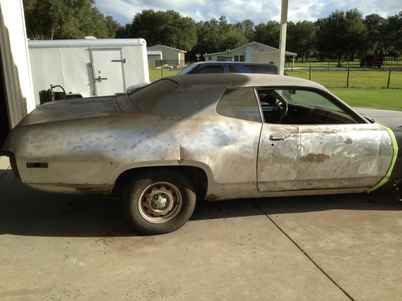

IMG_9309.jpgToday I spent most of the day grinding out all of the old body filler and took everything down to the bare metal on the 72 Satellite I have listed for sale here on FBBO and Craig's List.
Turned out the driver's door is a lot better than I originally thought. It can be saved with some work. Here is a before photo.
Followed by the after ...............
Now here is the ugly part. Earlier I mentioned that someone in the past simply welded a part of a quarter that was cut off another car directly over the existing panel. Here is how it looks after all of the filler was removed. It will definitely need a full OEM style AMD replacement to properly fix this.View attachment 146719View attachment 146720View attachment 146721

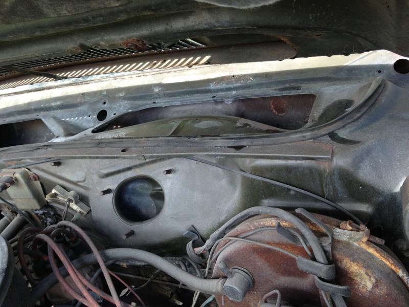

Tomorrow I will spray the rest of the car in black epoxy primer. Then I will post the pictures, and include some close ups of the fire wall and inner fender wells. These areas look just as good as the floor pans do.

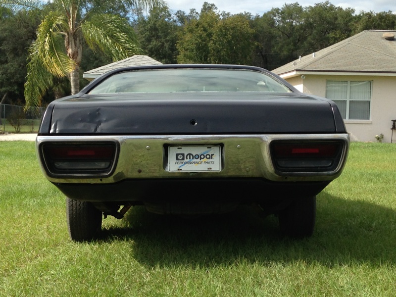

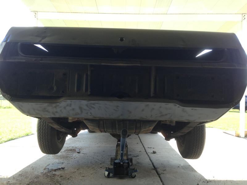

Here is a parting view after the rear valance was sanded down.

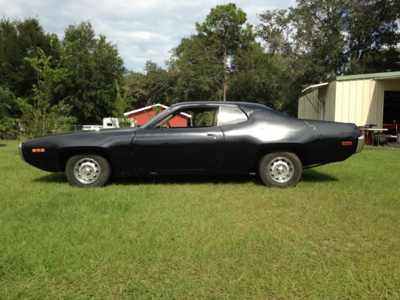

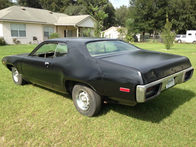

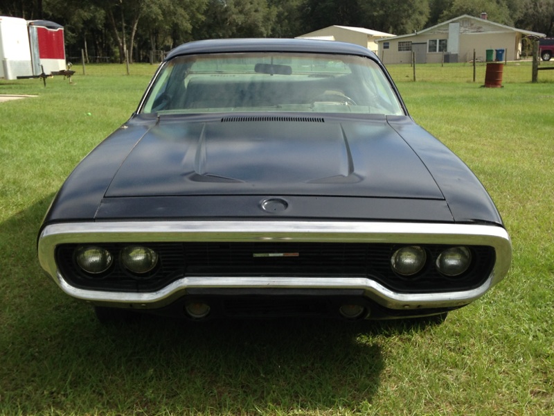

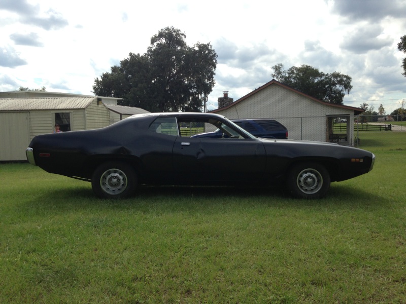

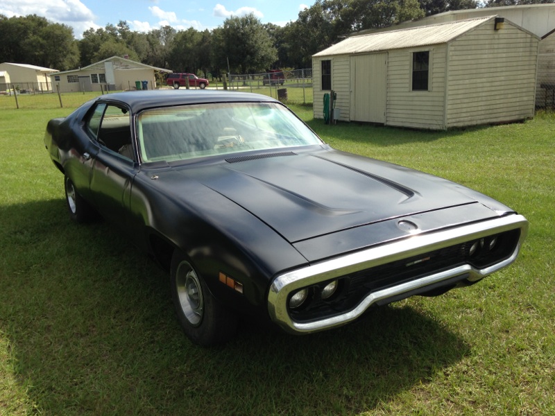

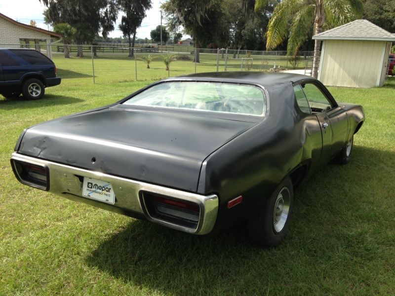

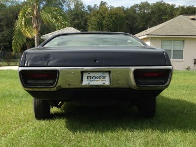

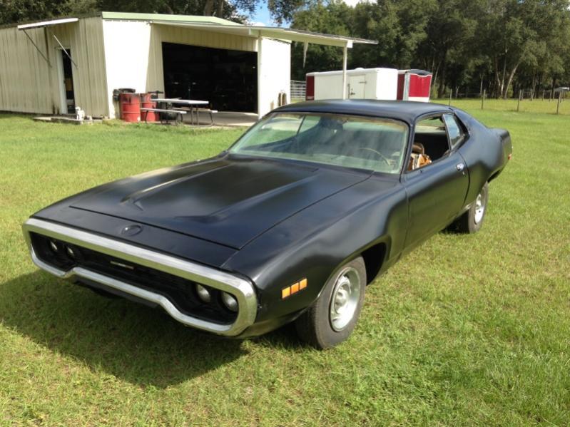

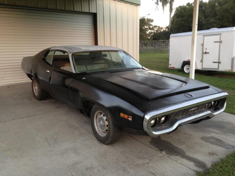

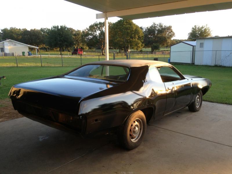

Well today I was able to spray the rest of the car in black. Then I reassembled her and took it for another spin around the yard.
I also installed the trim rings on the rally wheels. I still have to clean the window chrome and reinstall it too.
Now all of the old paint and body filler have been removed and a good solid coat of epoxy primer is ready to go. It is basically a blank canvas for someone to work with now.

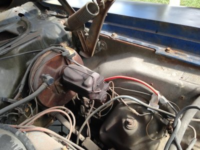

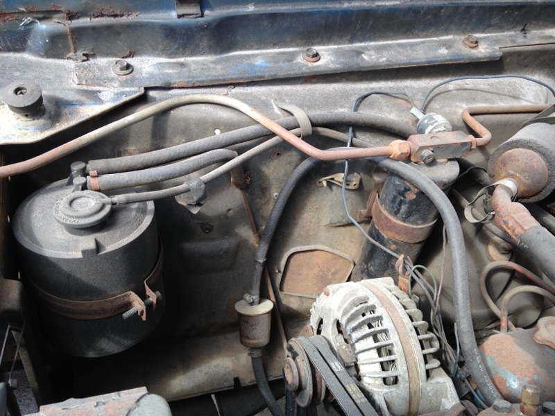

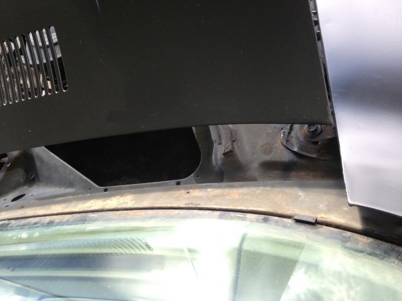

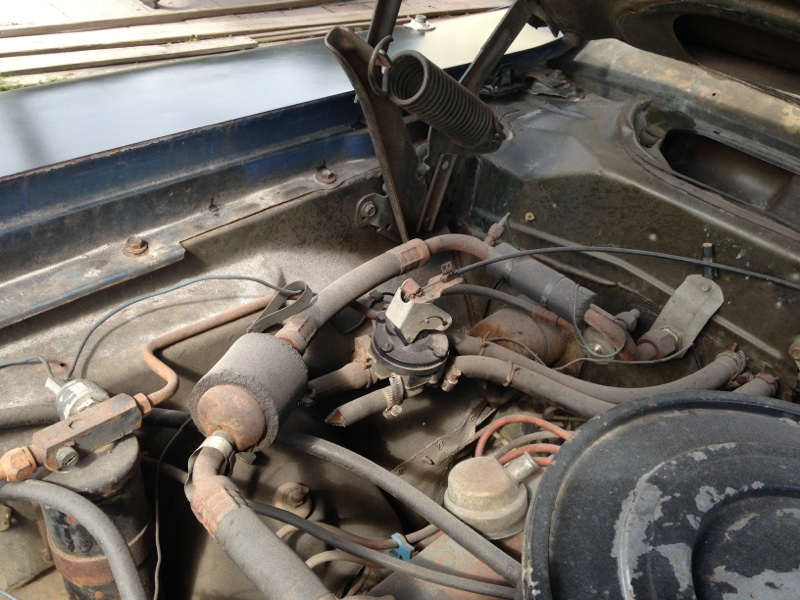

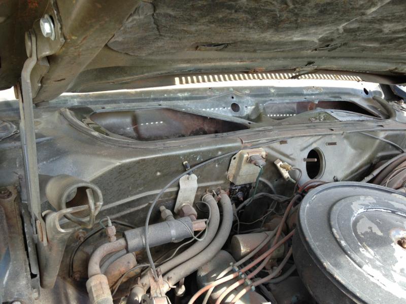

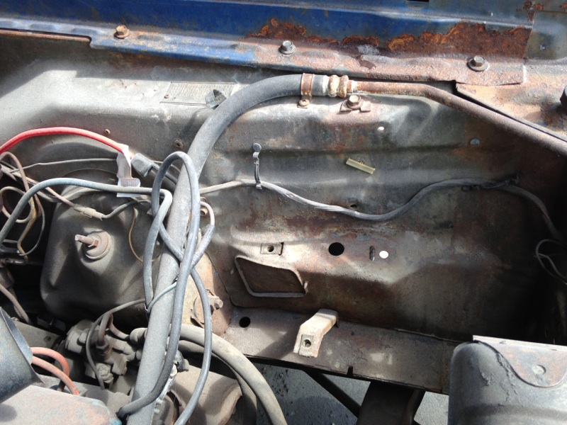

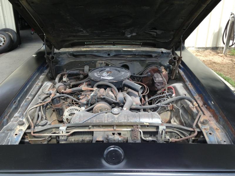

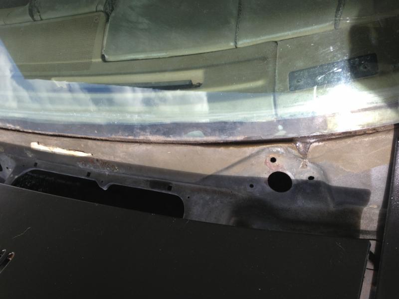

As promised here are the other photos of the engine compartment and firewall that show just how rust free this car is.

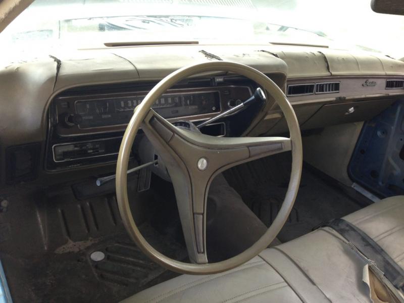

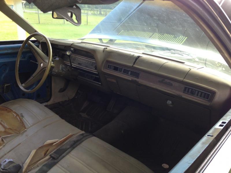

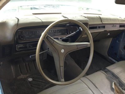

The last picture shows the dash. Surprisingly, the chrome on the dash bezel is still in very nice condition.
And the steering wheel is not cracked.

That car looks great, someone could get a dash cap for it and that would fix the interior some for about 77 bucks, thats what i paid for one anyway.. Here is a link for any who may be interested in one, just put the year and Plymouth Satellite and it will take you to them, i think you can pick a color also. Thought i would add it, not to bad to dress the old gal up!
http://www.jcwhitney.com/coverlay-blue-dash-cover/p2008199.jcwx?filterid=d1799y1971g2j1&skuId=404715
Thanks Ron. Great minds think alike !!!! I just ordered a dash cap in black............ seriously I did.............. I was just talking with tallhair about it.

I spent money for the dash cap to dress her up a little.

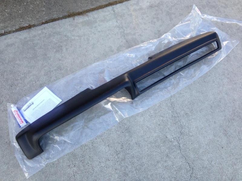

Dash Cap Arrived
Here is a picture of the dash cap that was delivered a few minutes ago by Fed Ex. It looks to be pretty nice. I also had a couple look at the SSB today and they seem to be interested in it. They want the spare 440 and 727 along with the car. They are supposed to let me know something tomorrow. They seemed like a nice couple and the car would be going to a good home.

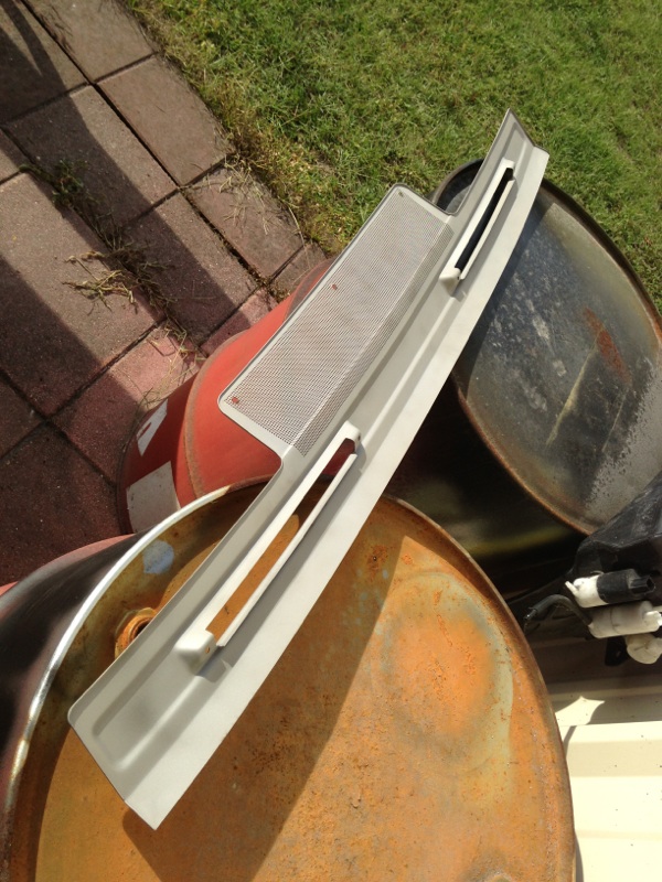

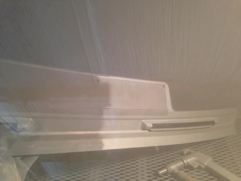

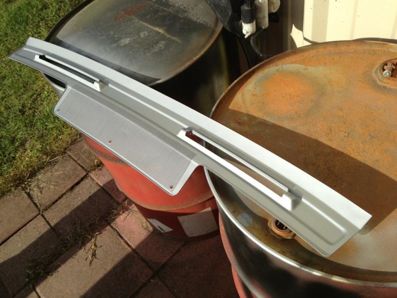

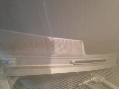

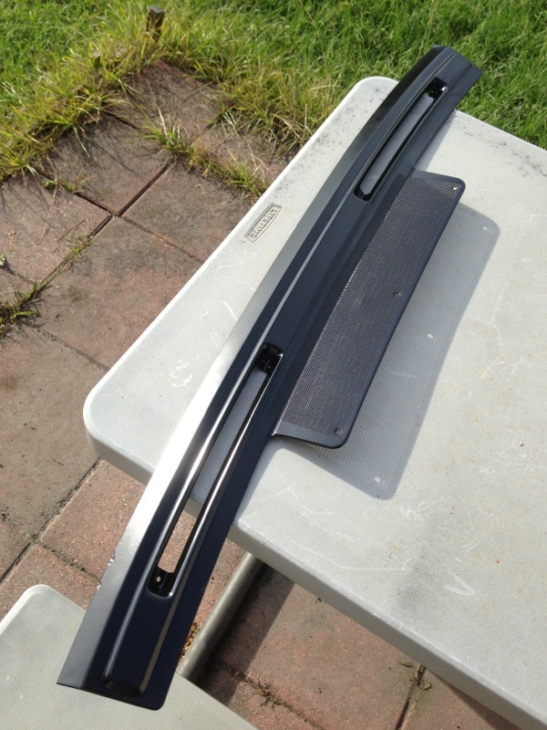

I couldn't stand not doing anything on the RR for a while, so I pulled out the front speaker cover and went to town on it.
Here it is as I started glass beading the part.
Here is the same part after it has been blasted.
This is how it looks after spraying the back side in a natural metal finish.
And the finished product.
I will probably end up doing the same thing to the part on the SSB, and then install the black dash cap.
That way the dash will be black and will match the seats from the RR. That's all for today.
