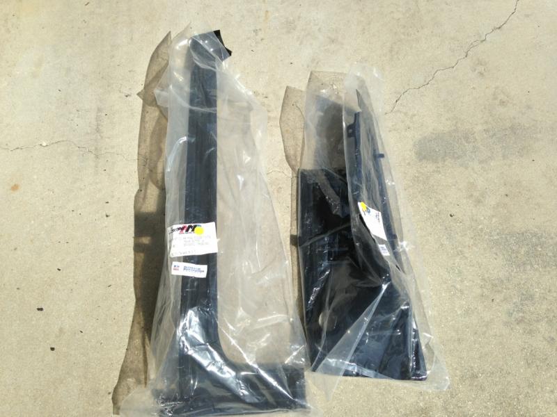

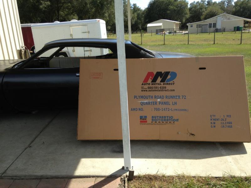

A little while ago we got back home from meeting my friend Ted Stephens of Stephens Performance. He did me a BIG favor and brought all of the AMD parts I ordered earlier from him to the Garlit's show. It sure saved me a lot of money on shipping.
Thanks again Ted !!!!:headbang:

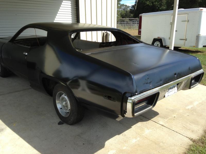

He has a VERY COOL car on a rotisserie display that show cases some of their A Body parts. You can see the car in the back ground of this picture. All of the black parts are new AMD items.
I'm telling you, the industry has definitely come a long way over the last 10-15 years. Back then I never would have dreamed of all of these quality new parts being made that are now available for us to use on our cars.
You guys that have been restoring cars for a while know what I'm talking about.

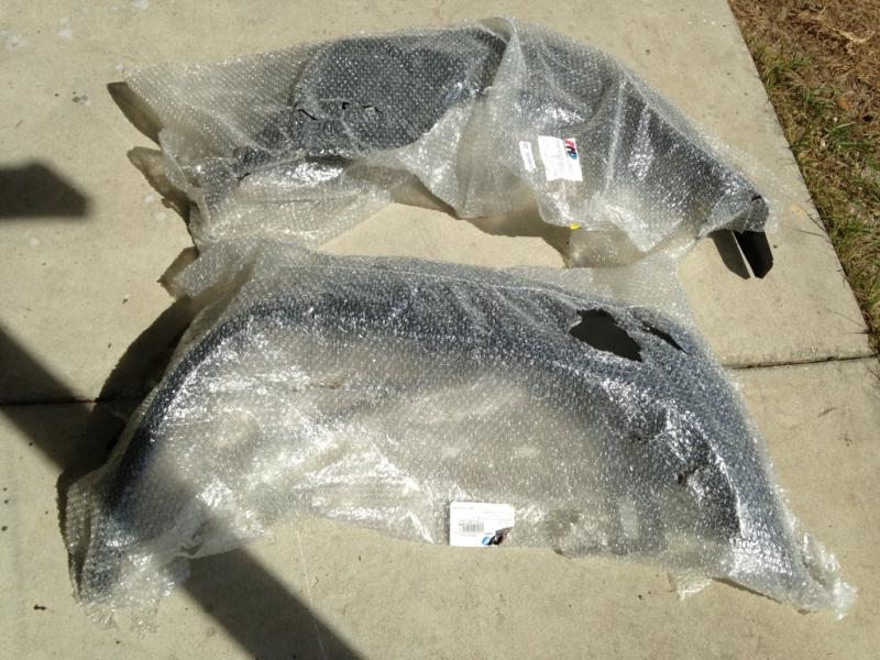

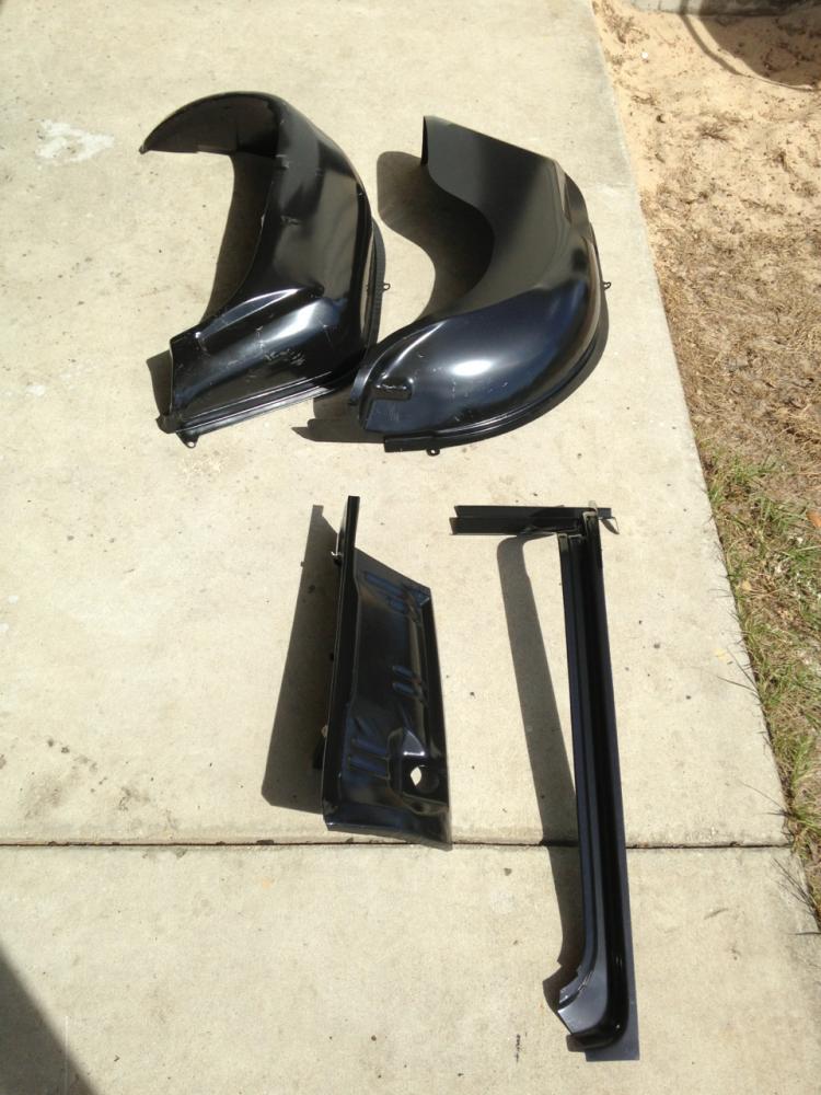

Here they are all unwrapped.............

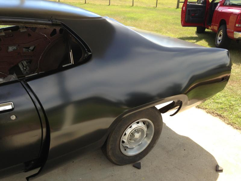

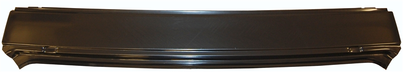

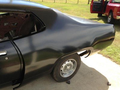

And of course I just couldn't resist placing the new Quarter Panel in place over the top of the existing one !!!!!
She looks better already !!!!
Now I just wished I would have ordered the new Dutchman panel............. Oh well.

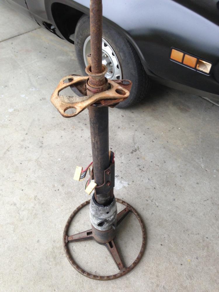

On the steering column this car is a column shifted automatic. Part of the column is broken where the gear shift selector inserts at. I will have to take it apart and replace the broken parts. No I have another decision to make..............
I am pretty sure I have another donor column to convert this car over to a console shifted car with buckets...........................

Funny you should ask about the steering column. It has to come apart so that I can replace a few broken parts.
No problem, I will do an little "How to" write up on it. It should be coming up soon, so stay tuned !!!!!

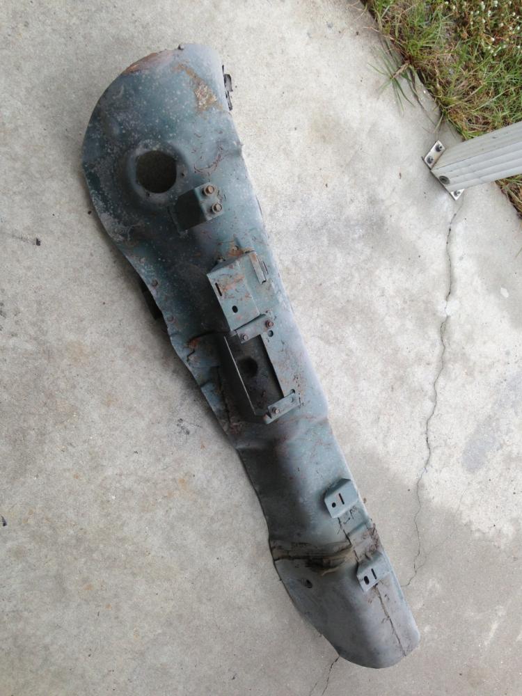

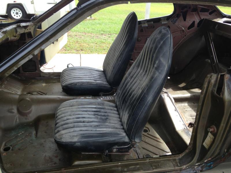

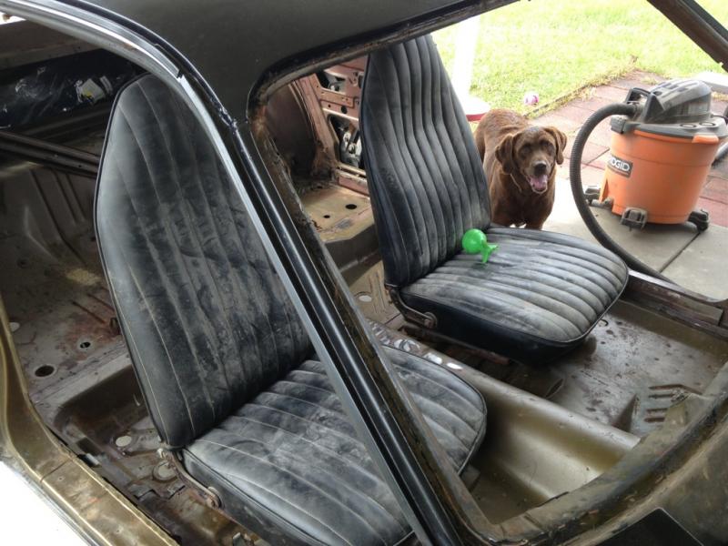

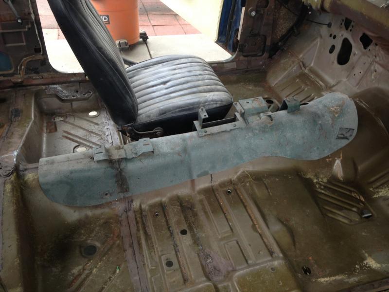

I found some goodies that will work with the 72 SSB. So here are the pictures of what I just retrieved from storage. The seats will actually clean up pretty nice and don't have any tears in the upholstery. They will be perfect for my new "driver" car.
I also found the extra steering column too. You know where this is headed.........
So I drilled out the extra seat mounting holes in the floor pan and set the seats in position to see how they look.
No turning back now.

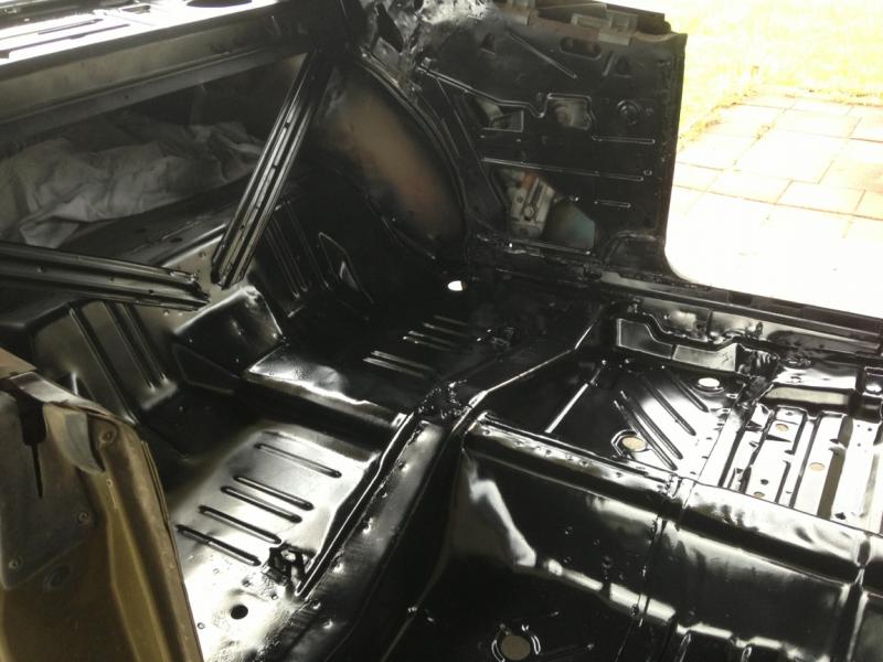

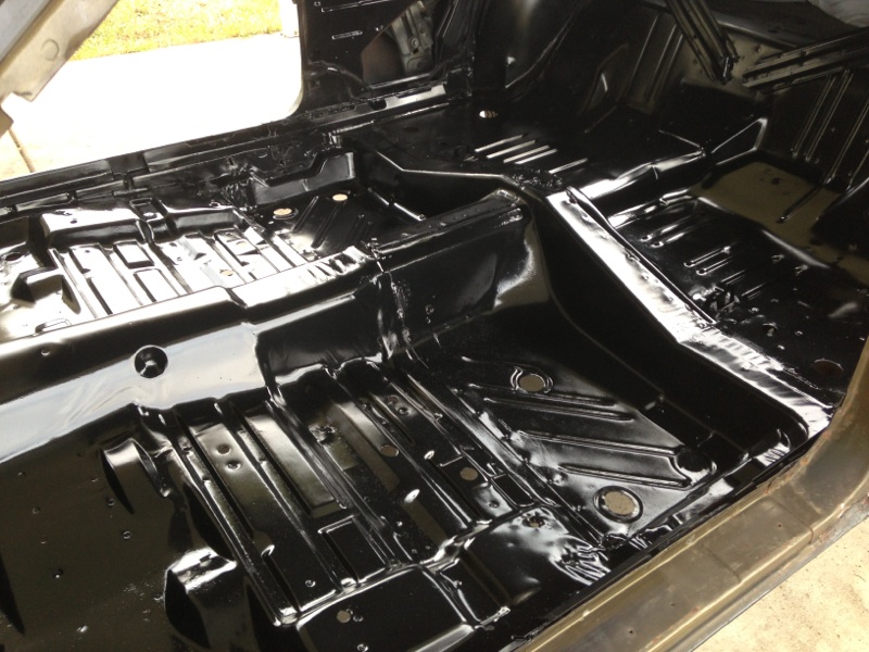

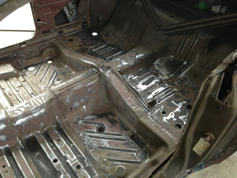

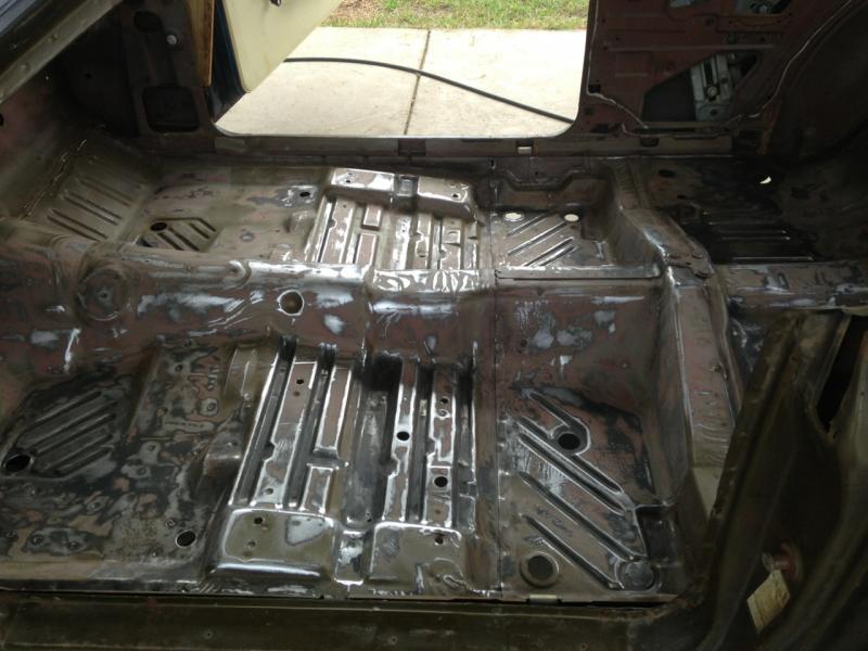

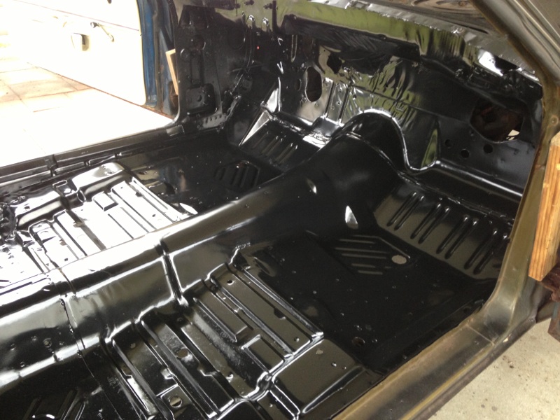

I was able to accomplish a lot on the car today even though the weather wasn't really cooperating. Once all of the tar based seam sealer was scraped / brushed out, I used my Dewalt angle grinder with a wire wheel to get down into the crevices and clean everything up really nice. This was followed by the use of a DA sander and 80 grit paper to feather the edges and smooth the floor out. I used such a coarse grit, because I wanted the paint to have something to bite into and hold well.
One more thing I found in storage that will be needed for this car.............
Here are a few pictures showing the progress.

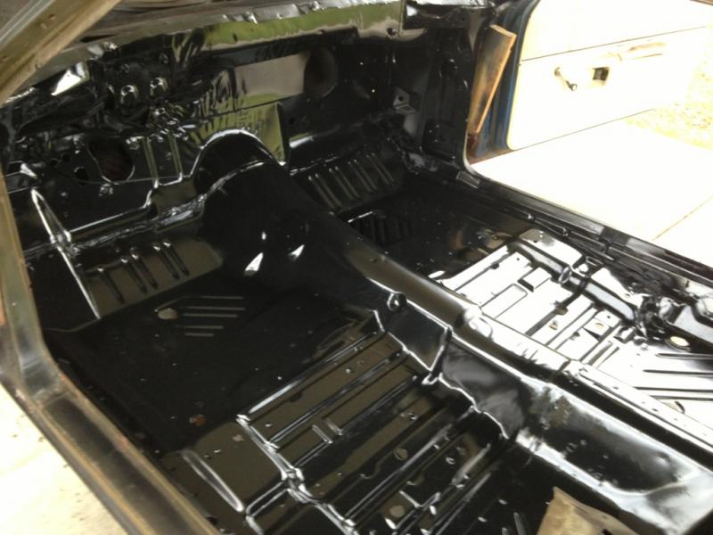

Once everything was blown off and wiped down I sprayed it in black epoxy primer, which also acts as a sealer.
Since this car will be a driver, this step was probably not necessary.
I feel better knowing that there are no "hidden" surprises, and that the car is actually as solid as I thought it was. It looks very nice now.
Hopefully tomorrow I can start detailing items that belong on the fire wall, and get some of these parts re-installed back on the car.
My current goal is to get the dash back in, and have the car in a condition that I can start it up and drive it again. Then I can get busy replacing the brakes.

You sure have went to town on this and it does look great, Maybe you wouldn't have had to go that far but its good and solid and if you do sell it later, it will be good to show someone all the work and prep you've done!

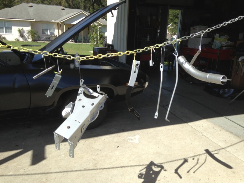

Today was spend cleaning / painting parts that are located on the firewall.

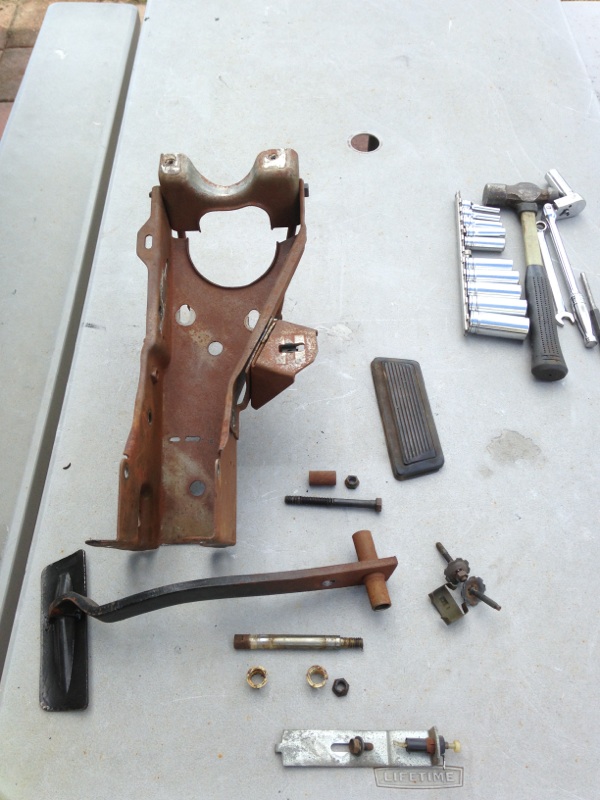

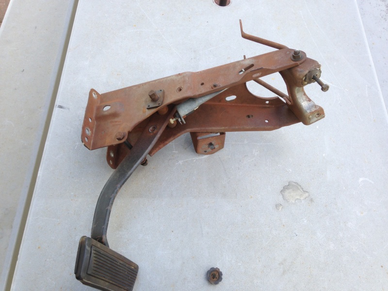

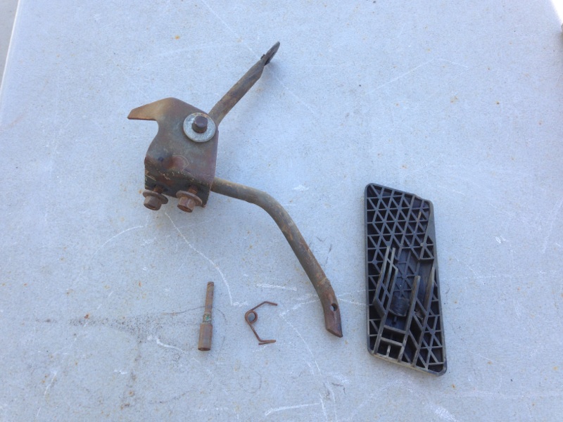

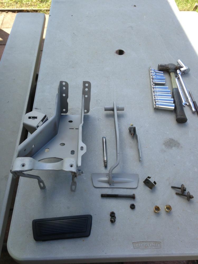

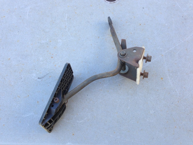

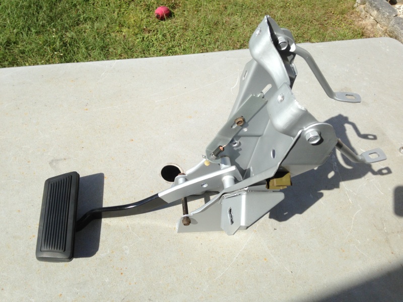

Started by taking the brake pedal assembly apart.

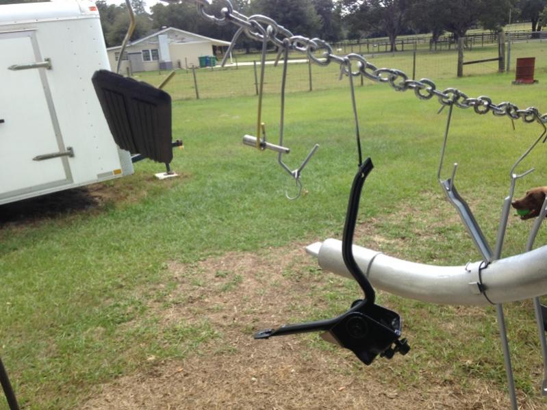

Then I cleaned off the surface rust in the glass bead cabinet.
This was followed by spray painting. I masked off the lower half of the brake pedal and painted it gloss black.
If you look close you can see the gas tank filler tube that I picked up this morning..............

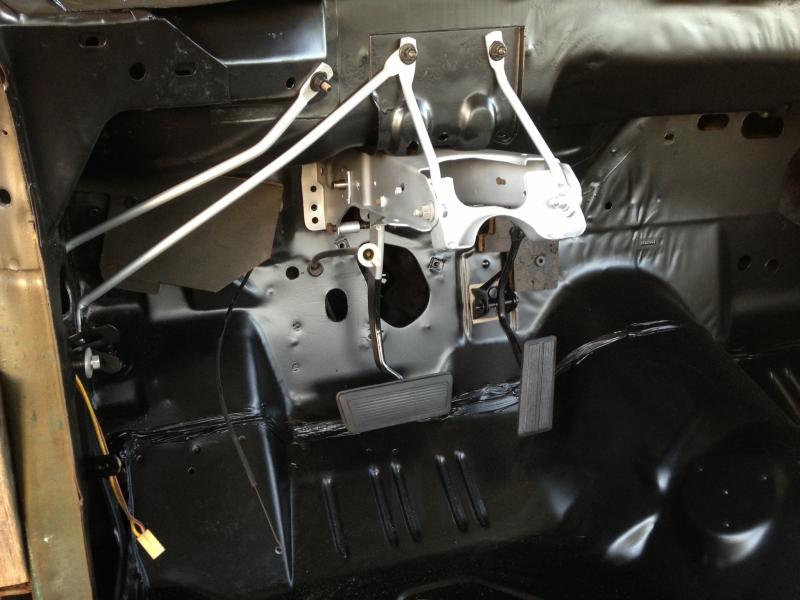

Here is the end result. The same process was done with the accelerator pedal.
Then I bolted these parts back in place and installed the insulation and dome light wiring.

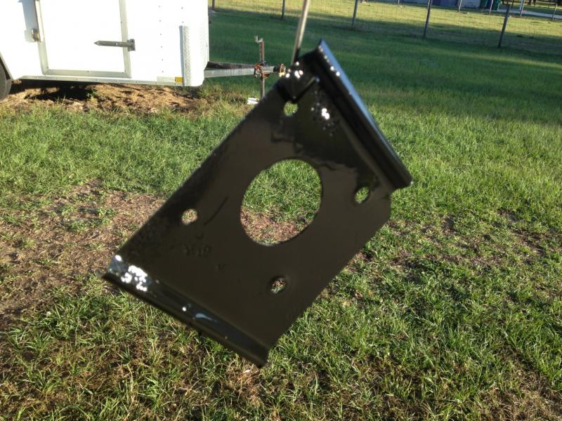

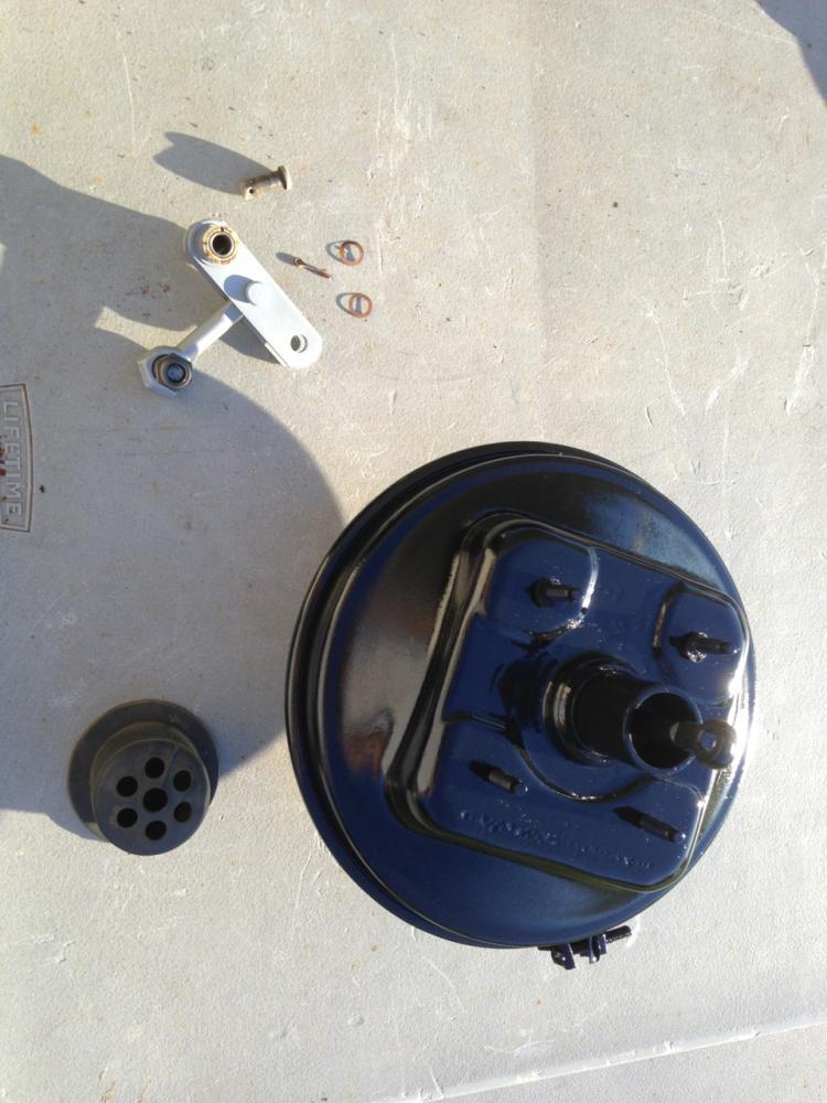

Then I proceeded to clean and paint the power brake booster.
Followed by the fire wall stiffening plate............
It started getting late and the paint was still tacky on the booster and plate. So I moved the parts inside to allow them to dry overnight and closed up shop for the evening.
It was a very good day. Hopefully tomorrow, I can install the brake booster and new master cylinder. Then I will start on the heater / AC box and replace the heater core.
