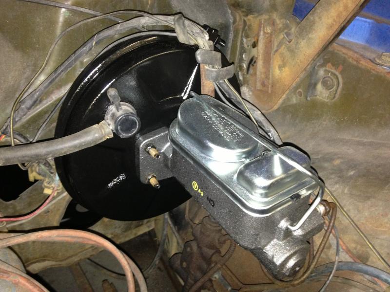

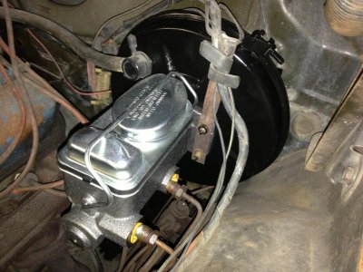

Today didn't go as originally planned. Instead I spent a good part of the day doing errands and a few "honey do's" around the house. However, some progress was made on the car.

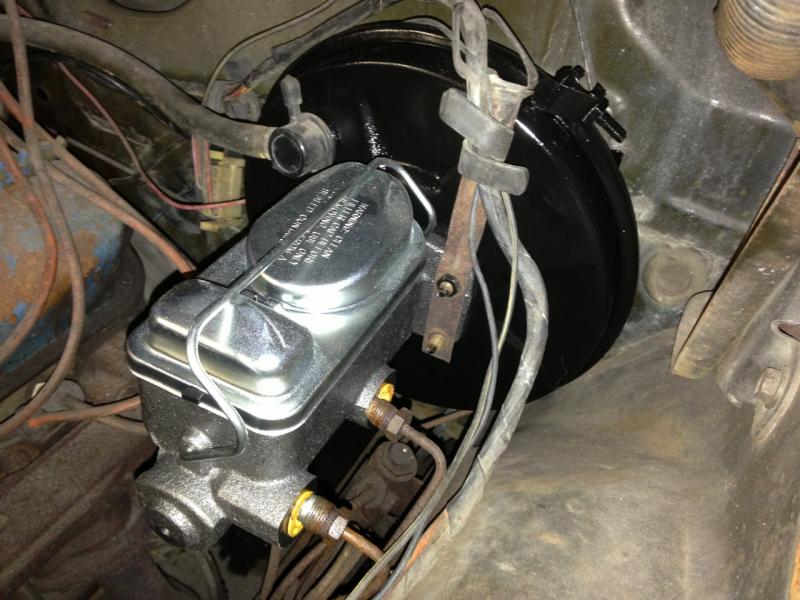

I was able to install the power brake booster and bolted on the master cylinder. The master cylinder is a brand new unit from NAPA and not a remanufactured one. Part # M2066.
It cost $44.49, plus $11.17 in shipping, and no core charge was needed. It was ordered directly from the manufacturer and took about a week for it to come in. For the little extra in cost and time, it gave me a little more peace of mind. Nothing against remanufactured parts, (sometimes that's all you can get), but with brakes I try to go the extra step and install new parts when they are available. Believe me, back in the day I rebuilt many master cylinders, calipers and wheel cylinders.
I still have to connect the brake lines though. Prior to installing the master cylinder, I sprayed it with clear engine enamel to preserve the natural cast iron finish. I wanted to preserve the inspections stamps as they are on the master cylinder right now. I know they are not "factory correct", but it gives the appearance of being so. I am just making this into a nice every day driver.
They make a cast iron spray paint that is available in a can too, if you ever need to coat something to keep it from rusting and want to replicate the cast iron "look".

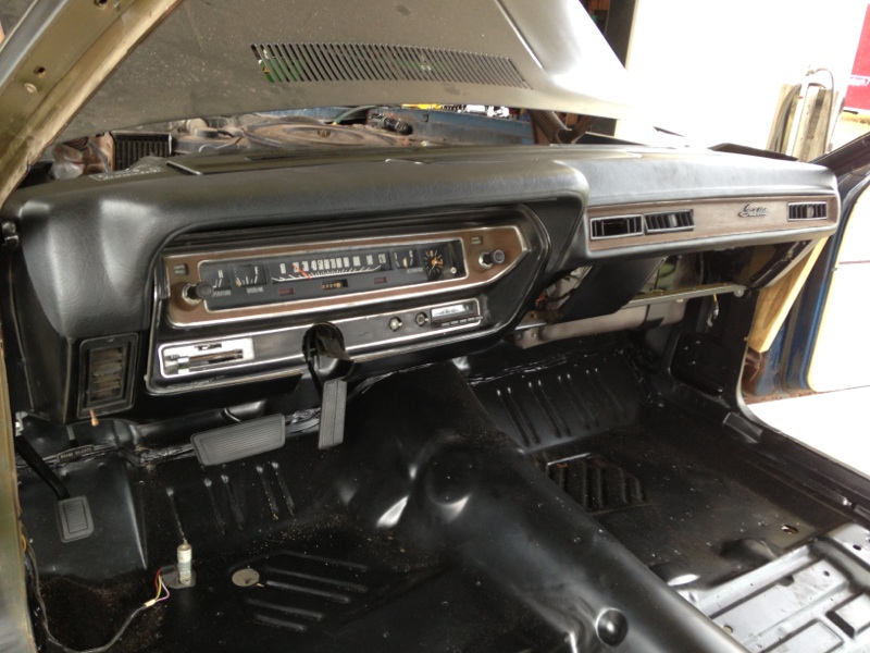

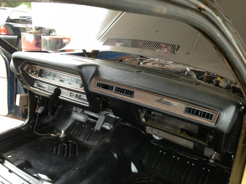

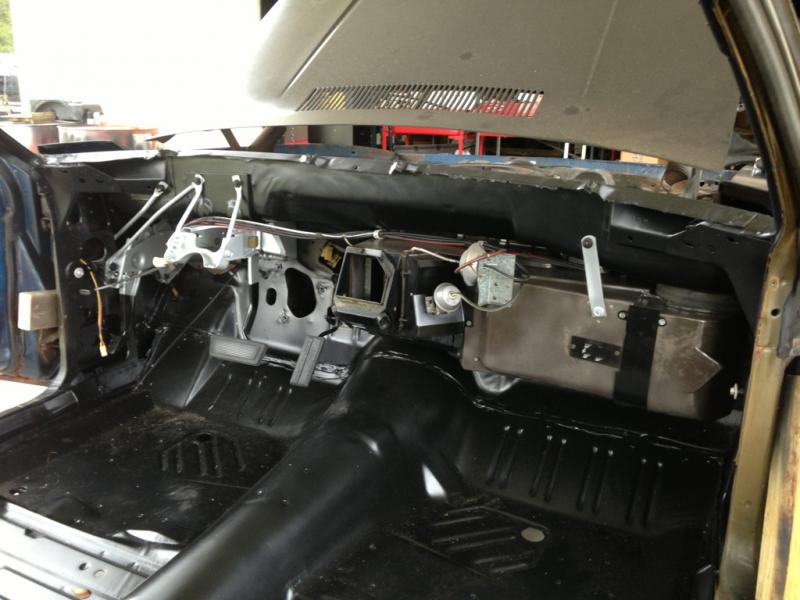

Dash is Back in !!!!!!!!!!!

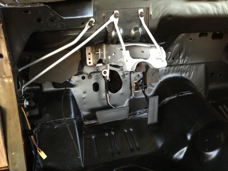

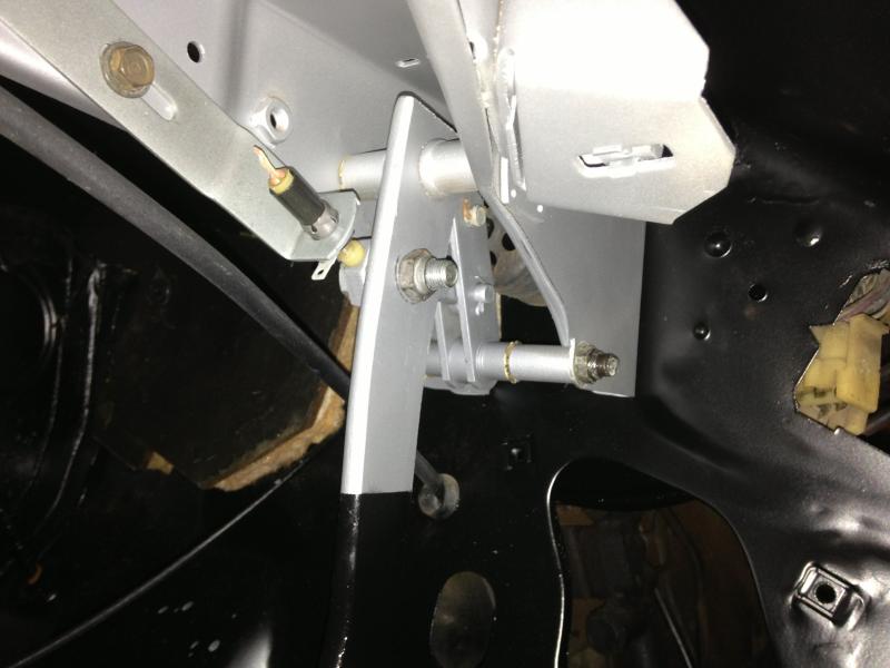

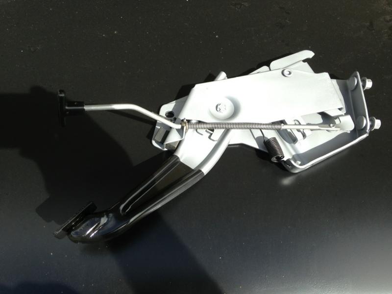

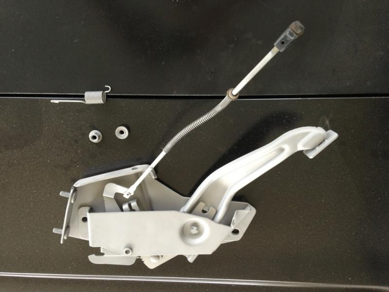

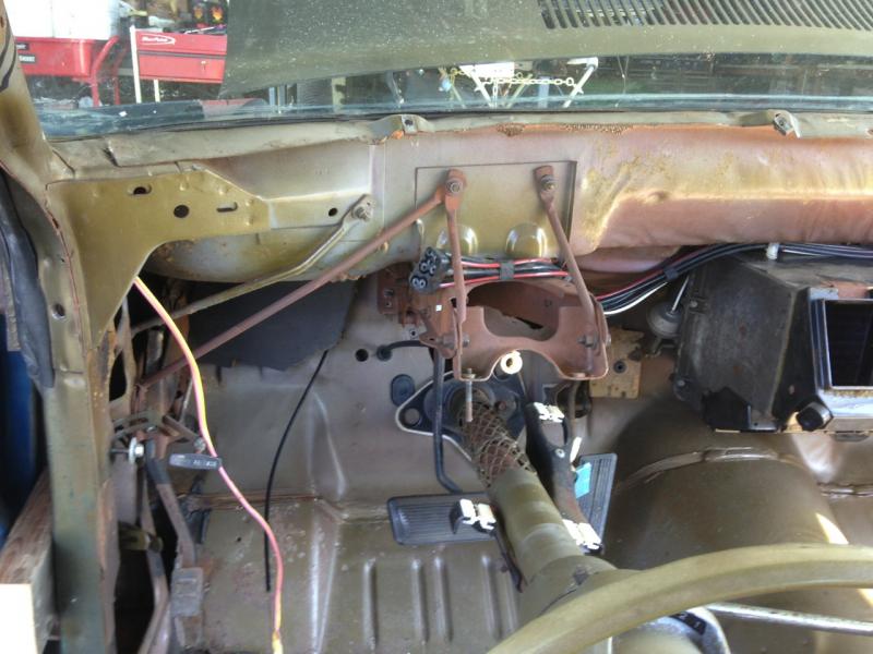

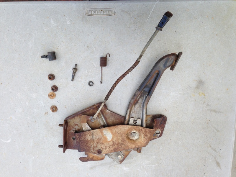

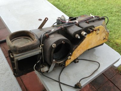

Today went better than expected. I was able to disassemble and glass bead the emergency brake pedal. This was followed by detail painting and reassembly.............

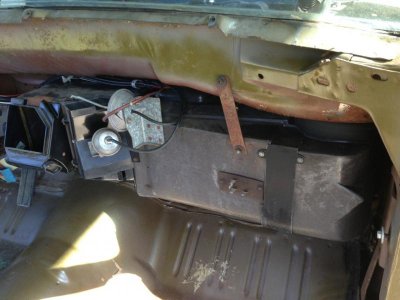

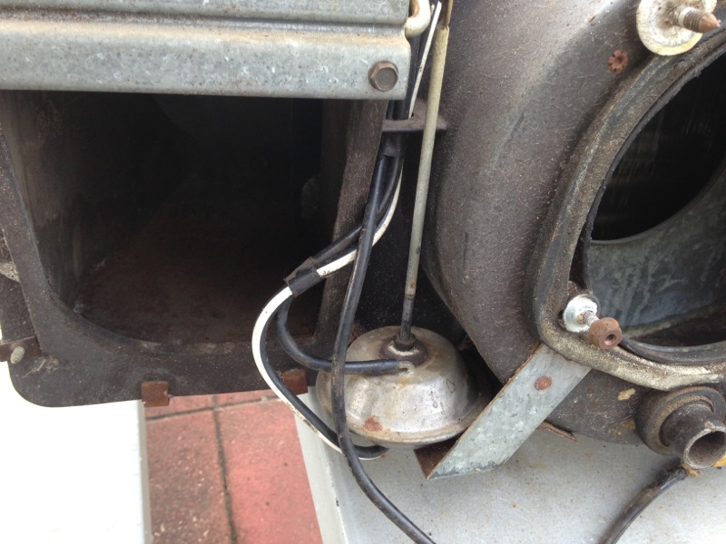

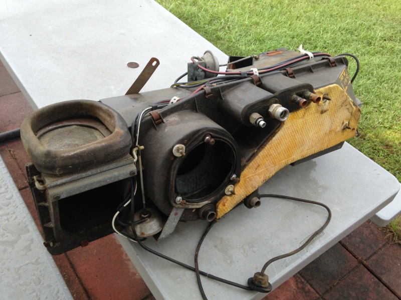

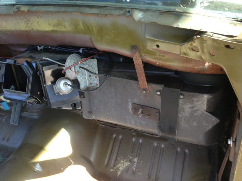

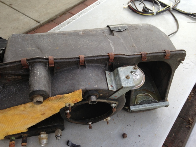

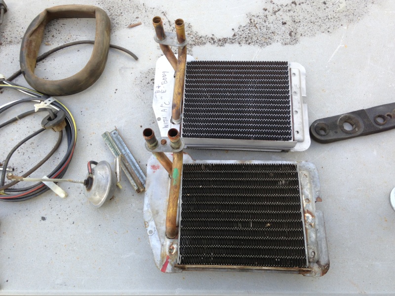

Then I started taking the heater / AC box apart for a good cleaning too.
The old original heater core is on the bottom.

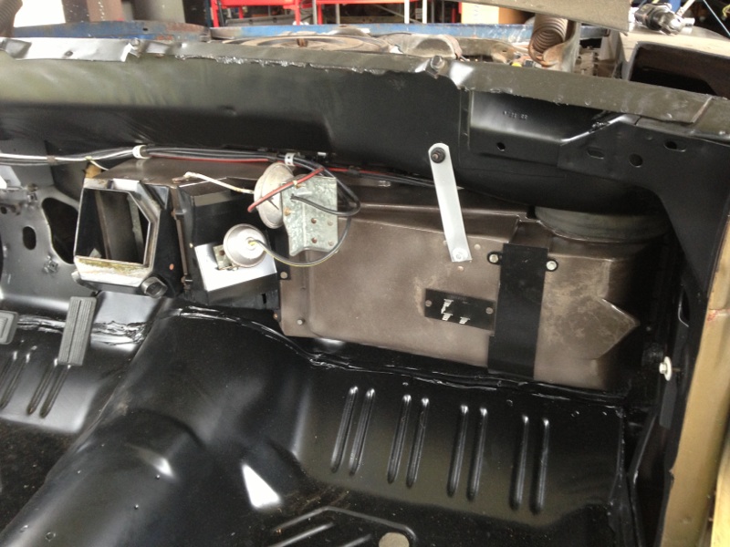

Then once everything was cleaned / clear coated the box was reassembled and installed back in the car.............
Then the emergency brake pedal was reinstalled.............

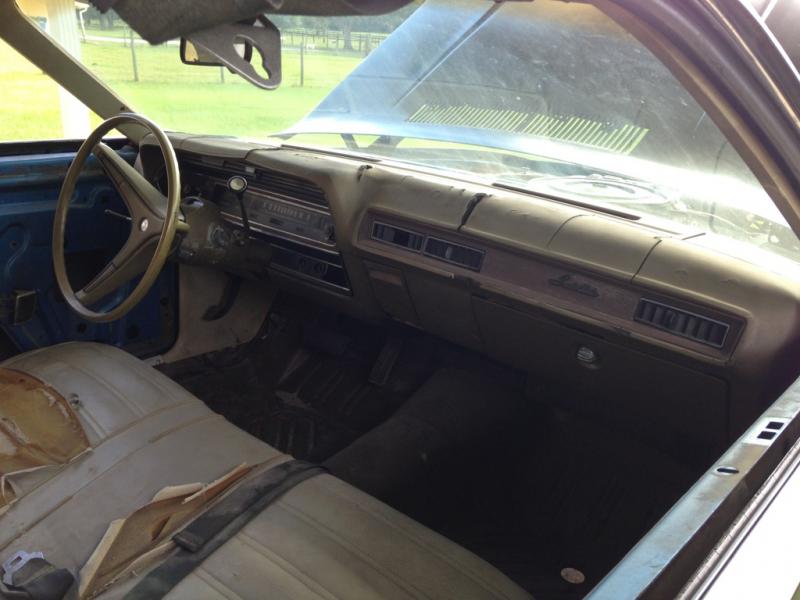

Followed by the dash assembly..........................
The dash is SO much easier to install with the windshield out. It only took me about 10 minutes to bolt it in place and connect everything back up to it.
Hopefully tomorrow I can clean / paint/ install the ash tray and glove box liner and door. Then I will be bolting the original steering column back in for now just so I can drive the car off the front ramp of my shop. The column will be coming back out again shortly. I need to go through it and convert it over to a floor shift version. As promised, there will be a detailed write up and a bunch of photos when that task is being done.
here is a little before and after..............
IMG_3870.jpgView attachment 150091

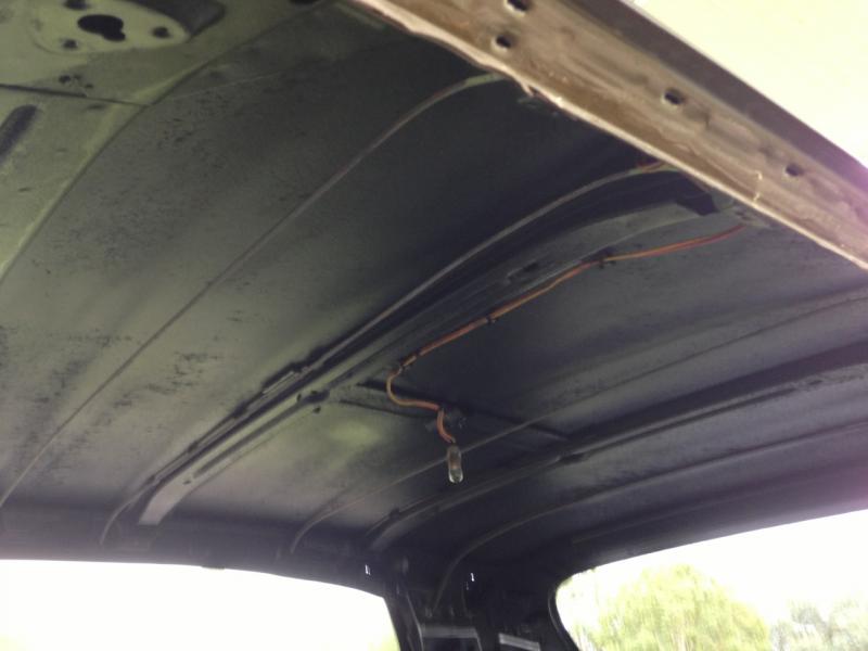

And one last thing........... The 4 headliner bows arrived today. I installed them to make sure they fit. (which they did).

Does thinking that parking brake is beautiful make me weird?
Nope, not at all. Just a die hard MOPAR fan !!!!
Thanks !!!

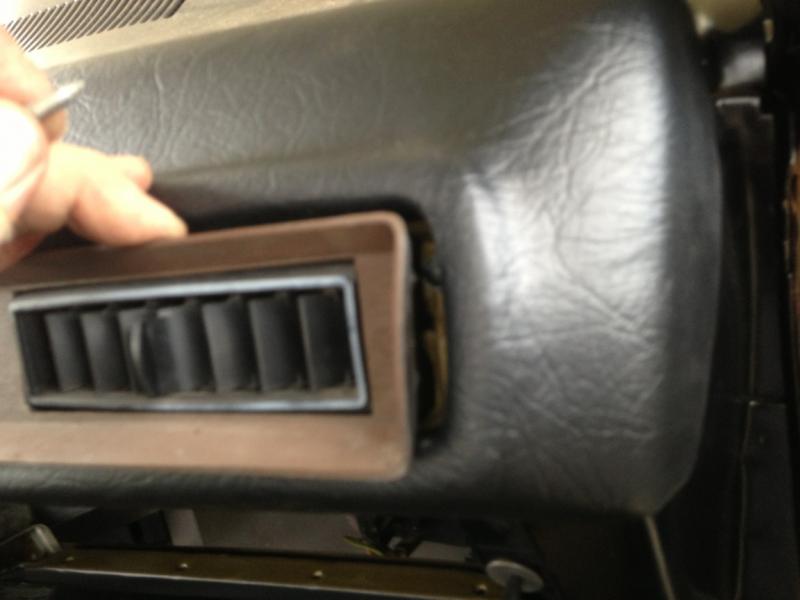

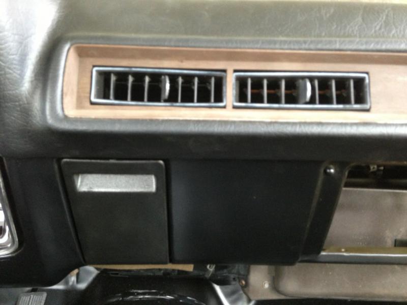

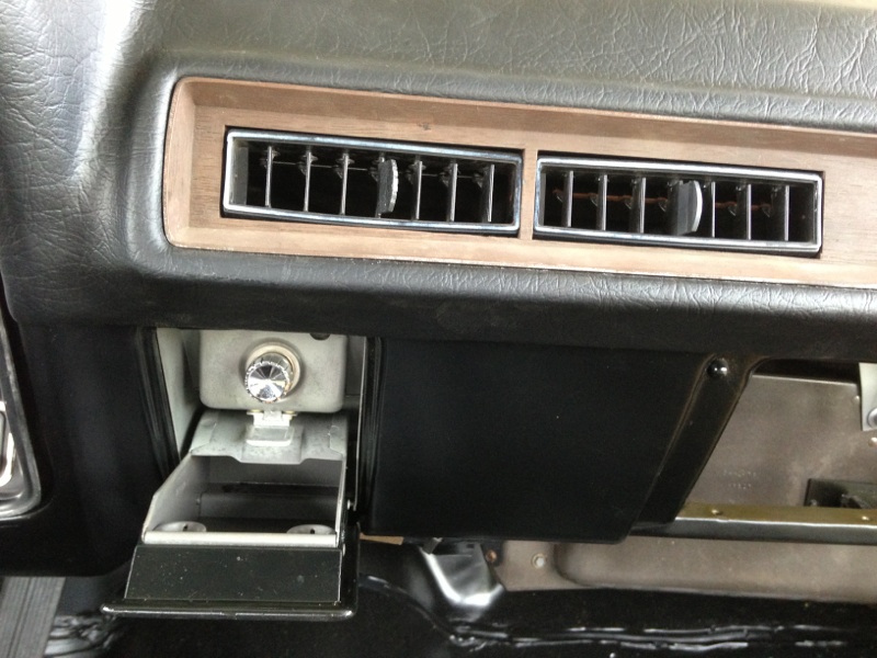

Today was spent trying to fix the dash vent louvers. I had several extra sets from a Duster, but they did not fit. However I was able to take the assembly apart and use the vertical fins on the 72 dash.
This involved taking the dash back out again though. I never would have been able to gain access to the vents if the wood grain bezel wasn't removed. Even after the bezel was removed it was a major PITA to try and swap the vertical fins over.
Everything was buttoned back up and I started working on the ash tray and glove box door.
If you look very close you can see the slight difference between the fins from the Duster and the originals.
The Duster verticals are on the left side. The connecting link is higher and the center one has knurling on the edge to assist with gripping the part to change the air flow direction.
But hey, this car will be driven.

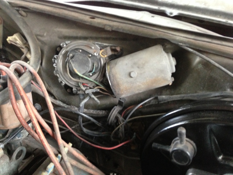

When I bought this car the wiper motor and linkage were missing. I had an extra linkage from an E body car. I knew I had a spare 3 speed wiper motor............. somewhere.
This was bothering me so I just had to find it. After a while I searching for it, I found it stashed away. I bolted it in position and connected the wiring harness to the bulkhead connector. Once the steering column is in I will test it to see if it works.

When I was installing the ash tray I heard a "pop" and it came from the far right passenger side of the dash. I found out later what the noise was. One screw that secured the plastic wood grain bezel to the dash frame popped loose. This allowed the end of the wood grain part to pull away from the black dash pad cover.
I will probably have to remove the dash again in order to fix this..............
I had the same problem on mine, same place and im trying to remember what i did to fix it, been awhile but i didn't have to take the dash out, ummm, it'll come to me! lol, always something... Seems i bent the tab out a little and got more threads for it in, brain fart here i guess! :(
I don't have air in mine so i cant place what yours is like, it could be different i guess..

It's probably a good thing no little ones were around. I ended up breaking the tabs on several of the vertical fins, both while removing them from the Duster part and installing them on the B Body part. Luckily I had several sets of these laying around. I ended up using most of what I had because the tabs kept breaking.:angry1::angryfire:
Once the fins were in place, I had to heat a small screw driver tip and melt the ends over on the small tabs to keep the center alignment link in place. The A body alignment link was plastic while the B body one is metal.
Believe me, after several hours of this my patience was wearing thin. I'm sure I uttered a few choice words along the way !!!!!:o
Overall it wasn't much fun............... But it's done now.:hello2:
That's a good idea Ron. I will look at it hopefully Saturday AM and see what can be done. Part of my dash problem is the little metal cap that is pressed on a stud on the wood grain dash bezel popped off. The plastic stud is still OK, and the cap has the screw still inside of it. When I try to loosen the screw, the whole cap turns freely. I have to figure out a way to hold the screw cap while I remove the screw from above / behind the glove box.
Thanks brother. Meanwhile, if you remember please let me know how you fixed yours.

Louis, I seem to think my glove box was out but im not sure.. BUT, i have my old Satellite bezel in my radio room (My indoor cave) and i was looking at it, IF you can push the bezel into the cap, could you put some super glue onto the plastic stud, push it back in and once dry hopefully it will work, maybe stay in place, i didn't think of super glue back when it happened but i used something and im thinking it was JB weld, that stuff takes longer to dry but works well..
I had things like this happen a few times and sometimes if i had help pushing it in and holding it, i could unscrew or take a nut off while its being held tight against it. I hope it works out for ya and im sure you'll get it, i wish i could think of something else to keep you from having to take the dash out, that would suck!
