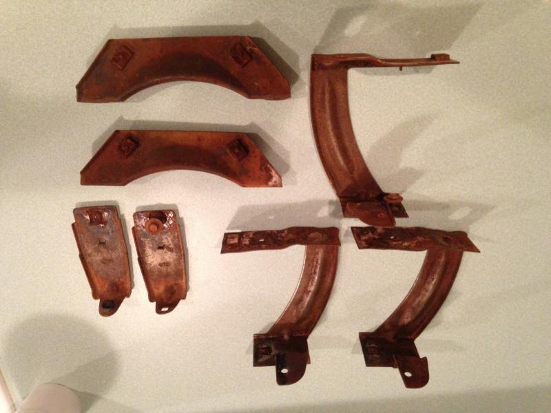

Earlier today I got with Mopar Mark to see if he had a better set of grill mounting brackets because the ones the misses cleaned have some major pitting.
He had some and hooked me up with a good deal.

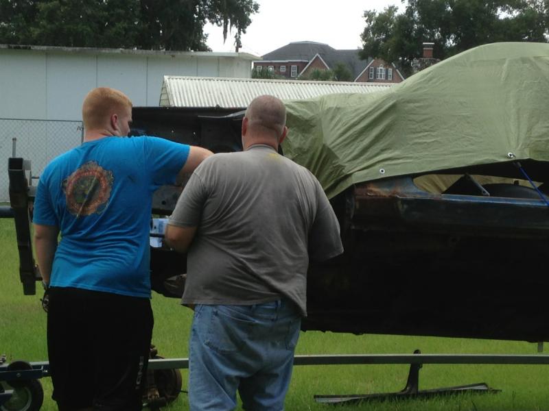

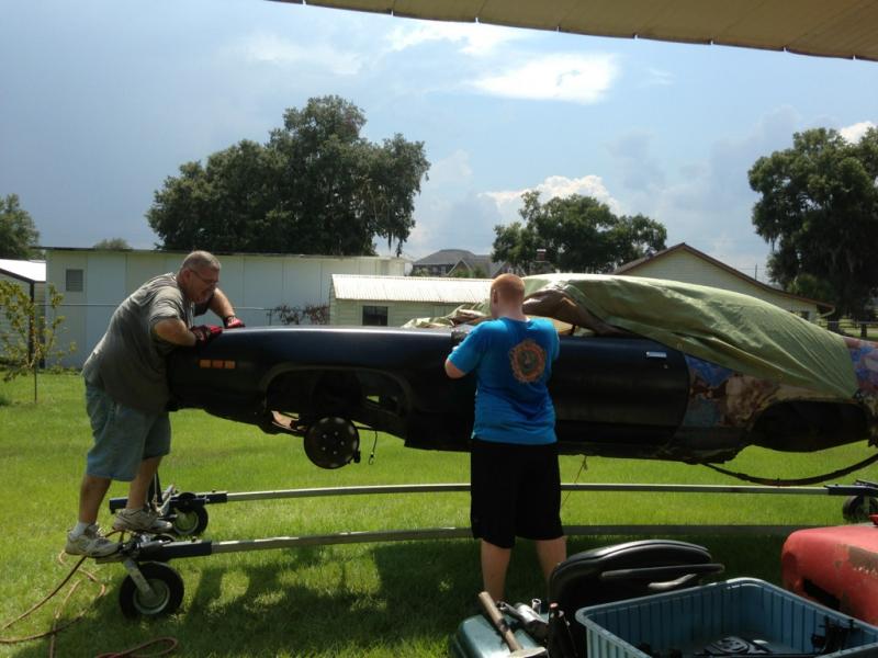

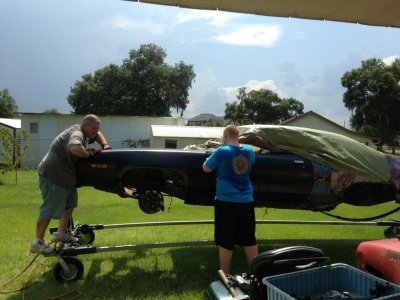

So "Camsdad" and his son came over today and started reassembling the B-5 RR for me. I was like a band conductor showing them where the parts were for the car. They took car of the rest. They made some good progress on bolting the car back together today.
They bolting in the K frame and front suspension, then installed both doors and front fenders.
The rear leaf springs and gas tank are back in now as well.
As soon as the rear end has been installed, they can mount the wheels and off the rotisserie it comes.
(so the blue 73 Challenger can take it's place)
Then they can install the 383 and automatic trans, dash and steering column.
I will then take a lot of good photos and list it for sale. So if you're interested, shoot me a PM...................

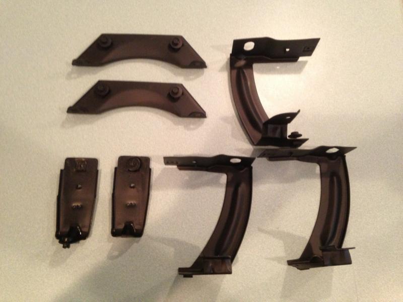

The grill brackets that I got from Mopar Mark arrived today. I am VERY happy with the quality of his parts. A quick trip through the glass bead machine and they will look like new. They have a little surface rust which should clean up nicely.

Grill Brackets Finished

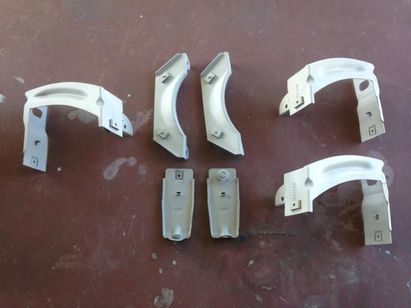

Yesterday while I was at work, the misses glass beaded the brackets that I purchased from Mopar Marks. They turned out great, and look brand new.
Before picture
After Glass Beading
And after painting. I am very happy with how they turned out.

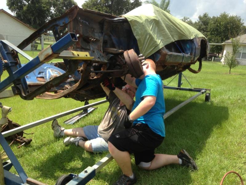

This afternoon Hagen, his son, and brother in law came over. They bolted the rear end housing back in the 71 RR, and did some other stuff car related for me.
Thanks fellows !!!!!!

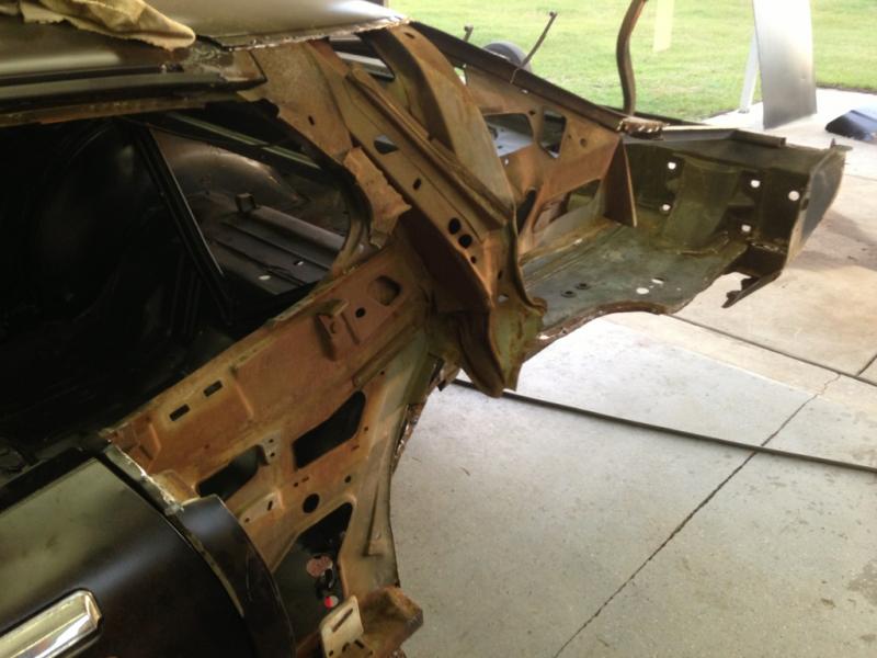

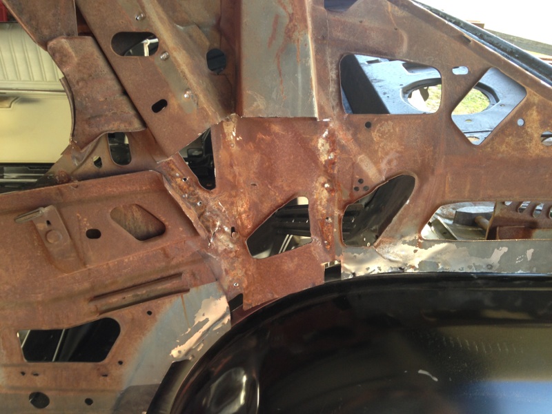

I'm looking to see if he has some more sheet metal that I will need for the 72 SSB before the rear quarters can be welded back on.

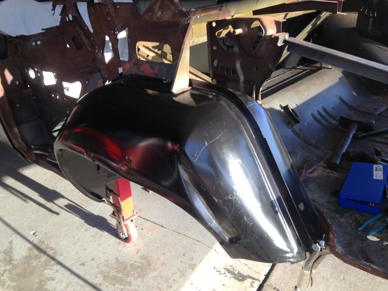

Here is the area I'm talking about. Its the inner roof reinforcement, and goes from the outer wheel housing up to the top of the quarter panel just behind the drip rail on the driver side.
I was going to fab this area out of 16 gauge sheet metal, but it looks like the driver side is a little different from the passenger side, and I don't have a pattern to start with.
It kind of looks like a big "Y". I cut the crumpled section off a while ago.
It gets spot welded to the top of the outer wheel housing.
It would be killer to get the inner sheet metal along with the "Y" part, since I had to hammer on this section that is behind the sail panels to get the area close to being straight.
This is an old photo I took last winter. Hopefully by this winter the new AMD sheet metal will be on for good.
