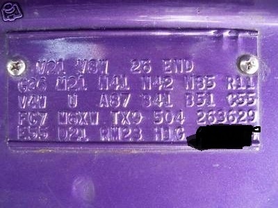

when I bought my roadrunner ( 340 4 speed ) the guy I got it from said the car still retained the "original " running gear, said something about a shortage of 8 3/4 diffs at the St. Louis plant and it had a 8 1/4 possi diff that he said was a 3:23 ratio . I want to keep it original if it belongs to the car so the big question is would a 71 340 b body come with a 3: 23 possi 8 1/4 diff? its a late build date (504) with a lot of 72 parts
IRC didnt the St. Louis cars have the rear listed on the data plate?
What's "A87"?

The owner swore up and down it's never left his sight and he didn't touch it . so you never know but to be correct 8 3/4 because it's correct!

All 71-73 HP B's should have the 8.75. I think it is possible that they may have been short on 8.75 and through in an 8.25 instead. Hard to know for sure without the broadcast sheet.
I'd be looking for an 8.75 to put in it.
