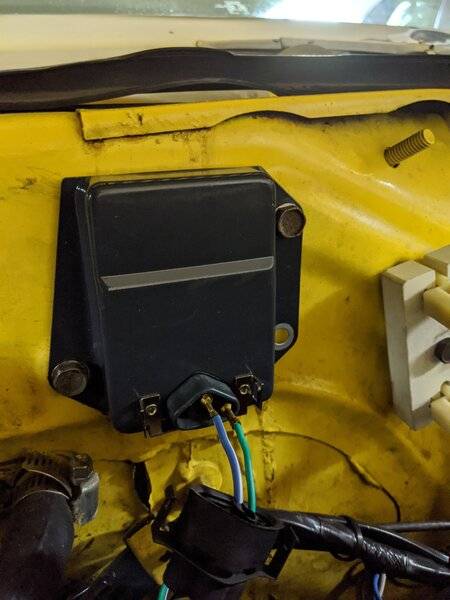

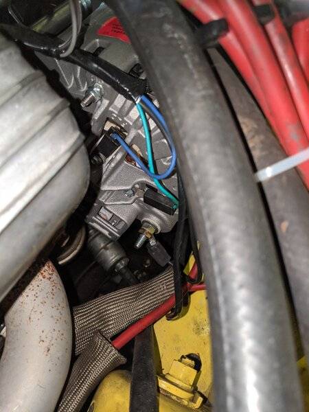

Well, I got stranded with a dead battery. Nothing too odd on the drive. Battery tested out with some volts but was dead charge.
Jumped the car to start and pulled negative. Car stopped immediately. Figured it was the alternator. Bought a new one even though the old one tested good.
Car still stops when I pull the negative. Figured it was the voltage regulator, replaced.
Car still stops when I pull the cable. Looking for ideas please

Couple of things,
1. make sure you have a good ground on the VR
2. closely check your cables

Couple of things,
I sanded down the firewall before adding in the new VR and wire brushed the bolts.
I don't see anything in the cables, ground iis to the front of the car and to the engine mounts.

There should be ground cable wire going to the engine. Small blocks to the head b & hemi motors to the front of the block.

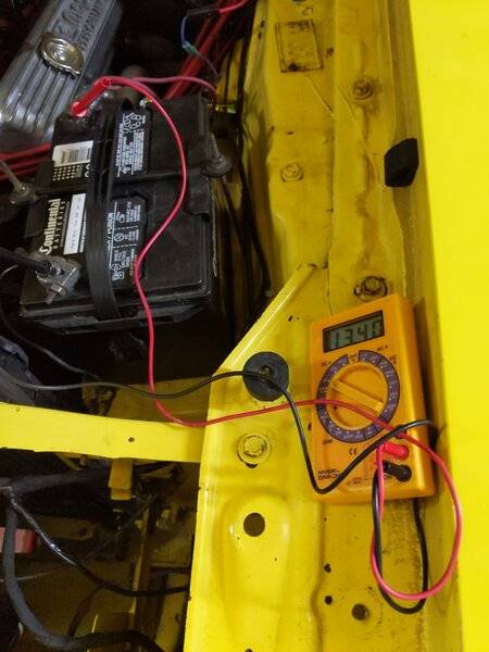

14.6 to batt while running
Still climbing, up to 15.19
13.5 at rea
you are looking for 13.8 to 14.2 while running at the battery clamps. the voltage regulator relies on body grounds from the battery to the body. make sure there is good clean metal to metal contact at all grounding points.
it may read high at first if the battery is low.
