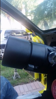

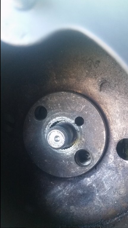

I recently bought a floor shift steering column for my road runner to replace the broken column shift one that was in the car since i purchased it. Transfered everything to the new column and installed it into the car with no issues. That is until i tried to reinstall the wheel adapter back onto the shaft. It will not go more than halfway down the splines. I have made sure i lined them up with the master spline and cleaned everything free of debris. But it will only get to about 2/3 of the way down on the shaft. It was removed from the old column and now it wont go back on that one like it was either. No visible damage to the splines. Any help woulf be greatly appreciated. Thank you
Here are 2 pics to help out

It will not go any further down with out what feels like potential internal damage.

Has the shaft got one master spline or two? They may not be the same size. If it came off it will go back on. Do not force it.

i would wire wheel the shaft splines as clean as i could and inspect them closely
and then run a file on the inside splines, maybe even steel wool on it.
there could be a burr there or even rust build up holding him up.
at worst case it might of been gorilla-ed off at one time and the can distorted
hard to know without it in your face.

hey everyone, thanks for the help. I will try to clarify some more details. yes the problem is from the adapter/can not mounting all the way on the cabin side of the steering shaft. also i am matching the master spline up every time. the splines are good and straight. i cant see any reason why its getting hooked up on the mechanisms inside the collar. it just goes on with the nut about 2/3 of the way down and comes to an abrupt halt. I bought the car with that part and judging by past experience its probably a bad repop part. thanks for all the help just wondering if anyone else has had this issue.
