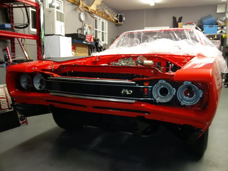

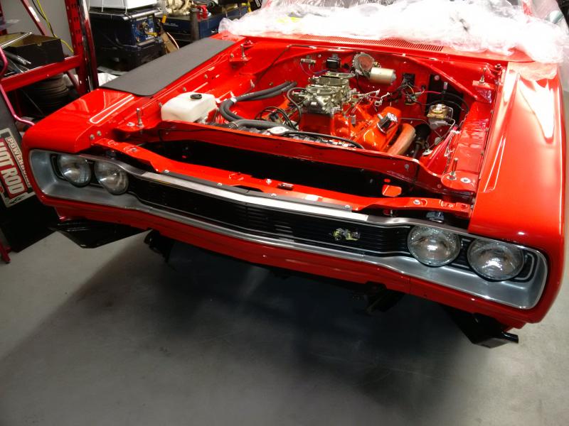

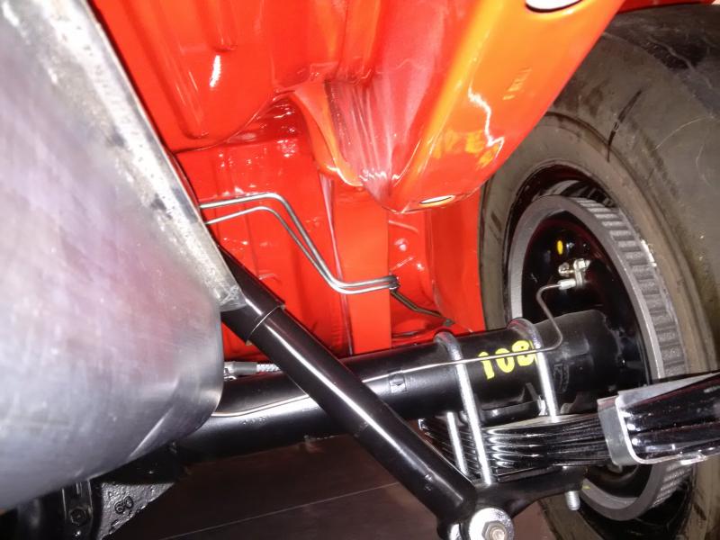

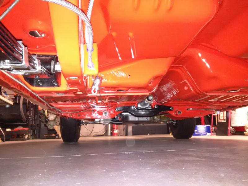

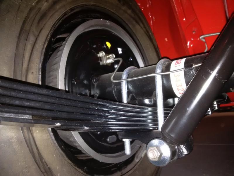

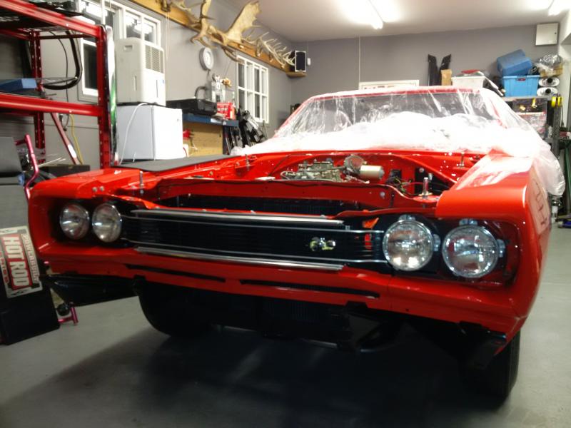

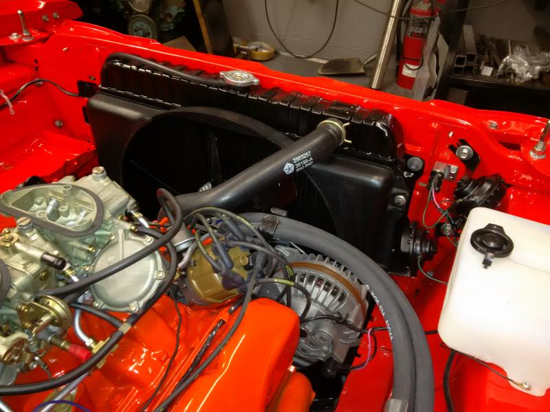

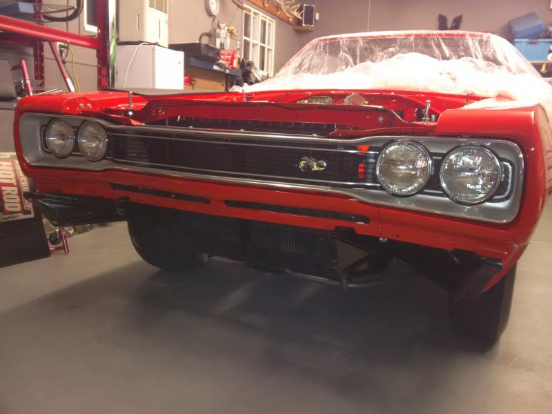

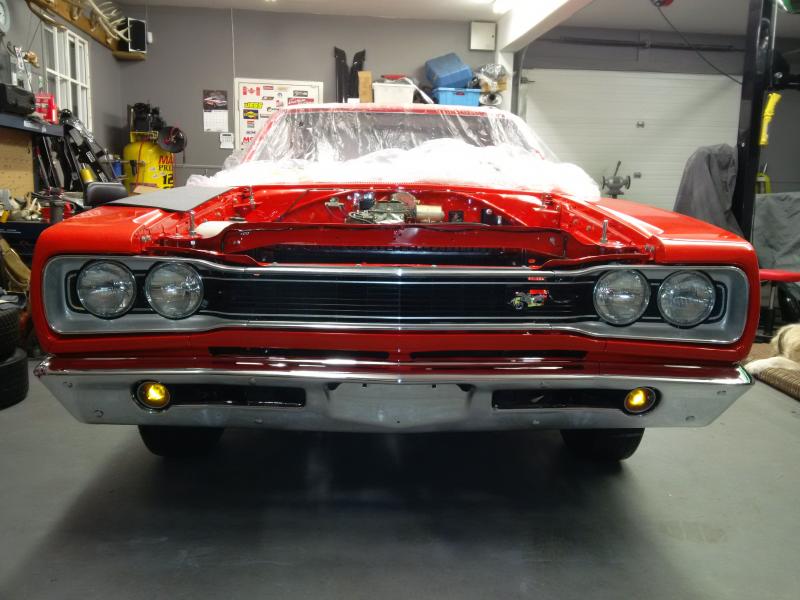

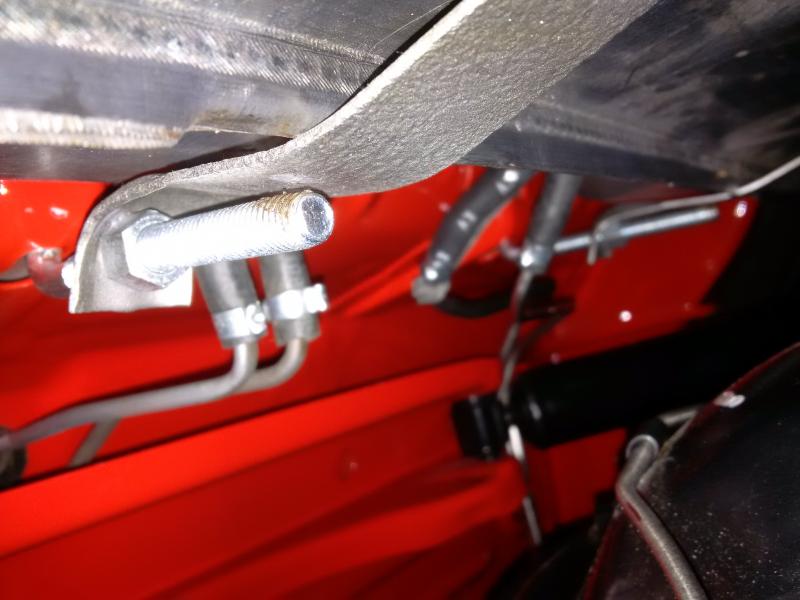

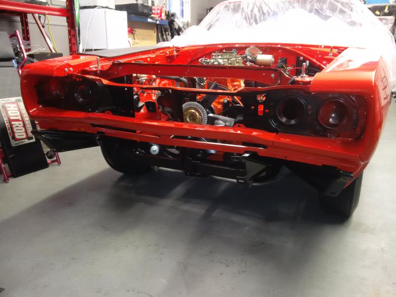

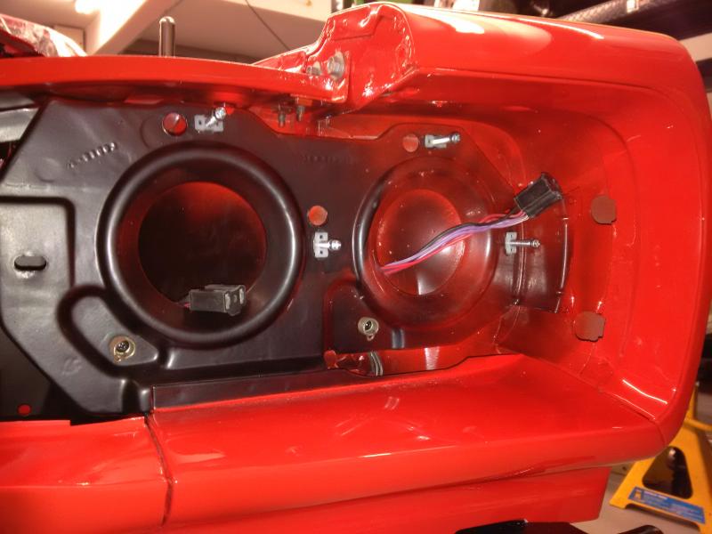

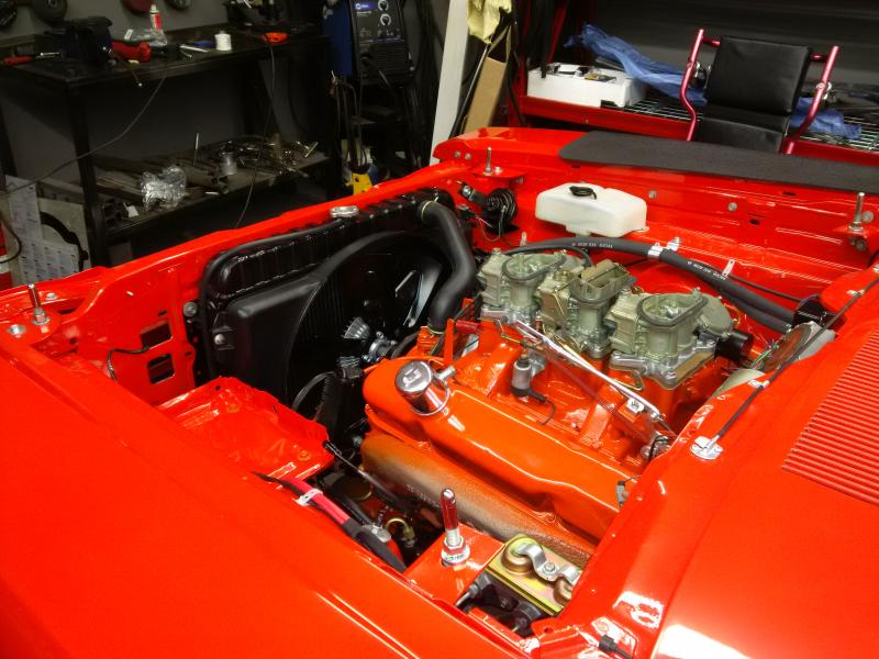

Got to spend a bit more time during the holidays between visitors and beverages, Fuel and vent lines put in place,front end coming along now, feels good to be putting these parts back in place. Blacked out the grill opening, maybe a little much but i think a little more is better when it comes to this. Should have the grill assy in place this week doing a little resto on the headlight pots and trim then on it goes. IMG_00000090.jpgIMG_00000092.jpgIMG_00000094.jpgIMG_00000100.jpgIMG_00000110.jpgIMG_00000111.jpgIMG_00000115.jpgIMG_00000117.jpgIMG_00000118.jpg
That's a great looking restoration job :headbang:

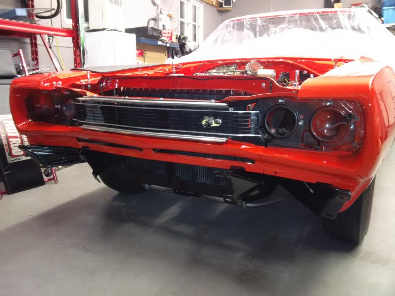

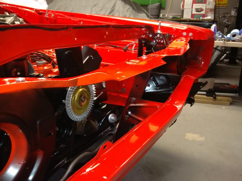

Thanks for the kind words on my resto project, little more grill work done last night--- some assembly work just puts a smile on your face when you stand back--this was one for me.
Thanks for that Boise, well thats about it for the front just have to touchup paint all the the bare metal fender bolts etc. Now its on to wire in the electronic ignition and hide the module under the battery tray, have the dual point distributor which I will squirrel away for another day.IMG_00000134.jpg
Great looking job! Did you buy or make the brake and fuel lines? If bought , where too and would you recommend stainless or mild steel? Thanks
Hey Dean, I personally like to go the stainless route as it looks very clean and I will never have to worry about them again but it dependends to what level of restoration you are going after, if you going to a factory pure resto then you would go to steel tin coated lines. In Line Tube supplied my lines and parking brake cables, the fit was OK--they can supply either. you can Goggle the name and check out there stuff. Good Luck with your build.

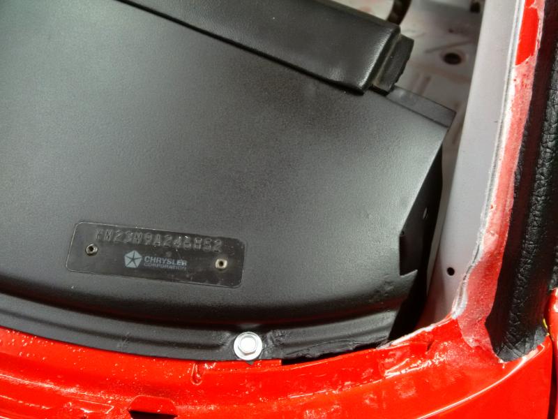

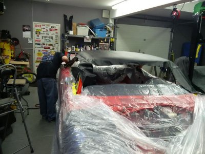

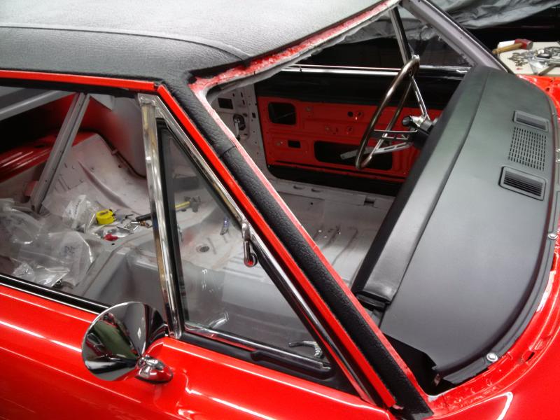

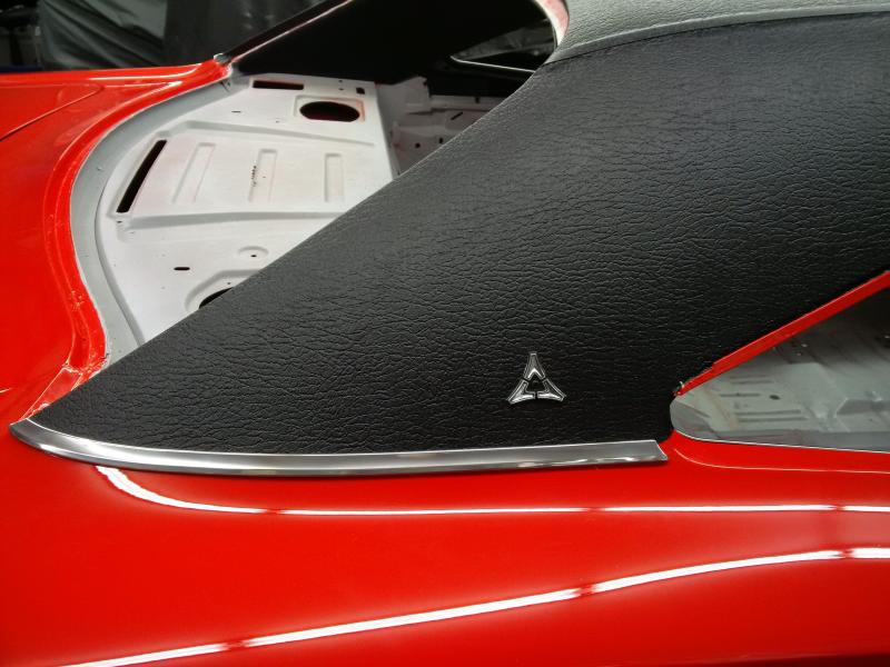

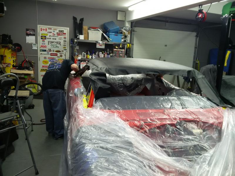

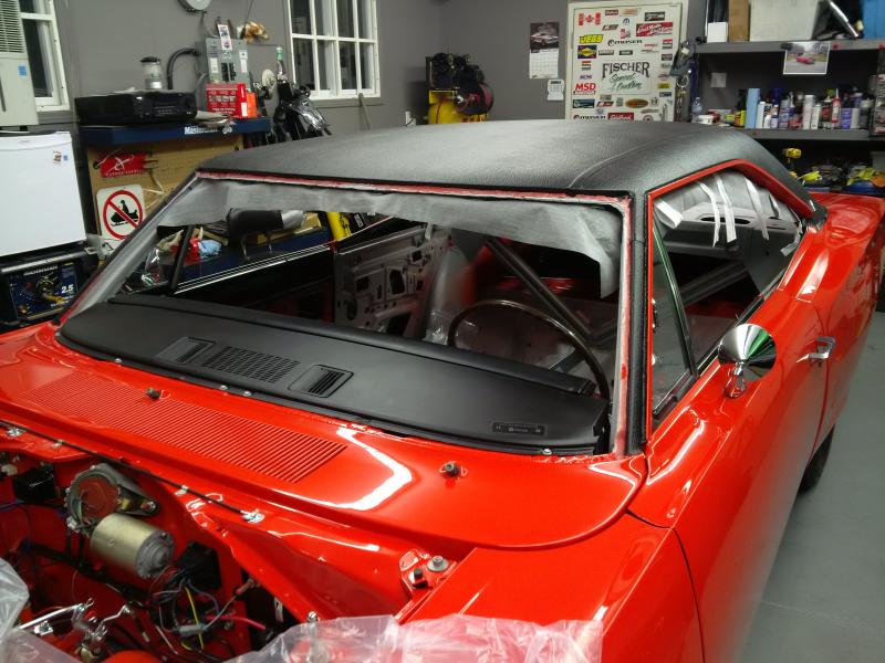

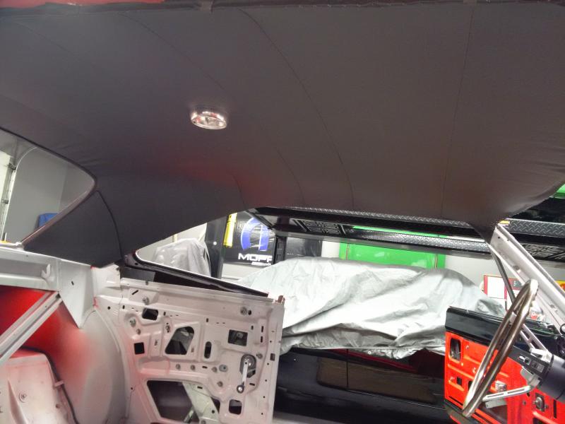

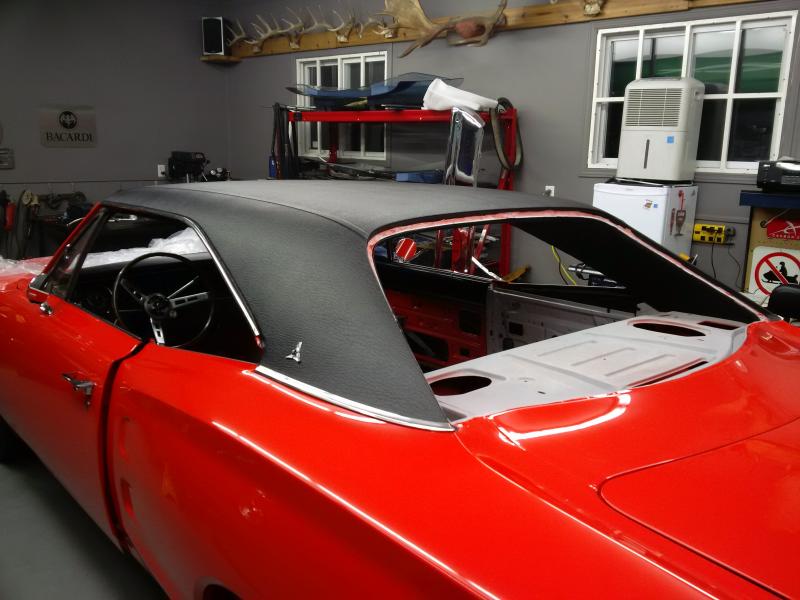

Got some vinyl happening,with some help from a dude who's done a few of these tops and it turned out pretty nice, he used this spray grade synthetic rubber contact cement Helmiprene 1685 it has a fast dry and long open time to work within also high temp resistant for those hot summer days,buys a cheap 19 dollar spray gun and chucks it when he is done--kool stuff, also got the head liner in and the sail panels which were a bit of a pain to fuss with--now I can move ahead with the glass and interior.IMG_00000141.jpgIMG_00000150.jpgIMG_00000151.jpgIMG_00000154.jpgIMG_00000156.jpgIMG_00000158.jpgIMG_00000159.jpg
headliner and vinyl look great! i had an old pro do mine as well it is awsome to watch them install the vinyl it loos so easy but i know if i did it it would be bad!
Amazing car, I'd love to have an A12! I think two yellow lights in the high beams would great too!
wow that's looking very nice ,and you have a nice set up in your garage also thanks for taking the time to post updates
