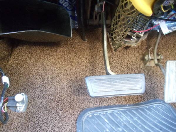

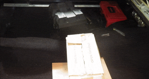

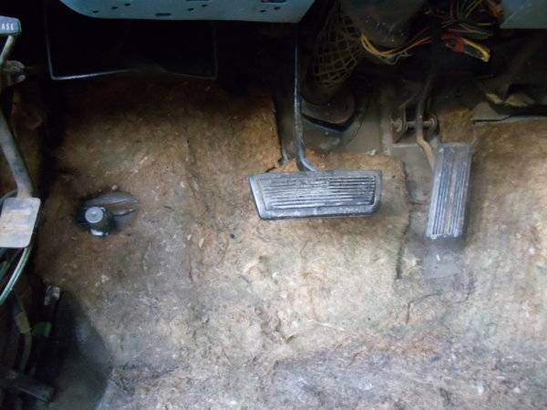

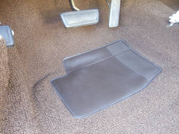

My installation in a '72 SSP was not perfect, if you feel around you can find where it does not quite hug the tunnel, the corners, and dips. But just looking at it, not too bad. I used the foil/butyl type insulator AND a hard foam type insulator over the top of that, so the floorboard did not mimic the factory floorboard exactly. The funny thing is during a 100 plus degree hot spell driving on the freeway, it was cooler in the vehicle with the floor vents closed and the windows open than with the floor vents open. First foto is showing the extent of the old (now discarded) factory insulation. Next two fotos show new carpet after recent installation. It looks a little better now, after the carpet had a chance to "settle in". Floor mats cover most of it up anyway. (My carpet was in the box for a year or so, not a good idea)
