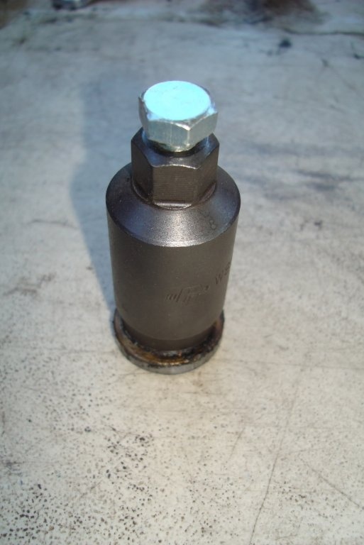

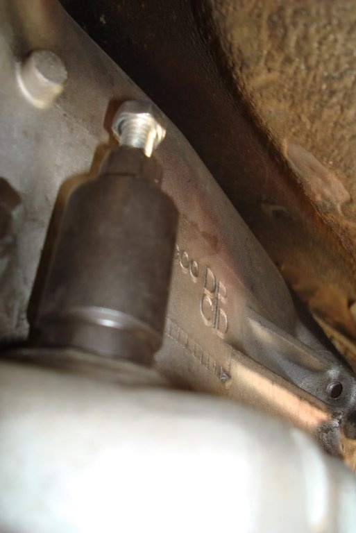

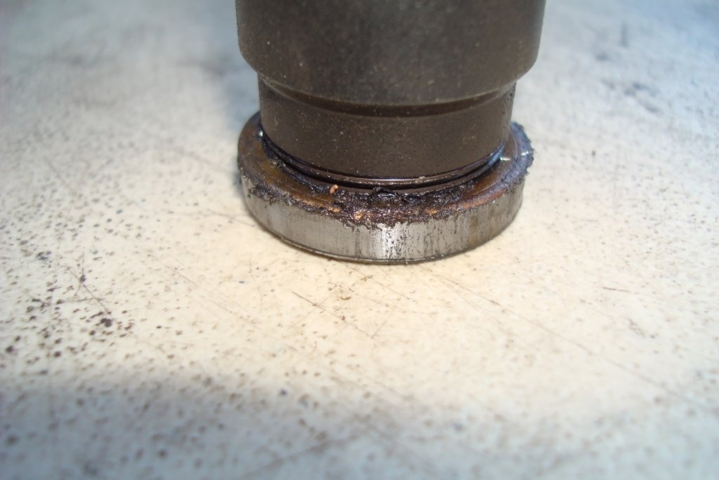

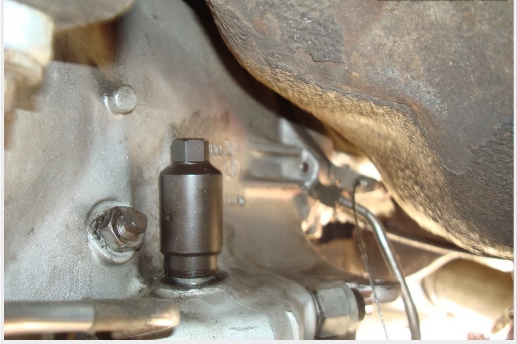

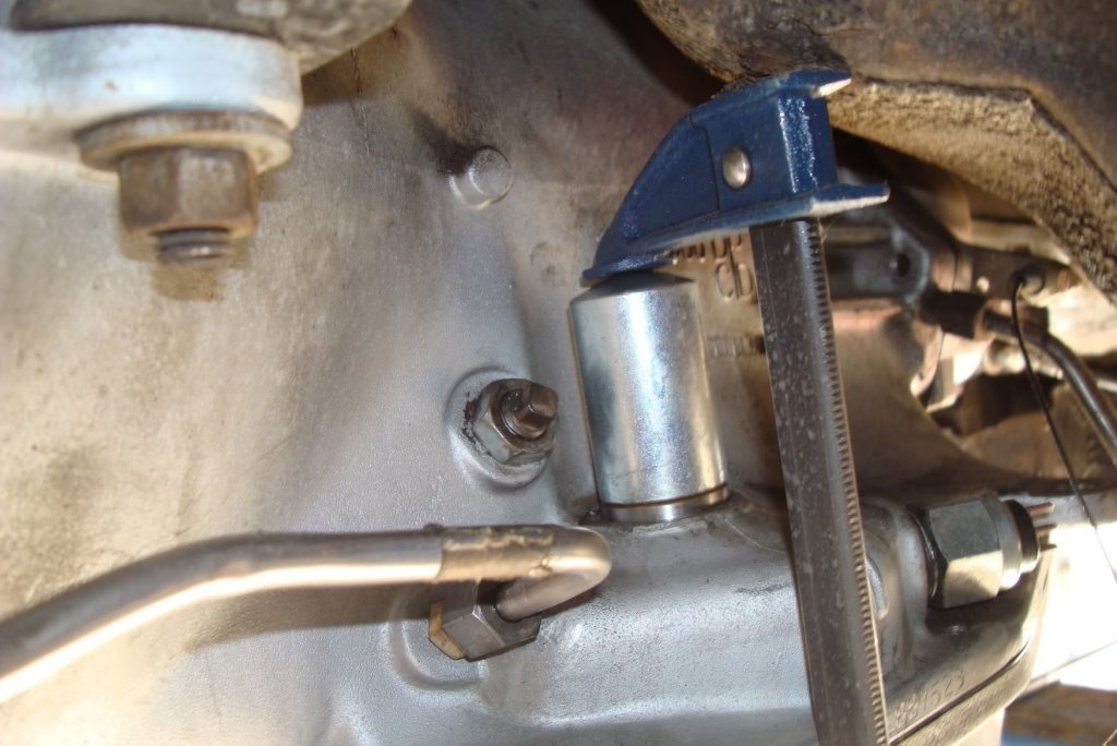

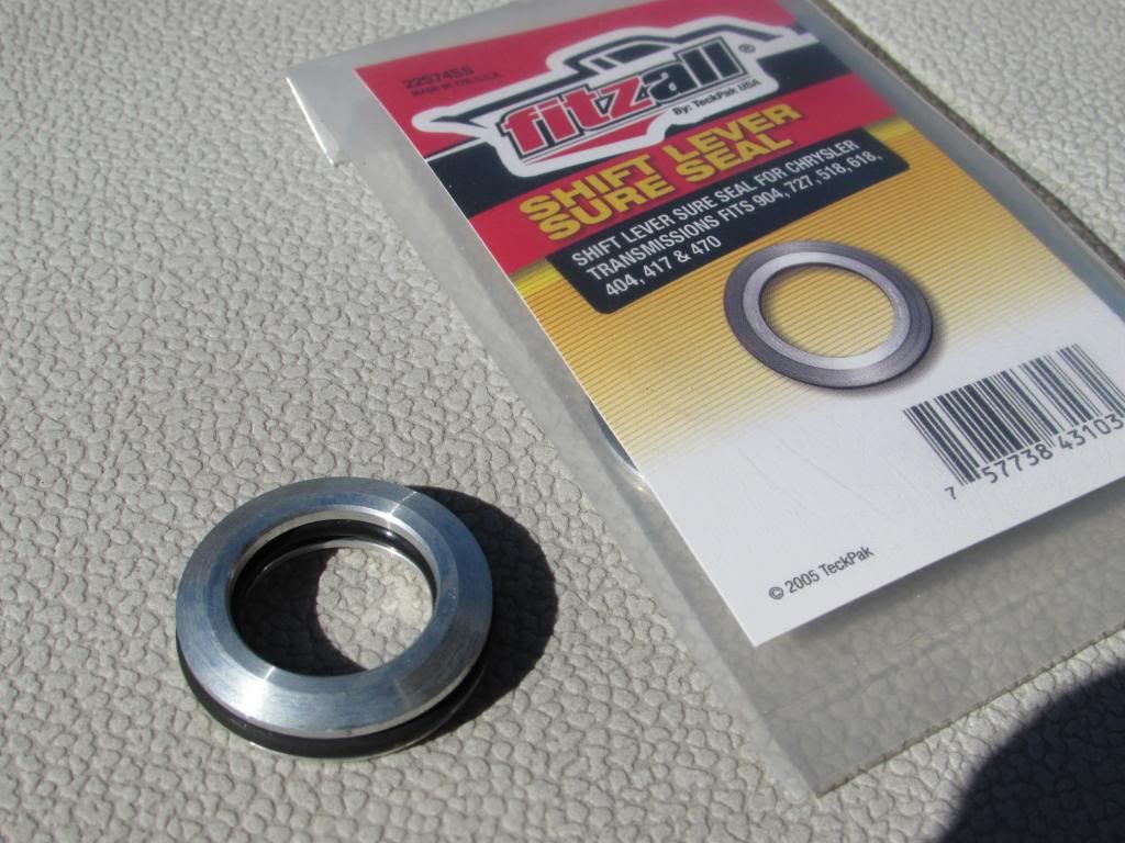

Selector shaft seal.
Mine was leaking there too, took 15 mins to change out while the trans was still in the car. The hardest part was laying on the floor.

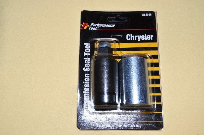

Use this tool.

on my Dad's GTX, the valve body had a groove from wear in the area where the seal was. I guess from the seal hardening up over the years, it wore into the valve body. They do make a repair seal which is an o ring design vs. the angled seal with the spring inside it.
With the trans in the car looks like the only way to go. I replaced my seals when I dropped the valve body to put in a shift kit. The trans was still in the car. I just knocked the seal out from the inside.
