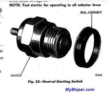

Is this seal just a metal “conical” washer, or is there supposed to be rubber molded on it?
no seal, as you torque it down it will create a seal by digging into the last thread. Make sure not to over torque it or it will leak. I believe its 24 ft/lbs but check to make sure. good luck.
Thanks. One time use, or is it reusable?
The seal is aluminum with a thin layer of rubber/plastic over it. I have always reused them if they are not torn up.

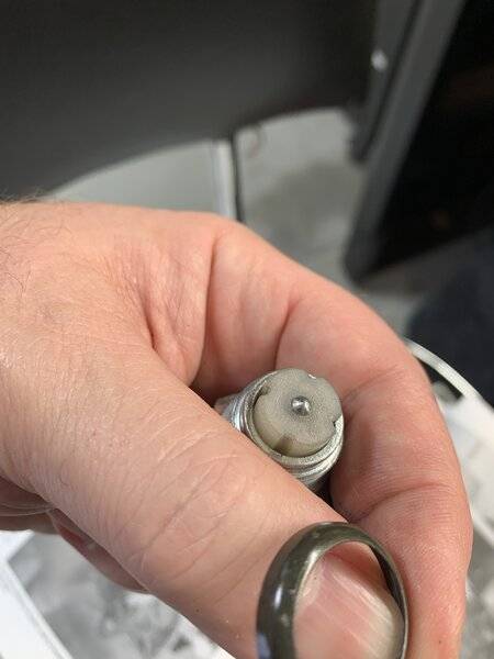

So some seem to have an over molded rubber. I had my trans rebuilt at a shot and this is what came back under the safety switch, but not tightened yet.
Yeah, me too. That’s my concern with what I have. I’ll just order up a new one. Thanks.
