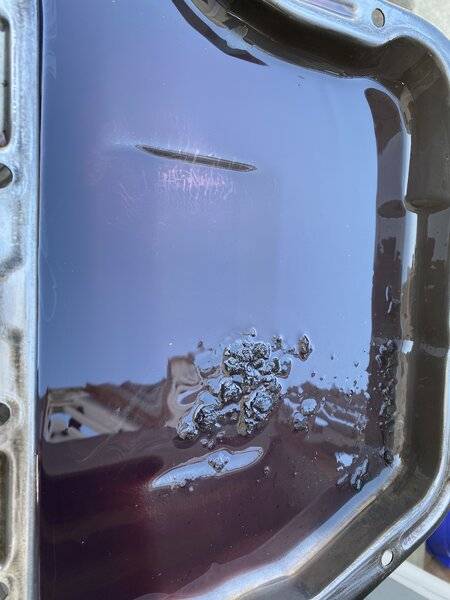

No, don't waste your time in trying to flush a converter. Crap can get jammed up in the pump vanes of the converter and once there, there they remain. Get a replacement converter and don't forget to get the transmission cooler in the rad cleaned out or by pass it with a large quality cooler. B&M doesn't make them, but they do offer a "stacked plate" style cooler. These are the best type of cooler.So now that I have confirmed my 727 is the original to my 67 Coronet RT I want to purchase an overhaul kit. From your collective experiences what company makes the most complete and best quality kits?
Can torque converters be properly flushed or being my pan was loaded with band flakes and fine metal should it be junked?
