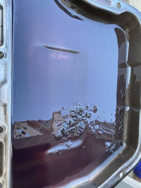

Can torque converters be properly flushed or being my pan was loaded with band flakes and fine metal should it be junked?
You can get stock converters from places that sell "Transtar" transmission parts. But, to answer your question, rebuild trans and replace converter. A lot of kits will include a front band, but you will have to purchase a rear band separate.
If you have a lot of material in the pan, I'd be very suspicious of TC condition. Evidence of band material indicates a complete overhaul. I have used parts from John Cope for several years. He has a great selection of parts.

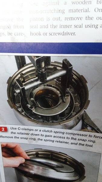

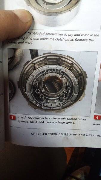

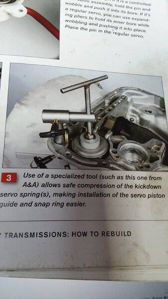

Next thing I’m looking into is what specific tools I would need to purchase. I have picks, full set of snap ring pliers. I bought both popular manuals already from the net. I gather I will need a tool to compress the clutches in the hubs. Is there a tool made or a method used to guide the seals into their respective bores without damaging them? I’ve also seen slide hammer setups to remove the front pump and guide studs to re install.
You will need a spring tool for the front drum. I made my own. I've never used a slide hammer on the front pump, Just tighten the front band good & snug, remove all the bolts from the pump, find the two holes that are threaded for larger bolts, get a couple bolts a few inches long with big washers, thread in finger tight, use a crow bar to gently work the pump out.
