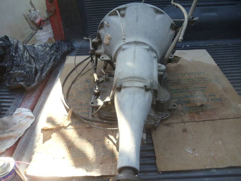

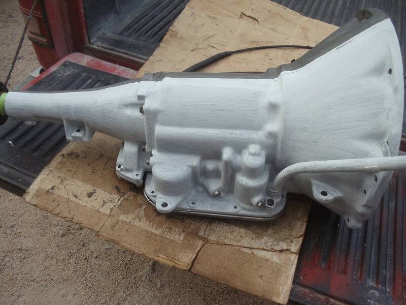

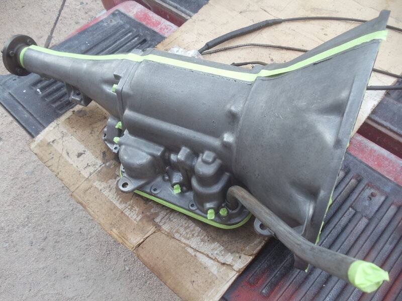

I cleaned my 904 super well and then used RustOleum Clean Metal Primer with a brush no less. Just wanted a light color (white in this case) to keep tabs on any leaks. We will have to wait and see about longevity. I cleaned it with either Naval Jelly or Ospho which for me gives it kind of an acid etching to aid paint adhesion.
