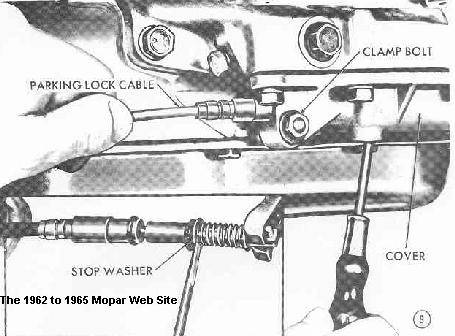

Something to consider is the 60-64 and 65 cable shift units are adjusted differently. The 60-64 is adjusted while an assistant is holding the button in reverse. The 65 units get adjusted with the button held in "low".

The pawl assy may be installed so the pawl is being forced into the teeth of the park gear. Remove the park cable adapter housing. You can pivot the pawl with the housing removed. The cable pushes the lever towards the passenger side in park. Also watch there is an expanded area on 65 output shaft just in front of the splines. A standard length 727 yoke is yo long and can bottom on the area. Most need to be shortened by about 3/8".

Sounds like park cable is not disengaging. if you loosen the bolt that holds park cable try to pull cable out if it comes out it wasn't in correctly.
