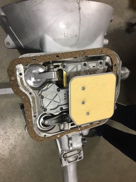

Where would you buy a complete, performance built A-727 today?
Hughes Performance sells them... Check Jegs,Summit etc etc.. But these guys will have better options I'm sure.
Here is a link to Hughes page. We put one in the roadrunner. Had a slight issue with a leak but Hughes stood by their work and paid shipping both ways to make it right. http://www.hughesperformance.com/street-strip-trans/ The only draw back is they come in all black. I guess you could ask for a raw body.

Another option is to find a local Mopar racer or hot rodder that builds transmissions on the side. A buddy did the trans for my 65. We filled it with A&A parts.
Built all my own 727's since 1972. Many thousand bracket race runs. The only 727 I had made from me is John Cope. I have bought the parts from Cope for the last 3 727's I sold to others. They are all happy with the results. A John Cope 727 will work very well for you.
Joe Chrisman of Tranzact Indy Indy. In. 317-846-4933 He builds quite a few in the early case! Also builds valve bodies for street or all out race!
