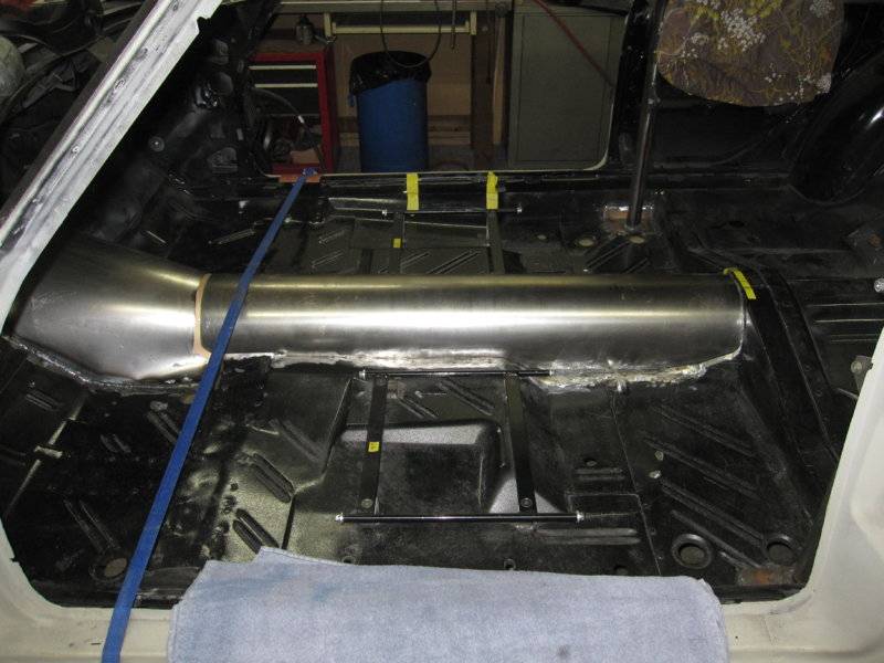

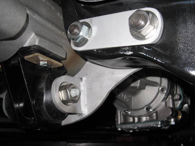

I am using a Altercation front suspension in my 65 Belvedere and I ordered it with B engine mounts but, found out the Indy Max block has hemi style mounts. Got new mounts from Bill and shoved the engine and trans back as far as I could. That led to cutting out my new floor pan trans bulge and fabbing one like DVW did in his 64. I also fabbed a new crossmember and incorporated a spool mount. Then (snowballing) I replaced the entire drive shaft tunnel (in my new floorpan) to accommodate the GV overdrive unit. Been working on this project for 10 years now and I think I'm about ready to send it back to the body shop for paint. Hooray! MikeThanks for that info , i was under the impression that i needed a "special" mount to use a later trans with a 64' crossmember . Car is getting a AlterKation front end so not sure what will happen with exact engine mount location.
