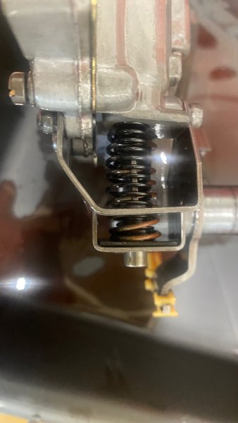

Did you set/adjust the Line pressure regulator as per instructions? (the one in the picture)

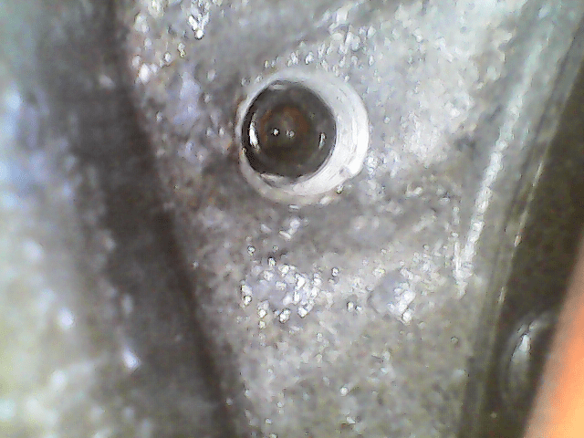

Hey all,
After getting things figured out with the valve body and such, I noted my trans leaks... A LOT when running. I used a remote flex camera and found a lot of fluid on the threads of this plug. I don't know what it does, and I don't recall taking it out or putting it back in when I rebuilt the trans so my guess is, it does not have any sealant on the threads. Tough part is, I don't think I can pull it out without dropping the trans. Also, the plug seems to be in deeper than that in the manual. Not sure how deep this thing is supposed to go in but maybe that's part of the problem.
What is this plug and can I simply remove it and seal it at the surface or does it have some sort of setting?
Trans drain plug I believe. Looks like there's was/is a problem before. Hope it isn't cross threaded. Not sure what is best way to seal without pulling trans.

View attachment 1516339 View attachment 1516344

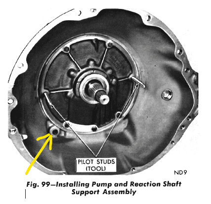

That plug is keeping the lever pin for the front band lever in place and must be removed when removing the lever.
That is an NPT thread plug and normally only requires some thread sealant when installed back.
Like Fran already said, looks like there has been some issue with it before as it looks strange.

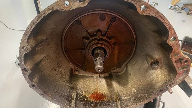

Below is my trans how i found it when i removed it.
Edit: By looking again at your picture, you might be looking at the shaft itself that is already coming out and the plug is missing. Not sure, not really clear.
Thanks Weitse... I am... sadly... reluctantly... angrily dropping the trans to get a better look at it. It is a serious pain in the A$$ because 1. I don't have a lift. 2. at 61, rolling around under a car is not a fun as it used to be and 3. I put in dual exhaust which makes it twice as hard to drop it. :BangHead:
I know that it's a pain, but i do not see how to get to that plug without pulling it.
Splitting transmission and engine and leaving it up there makes me fear to damage the converter lugs or shaft seal with even more drama's coming at you.
Keep that trouble and leak free transmission in mind as the goal while struggling under the car, positive thinking. :thumbsup:
Yeah, it looks like the lever pin plug is missing. It will leak here without it.
