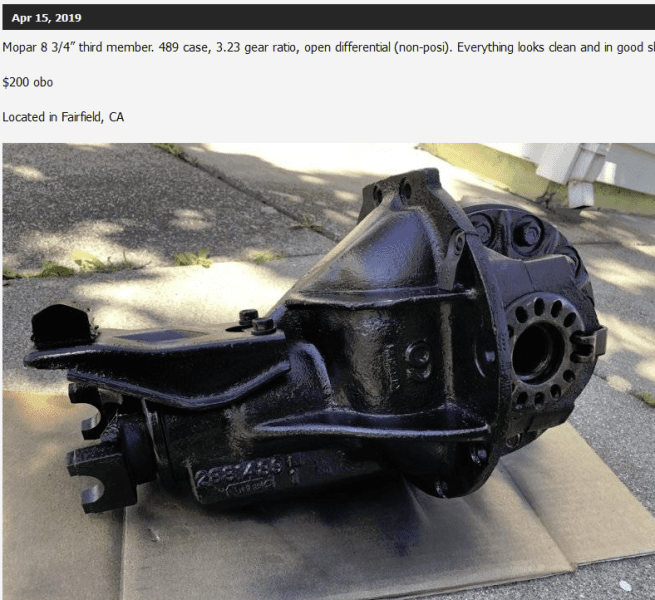

Just like this one from 4 years ago: SOLD - Mopar 489 case 3.23 ratio open

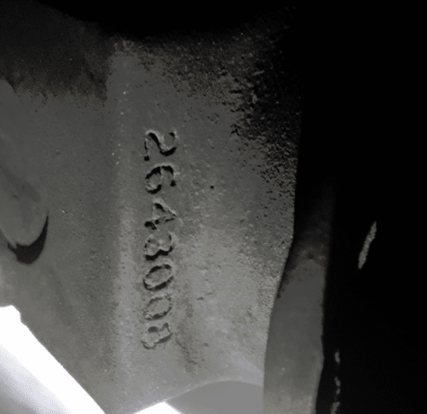

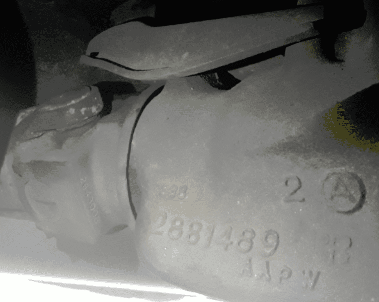

I checked my pumpkin and fortunately the seller was wrong. I have a 489 case and not a 741! So now I only have to new 3.23 gears. Correct?
Yes you can buy a gears, bearings and seals for that brand new. There are several vendors on line.
