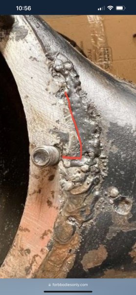

Dirty weldmaybe someone tried to mig weld it with gear oil still around. Look for cracks!
Took a bore scope to the inside today. There is a fine crack on the inside that follows this red line.
grind it out, clean it up, and put a solid weld on it, unless you're running slicks ......... if you were near by, I'd give you a housing
Obviously.....NO WELD PREP......grinding out the affected area to beyond the crack depth and length.....sort of a fundamental requirement......

5/32" stick.
IMO.....it looks as if it was "welded" by a blind man using the hunt and peck method using his feet.....heavy castings should have been preheated and if I were doing it, I'd use TIG, fof better penetration using pure Argon as the shield gas ....and ER Alloy ER 309L filler metal and is of similar composition as ER 309 except for the carbon content being lower than 0.03%. This lower carbon content reduces the possibility of intergranular carbide precipitation......I'm sure others will have their own opinions and methods.

Thanks.....one could use stick electrodes.....7018 LH....maybe 1/8" diameter...for better penetration ....horizontal position....but preheat first to 300°F....try and maintain interpass temps using a TEMPEL STICK and post weld cool down......but I'm sure others will have their own methods......
If the REST of the rear is strong enough for slicks, that little crack repair wouldn't bother me at all
Thanks. If I can find a good housing locally for a few bucks I’ll pick it up. Otherwise, I’ll get this one fixed proper.
Fixed proper should include setting up a jig tool to make sure it's not bent.
ANY time you weld on a housing, it moves but usually not enough to matter but it still a good idea to stick in an alignment bar to check them. Anyways, the majority of the work is going to be grinding off the mud dauber welds and redoing them. Then it'll take a bit of time setting up the bar and hopefully, no straightening will be needed.
