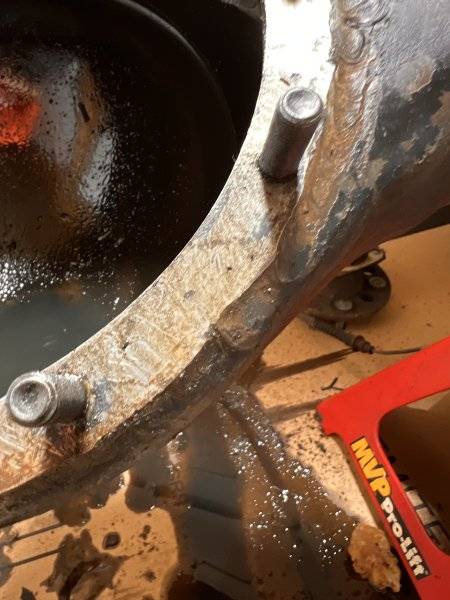

Just tore down and cleaned up my 70 B-body 8 3/4 rear. The housing has this terrible welding on it, yet the inside is as it should be. Looks like the flange washed out and it was built up with terrible weld. Factory???
That, as a factory weld, does not surprise me at all !!! Have you looked at K-member welds ?!?!
Dirty weldmaybe someone tried to mig weld it with gear oil still around. Look for cracks!
IMO.....it looks as if it was "welded" by a blind man using the hunt and peck method using his feet.....heavy castings should have been preheated and if I were doing it, I'd use TIG, fof better penetration using pure Argon as the shield gas ....and ER Alloy ER 309L filler metal and is of similar composition as ER 309 except for the carbon content being lower than 0.03%. This lower carbon content reduces the possibility of intergranular carbide precipitation......I'm sure others will have their own opinions and methods.

Thanks.....one could use stick electrodes.....7018 LH....maybe 1/8" diameter...for better penetration ....horizontal position....but preheat first to 300°F....try and maintain interpass temps using a TEMPEL STICK and post weld cool down......but I'm sure others will have their own methods......

probably factory - a new welder on his first day on the job perhaps.
I have to ask because I am curious. Did the factory use a stick welder back then? I don't know when wire welding started in production.
Definitely stick on the k frames and shock supports!!
Mig welders were invented in the late ‘40’s and I would think that the auto industry would have started using them most likely in the ‘50’s because mig welding is much more efficient than stick welding.

Lol. The pumpkin is a casting, what I call the housing is stamped,welded steel.
(But you knew that!)
As for the weld... the brown, nice-looking weld is factory, the rest is a poor weld, by a poor welder. Could have been mine, lol.

Isn't ER309 used for stainless alloys? I thought most post WWII axle housings that aren't stamped were cast steel. Unlike cast iron, we had no requirement for preheating with heavy cast steel items on the railroad. There wouldn't be any carbide precipitation on a normal steel casting as that is usually a problem with high chrome alloys.

Yes.....but it can be used with other materials.....
Application
ER309 is used for the welding of similar alloys in wrought or cast form. It is mostly used for welding dissimilar materials such as mild steel to stainless steel, as well as for a barrier layer in stainless overlays. For some applications, welding of straight chromium steels can be accomplished with this consumable.
