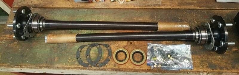

Dr.Diff aka Cass has flanged axels to replace the taypered axels. They have Green bearings on them so end play adjustments are not necessary. He suggest removing the thrust buttons if your suregrip still has them. The thrust block stays. Newer backing plates are needed along with matching pull off drums. (Read my post)

It's a easy swap to the newer flanged axels. Dr Diff has what you need except for the newer backing plates and drums. Who knows, he might even have a source for them. If you're sticking with a 10"x 2.5" drum you need the newer backing plate (1965 and newer) for the 10"x 2.5". The shoes and drums can be bought from NAPA or such parts houses.
Here's how it's done...

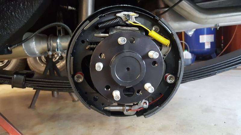

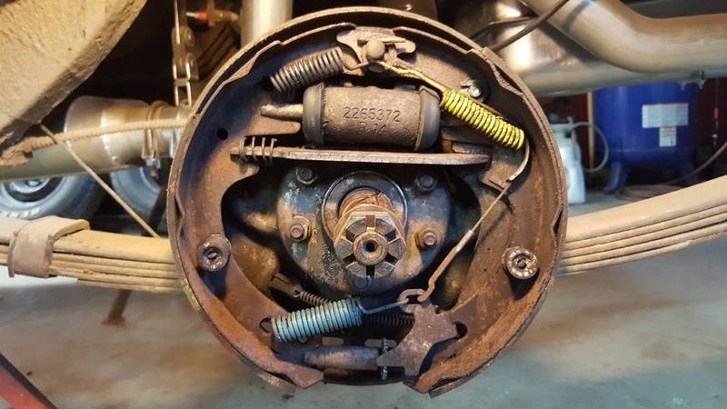

Impressed with the adjuster linkage ya have. Just this week I installed new adjuster kits as the adjusters fit like crap over the star wheel...and see this is a beeitch again doing some futzing to set the plate solid against the star. Can I ask where you obtained them or is it part of the assembly you have?
Mopar had at least three different types. Manual, Backup and hit the brakes (and for a lack of a better description) a Constant adjuster. They changed throughout the years so the newer the model you order parts for you'll get that year self adjuster. What years these changes were made I'm not exactly sure. I'm thinking the adjusters on mine were 1978 van. 10 x 2 1/2 drums
Good to know, thanks - had I known this about 4 days ago this is what I'd have ordered; but the kits didn't cost much so may order what you mentioned.

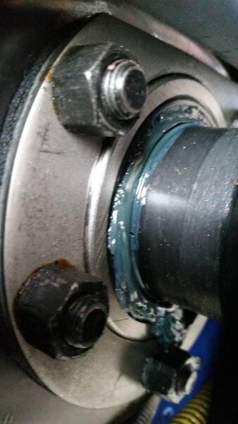

Here is what happened to my green bearings after just 200 miles. The grease all leaked out from the seals. I junked them and went back to original tapered bearings. Its not that difficult to get the endplay adjustment done with tapered bearings, actually its rather simple.

Here's an explanation from Cass (Dr. Diff) on what has taken place with the bearings in question.
Unfortunately, the original Mopar Green wheel bearing design has 2 problems.
First generation (RP-400) Green bearings, still sold by Mopar Performance and others, are problematic because the crimped-on flange will not allow the bearing to wiggle around inside a housing that is not perfectly straight (none are).
In addition, the design causes the axle to be inserted DEEPER into the housing than necessary. This results in pre-loading against the differential thrust block and early bearing failure.
Second generation (MO-400) snap-ring style Green bearings are forgiving because they can move around inside the housing and they do not preload the differential thrust block in a stock application.
Most guys who have problems with Green bearings are running the RP-400 first generation version or incorrectly made aftermarket axles or housings or poorly designed rear disc brake kits, all of which cause pre-loading and premature bearing failure.
