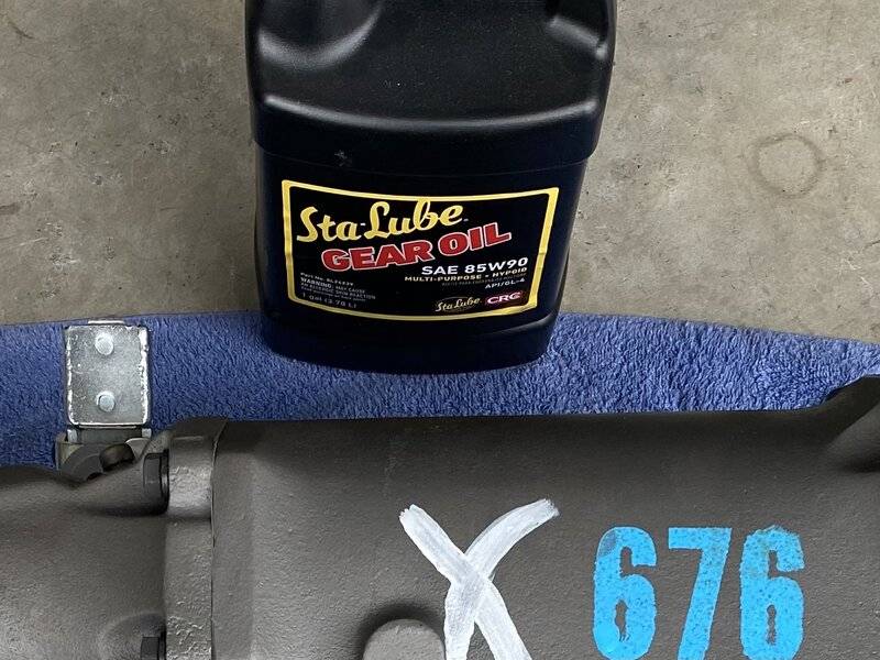

      • PLMHEMI
        PLMHEMI FBBO Gold Member FBBO Gold Member
        Messages:
        483
        Likes Received:
        544
        Joined:
        Oct 31, 2019
        Location:
        Ray Twp, Michigan
        Local Time:
        9:24 AM
        GL-4

          Sta-lube gl4 85-90 in mine as well. NAPA carries it here in Florida. Wayne has it at Brewers Performance as well.

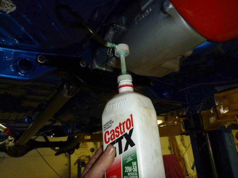

              • dadsbee
                dadsbee FBBO Gold Member FBBO Gold Member
                Messages:
                8,456
                Likes Received:
                19357
                Joined:
                Jan 29, 2018
                Location:
                Ontario, Canada
                Local Time:
                9:24 AM
                20W50
