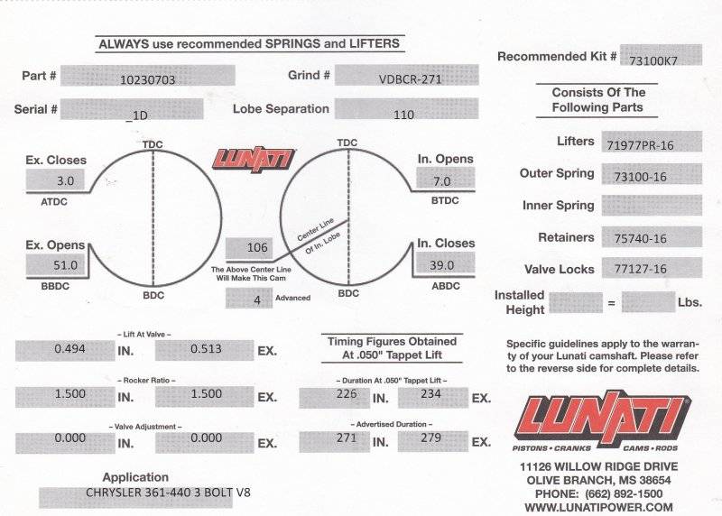

I run that same cam in my 383 with stock rockers, used springs it called for. , cast iron manifolds. I do run a TM6 intake and Eddy heads. It runs really good, but I have 4 spd and 3.91 gears. Here's a pic of the cam card.
And it idling
And it idling
And it idling
So, you set up this cam as per the card? What's your cylinder cranking psi?
Only the springs, spring height as per their specs in the catalog. Checked the cam and it was dead on going straight up, so didn't have to degree it. Don't know what cranking psi is, never checked.
