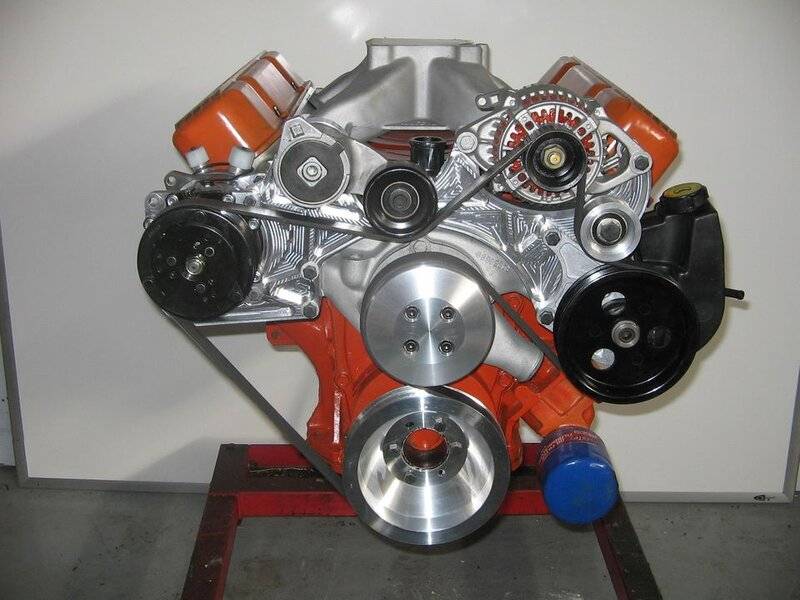

My CVF serpentine kit relocates the compressor low on the right side of the block.
Can I trouble you for a picture of your setup?
I went through their website and can't find any brackets that will mount the compressor down low
This is the CVF setup.

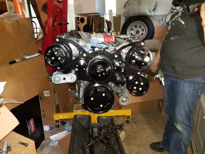

This is SD Concepts. Not sure if they are still around. I have one of their setups too.
I wanted the compressor on the left side, I'm using the Edelbrock XT type intake manifold and the Vintage Air kit comes out low on the left side.
That looks so busy to me.
