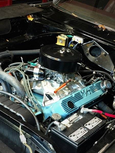

Ok open hood remove air cleaner, choke wide open.
Slight binding because I made a quick spacer to get the stock air cleaner base on a Carter competition 625 carb.
Freed up check that choke closes and moves freely.
Turn key, starts immediately.
