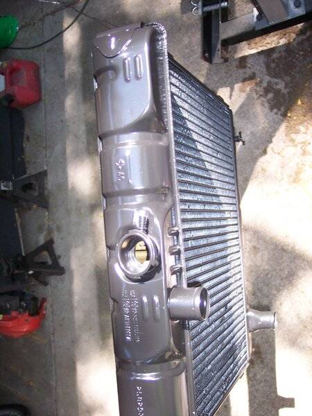

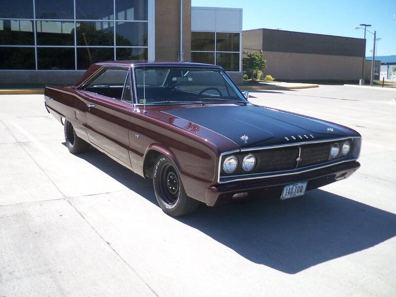

SEM hot rod black.https://www.nationaltoolwarehouse.c...tm_campaign=NTW+-+Smart+Shopping+-+BOOST+Item

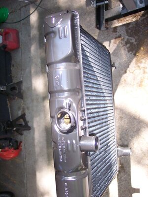

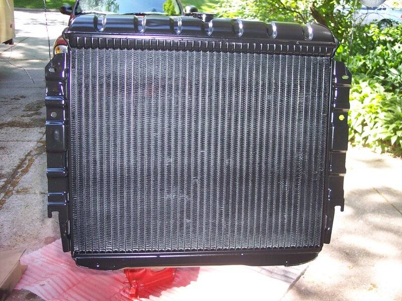

Believe it or not, your John Deere dealer has great flat, matte, and semi gloss paint.

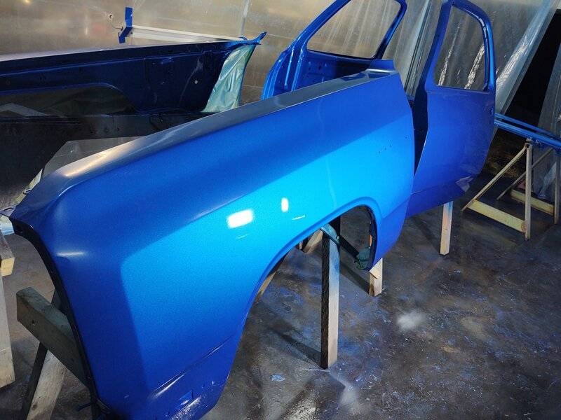

Here's what I'm going for but on an 83 D250.
 The blue is coming along nicely.
