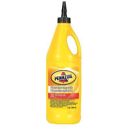

This is what I use. Synchromesh

I used Sta-Lub and had gear clash (could be slightly worn synchros). Switched to Penzoil Synchromesh (post #2) and it shifts like butter. Gets my vote. :thumbsup:

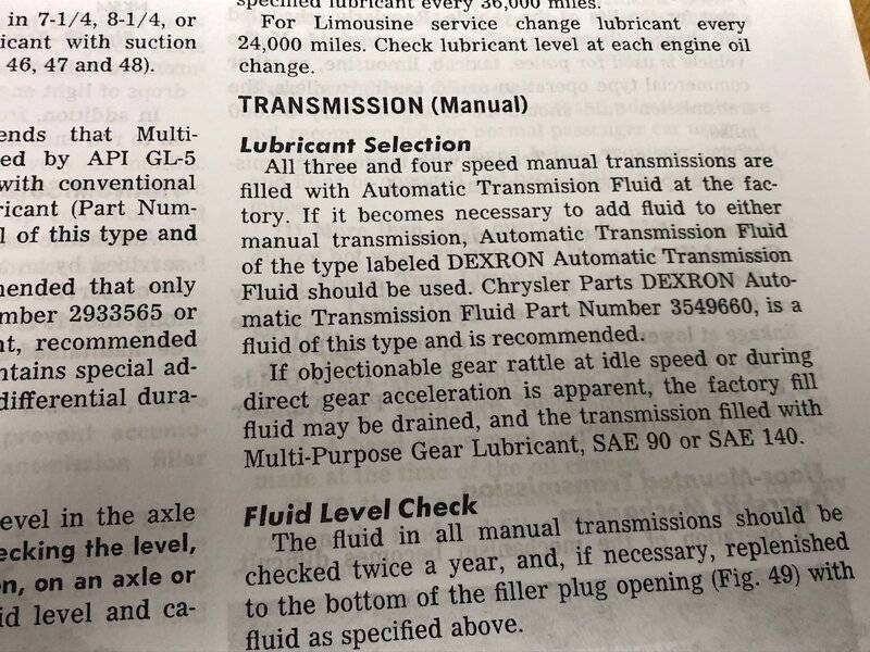

I am no Engineer and have not kept up with the every changing oils and lubricants available to us using new compounds and friction fighters as our resident Bob has. He keeps us regularly updated, thanks Bob. As the saying goes, "We ve come a long way Baby." But in reading my 73 Service Chassis Manual, under Lubrication and Maintenance, page 0-23, it states our 3 and 4 speed manual transmissions came from the factory with ATF fluid and gives the Chrysler part number for Dextron ATF fluid and is recommended. Goes on to say change to SAE 90 or SAE 140 if gear rattle becomes objectionable . Obviously the designers had no idea of the damage being done to the seals, bearing, gears 50 years ago by this recommendation, at least in 1973, and we now know why all our 4 speeds are worn out from that time. Time to move up with the new stuff.......

The 1970 Charger/Coronet factory service manual says to use ATF, and my 2008 manual 5 speed F150 uses ATF. Should I really be using gear oil?
