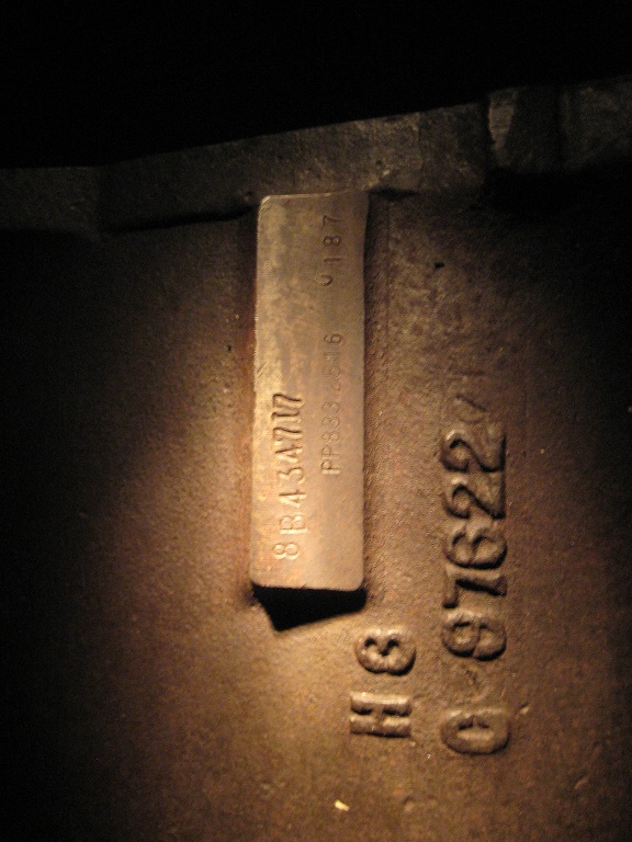

In 67, were they stamped like blocks with just a date code? No vin?
Casting numbers only!70 is when they stamped numbers on the pad,also no pad on earlier cases.
Not true. They were started in 68, but I do not think all 68 engine/trans did. I have a 68 cop 440 that does not have the pan rail vin pad. On another note, my 69 833 had the pad and was stamped with the partial vin. I thought I had a 68 833 also, and it had a pad and partial vin also.
From mine 1968 18 spline 833

67 should not even have the block. I know 66 doesn't and 68 being the first year for the VIN stamps, the blocks came sometime early 68 I think. Some good info here and pretty much confirms what I have observed over the years http://www.brewersperformance.com/history.htm
