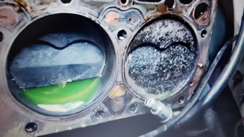

In Nicks Garage latest vid, his bud seemingly over revved the 440 in his 66 Charger and broke the motor. In trying to understand the sequence of events, I am thinking, 1. Over revving led to the springs inability to close the valve, allowing it to be smacked by the piston. 2. This led to the retainer coming unsecured and the valve dropped down and smacked the piston again. 3. This broke/bent the valve face and allowed it to be hammered into the port sideways. 4. This , then, beat the piston deck until it crumbled. But, in noticing the valve retainer was broke almost in half, how did that happen.....was it possible that it was the first to break from over revving and that set up the sequence of destruction. As you can tell, I am no racer and have only grenaded one motor in my life....mine came apart in the bottom end first. thanks.....

i think it is called coil bind when the rocker pushes the valve spring so far it binds on its self. if it is hyd, it very possible.

So, I replied to Nick's video wanting to know what kind of pistons were in that engine, deck height
question, and asked if those were in fact 906 heads. You can look at the comments and see what kind
of B.S. answer he gave me. Do these guys think they're Robert DeNiro or what? everything is so
top secret to them and they don't want to give anything away. Kinda pisses me off. So long Nick!

I know Nick for the past 40 years, and I can assure you that he is completely down to earth, I actually help him to get to all the questions but it ain't easy. Keep in mind he still has to work and put food on the table and business to run, Insensitive statements like yours are not called for. People are trying their best. Now that engine has TRW L2355f with Eagle H beam rods forged ctank, 509 cam and 452 heads ported about 10 years ago by Tom @ TKrace in Montreal, flowing 280 @ 500

Deck height is at Zero, Nick liked decking the blocks, and .039 head gasket, Although with these heads quench is non existant
So, I looked up the L2355F pistons which look like 440 Six Pak Pistons with double reliefs cut into them
and they look nothing like the pistons in the engine in the vid???
You're right My mistake, he used those L2355f on many builds in the past
I'll go there on Monday and verify
I just got off the phone with Nick and he told me they are MAHLE pistons on that build
O.K., Jeez, this is like pulling teeth! What number pistons??? PLEASE!
